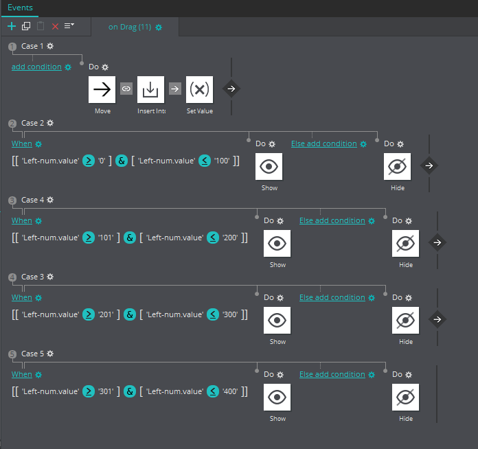

You can do this by creating a 'on drag stop' event with the outcome 'set value' for a text field, which will display the number.
Then create Create the condition 'When [slider circle] intersects [line]
I have attached a screenshot for clarity.
16053a645a099fcab8c70694399e9976
Note that this will only show certain values that you specify - the slider will not display every possible value. I.e. - when the slider intersects the first line, it will display 25, the second line, 50, and so on. In-between values (26, 27, 28, etc.) would be quite laborious to create as you would need to create events for every little space on the line.

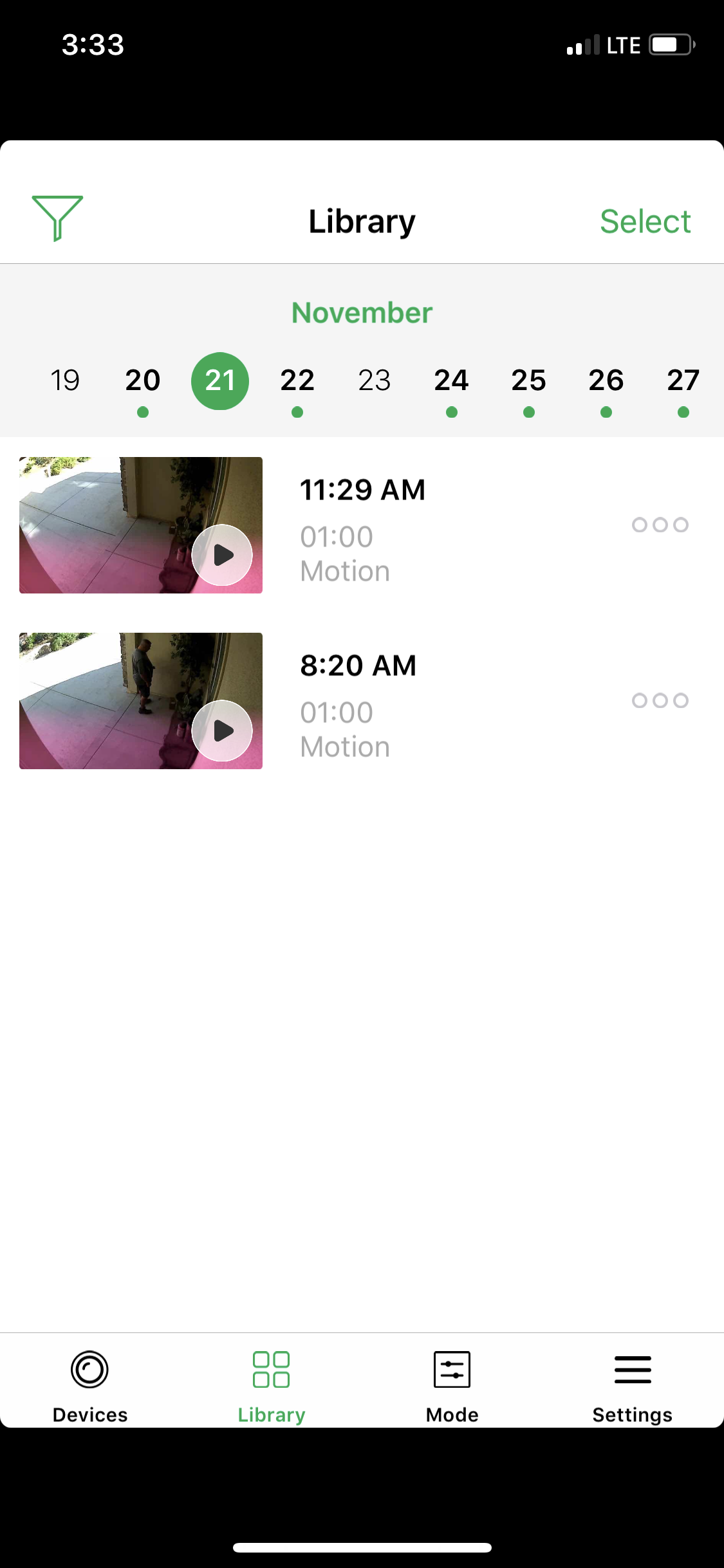

Please see attached file. I am trying to replicate this screen. When you swipe right or left on the number line you will be able to see the other days in November.
Also, is there a way to attach videos like the ones in the screen shot? I have video files on my computer.

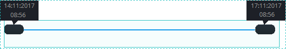

Hi Helly,
Check out the attached prototype. It uses a variable and a data master to store the date/time values. Let me know if you have any questions.
