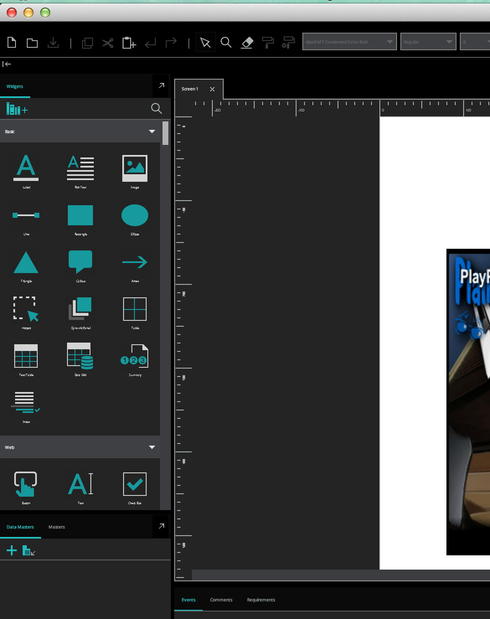

I just upgraded to a new MacBook Pro and for some reason the labels for widgets are tiny. I couldn't find anything in settings to adjust these and other text is normal size, as the attached images show.

I had just downloaded 6.1 for the first time today and everything worked fine from my MacBook display. I had then connected my external displays with no changes to the UI. It was only after I restarted the program with the external displays connected that I had a problem (was testing the high contrast UI option).
Tried re-installing, no luck. Removed and installed 6.0 and that seemed to fix the issue. Was able to work with external displays and no problems in the UI.
Still, I wanted to work in 6.1, so I updated from 6.0 and the issue returned. What I found was that starting the program without externals and then connecting the displays keeps the UI font sizes scaled properly, at least in my case.
FWIW I am running a MacBook Pro OS X 10.9.2 Retina, 15-inch and connecting via USB/HDMI to 2 24" displays.
Hope this helps :)

I installed JiM with my two monitors connected. cd54a4feb011e137e31b9a431b0eb758

Same issue with 6.3.1. I have really small fonts since I used Justinmind with my retina mac connected to an external monitor.
Deleted the app, deleted ~/justinmind, re-downloaded and installed 6.3.1 from scratch:
1c739564e4dcbb47c4e24e2bf2278cec
The issue still here.
(note that in logs.log i see this line:
DEBUG com.justinmind.prototyper - It is a non-retina screen
actually my screen IS a retina one (MacBook Pro Retina - 15 '' - late 2013)

Sure, here you are. The UI in general looks and works well. But fonts and some icons on menus and panels are not crisp and clear.
Files: jimp.jpg
It looks like the correct interface is loaded. Unfortunately it might be a little blurry due to the scaling.
Ok. When I set file params as shown on this screenshot, all fonts and icons become nice and clean but the overall drawing gets affected. When I move objects over the canvas it gives various funny glitches. Perhaps this is something you could fix further...
Files: jimp.jpg
