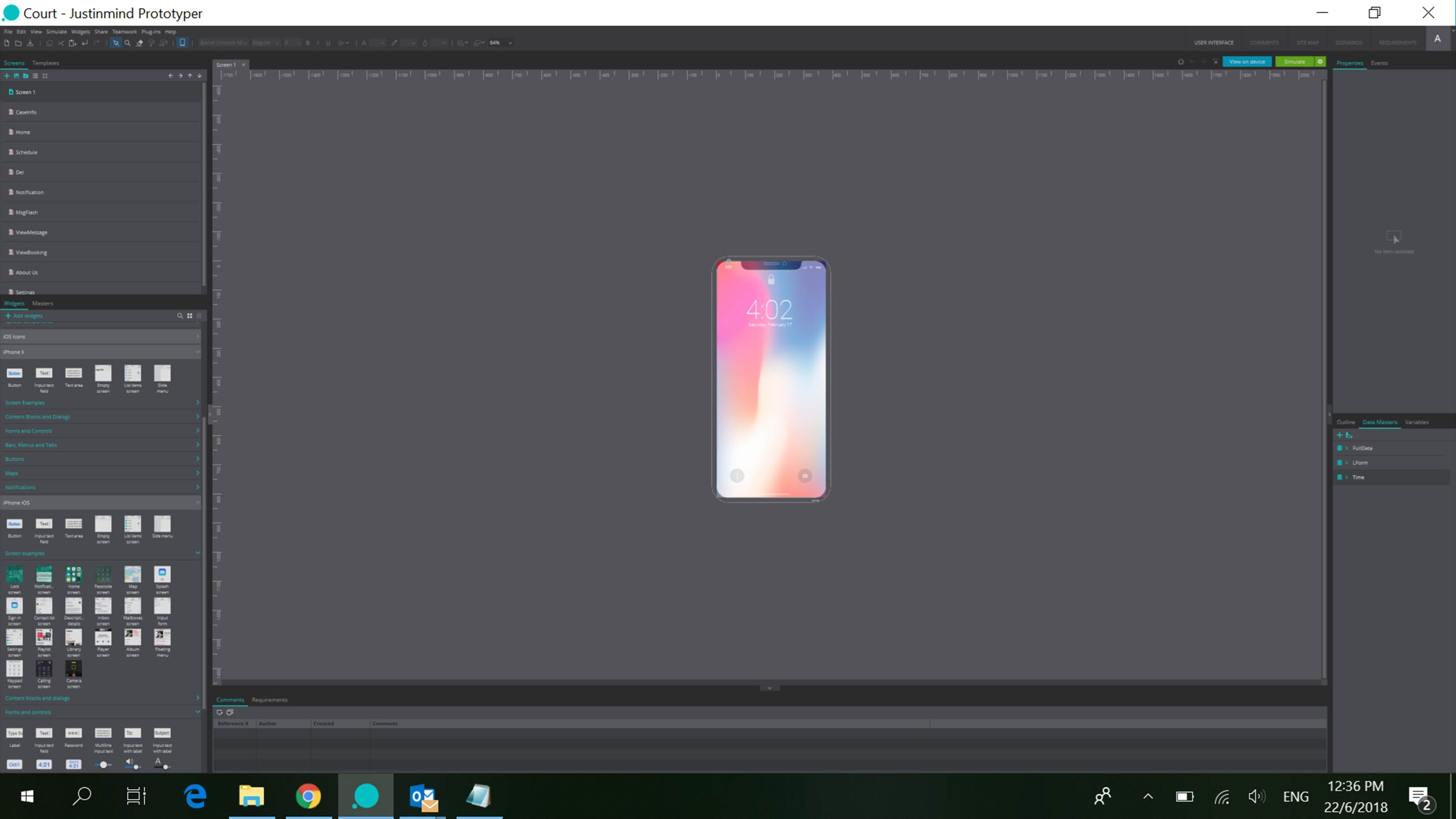

Hi. I've downloaded Justinmind Protyper and I'm using 4K monitor .The problem is that the size of ui is too small so i can't read charaters when i work . it looks like the picture below.
    Files:

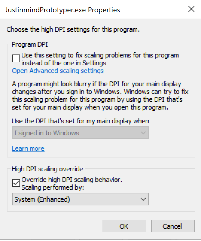

Look for and launch this file and it will fix the issue:
C:\Program Files (x86)\Justinmind\Justinmind Prototyper 8.2.1\JustinmindPrototyperHiDPI.exe
Your version number may be different, but the general file path should be the same.

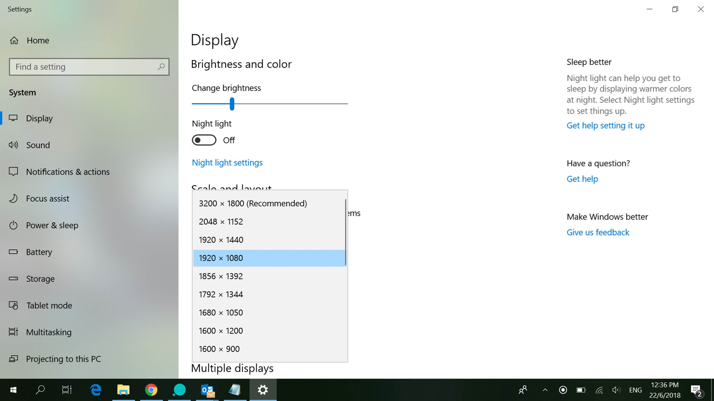

Hi Hassan,
1. Set your screen resolution to a lower setting. Currently 1920x1080 seems to be the most ‘normal’.
AND
2. From the screen resolution page, there is a setting for ‘Make text and other items larger or smaller’
a. Set the slider all the way to the left towards ‘Smaller’
b. Click Apply (this requires the user to log out and log back in)
Best regards.
