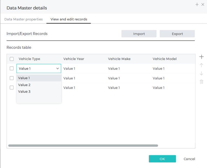

To use data from a data master in a category (dropdown) follow these steps:
1. In the data master fields, change one field to a category. Then, click on the circle next to the field name, and then click the 'gear' icon.
f37d3c522f182146e3a990e9499a61c0
2. In the dialog that opens, add some values.
0495f01a0ea4dd0538dbc1da479ca8cc
3. Select the dropdown and edit its values. You'll now be able to select a data master field, rather than the entire data master.
5deac5847e0472918e0a07026ecacd14
