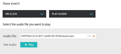

We're happy to inform you that Justinmind (version 7.9) now lets you embed .wav and .mp3 audio files in your prototypes.
This is a great new feature for adding rich, dynamic content to your interactive designs, and will give your prototypes an even more realistic edge.
Check it out for yourself here.
