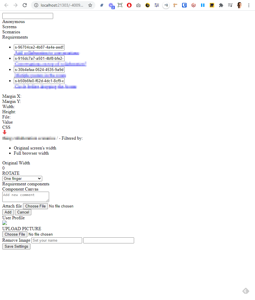

Now unexpectedly (in a customer session) Simulate prototype stopped working. It shows the page in a fragmented raw HTML way, not usable.
I've attached a screenshot and the JS console log.

Same issue. Here's the log file entry:
[2876856548222340219] [2020-11-23 09:53:03] INFO com.justinmind.generator - simulation: [installPath=/C:/Program Files/Justinmind/Justinmind 9.1.10/app/configuration/org.eclipse.osgi/10/0/.cp/, outputPath=C:/Users/Thomy/Justinmind/9.1.10/work/-2133172550342298117/, optimize=true]
[2876856548222340219] [2020-11-23 09:53:03] ERROR com.justinmind.generator - generation failed
[ACCESS_DENIED, PATH_ERROR] com.justinmind.generator.engine.GeneratorException: java.io.IOException: The filename, directory name, or volume label syntax is incorrect
