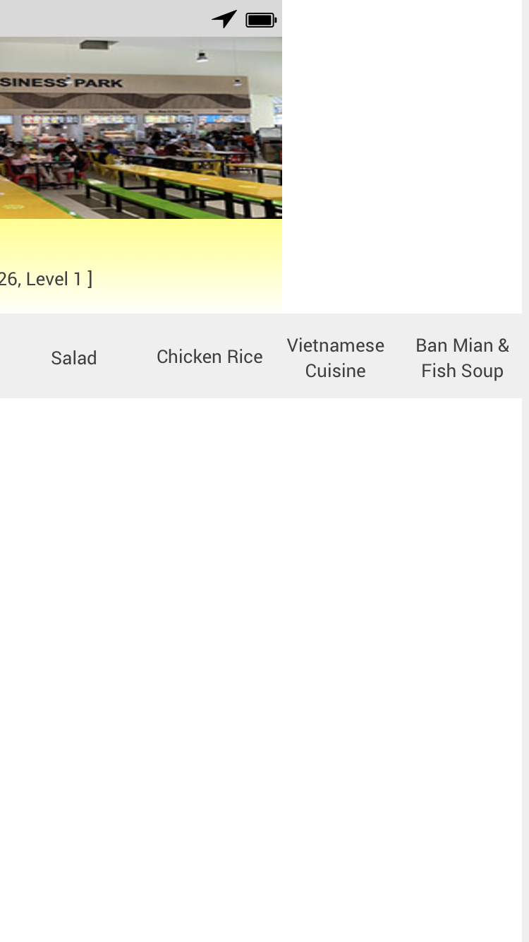

hi i cant seem to find that under the description at the properties tab. i am trying to remove the extra blank space at the side when using the simulation on the device and only the slide menu can scroll horizontally and not the screen. is it possible?
okay nevermind its been solved
Great! What was it?
instead of putting a hotspot in every single cell and adding an event into it to move the table, i found the container scrolling method :)
Nice!
