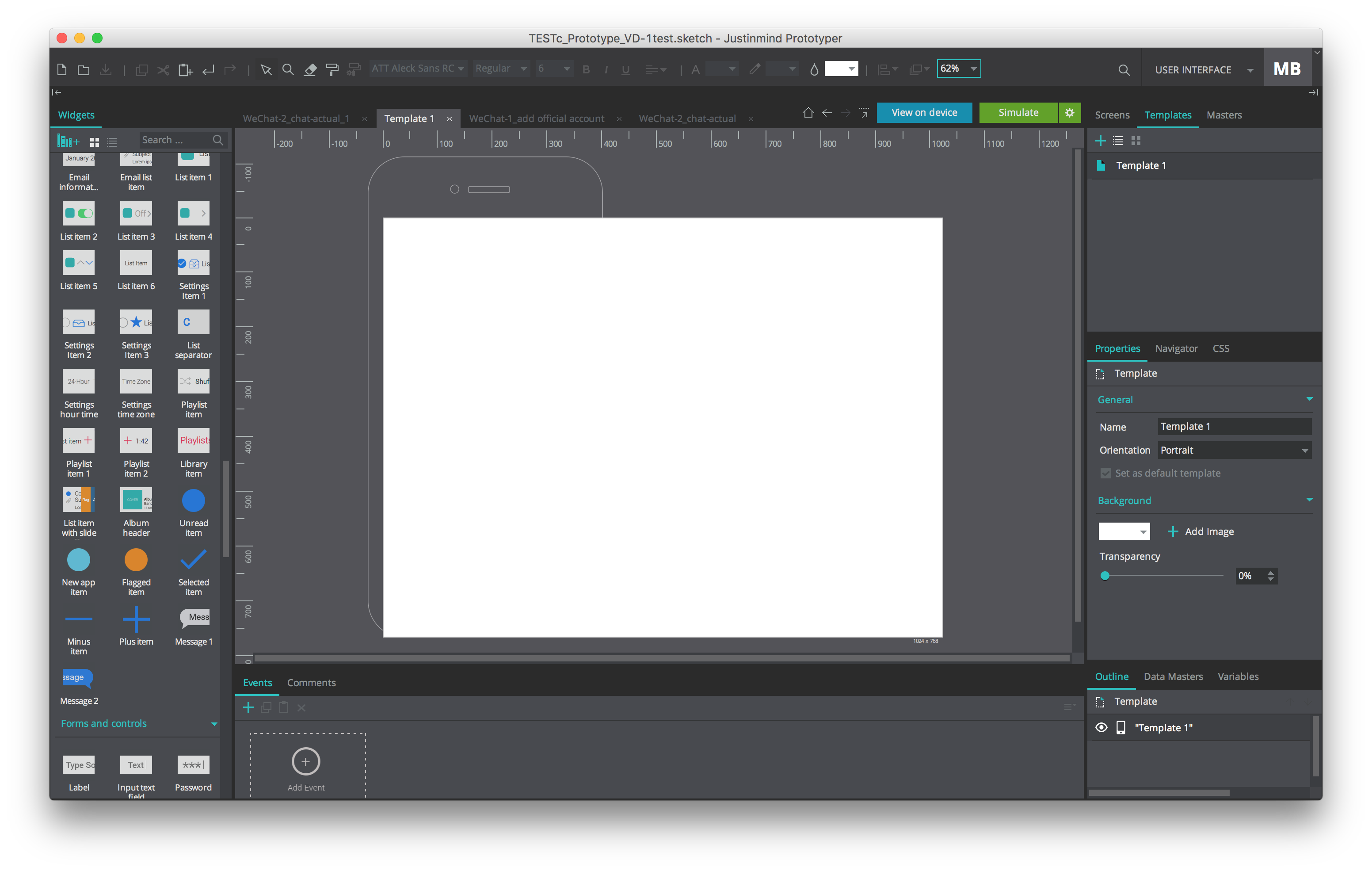

Hi, I have a similar (or same) problem as the original writer here, Carlos. I've made a JustinMind file that is set to iPhone portrait format (dimensions 375x667), but all the templates are 1024x768. And any new screen I make is also 1024x768 when what I need is 375x667.
Danielle above said that to solve this, " You can resize the screen by selecting the base page (icon that looks like a monitor) in the outline panel, then look to the properties panel. You'll then see an option to resize the width and height of the page..." BUT in my Properties panel, there actually are no options to resize the width and height of the page. Please see the attached screenshot.
Please tell me how I can resize this template - thanks.
(Note: the JustinMind file I'm working on was originally made by exporting from the Sketch app using their JustinMind plugin)
Hi Justin,
Apologies for the late reply! Looks like you've discovered a bug! The page definitely shouldn't be resized to that width. I'm forwarding this to our development team and we'll get on fixing this ASAP.

Hi Justin,
We have a new version of the Sketch plugin that fixes this issue. Download the new plugin here: https://github.com/vconesa/justinmind-sketch
