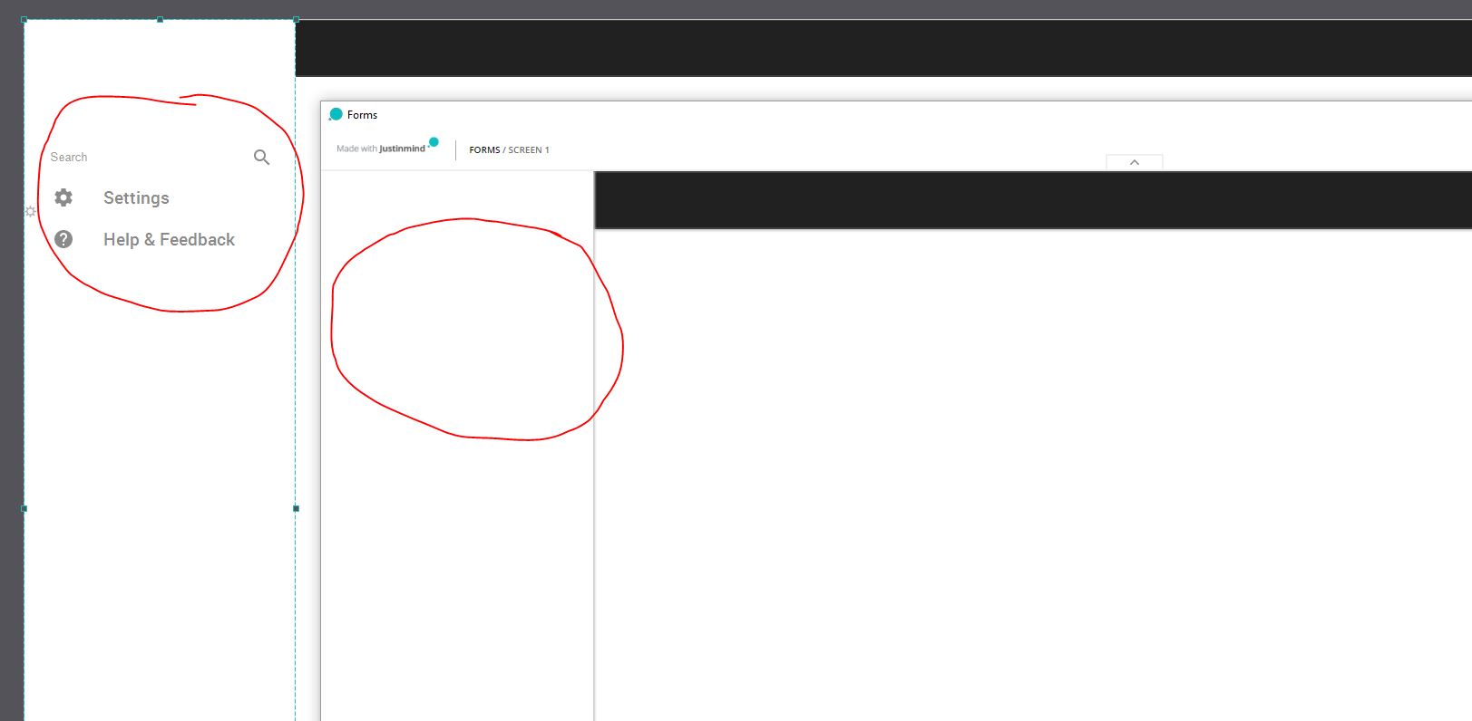

1) I have been clicking the Simulation button and opening the new window. It hasn't been updating with any of the changes I made on the prototype. (see attachment Capture1) I've tried saving and restarting with no luck.

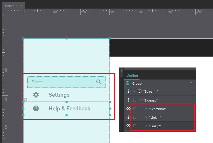

3) I just restarted the program. To be more specific about the snapping, some snapping does seem to work, but other times it doesn't. I have a long rectangle at the top of the canvas that is a navbar, and I have a group of elements making up a sidebar link in a sidebar rectangle. The sidebar link group snaps to the navbar, but it doesn't snap to another sidenav link group. Maybe because they're both groups? Attachment Capture2 shows the items that are not snapping to each other. I'm specifically trying to stack them vertically, snapped to each other, and it isn't working. I was also having trouble vertically aligning the icon within the rectangle that makes up the sidenav link.

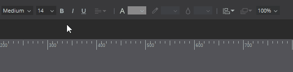

4) While hovering around to answer this question, I realized my mistake. Justinmind does have hover labels on tools. It looks like the hover labels are disabled on tools that are disabled. That's what was throwing me off. I actually think this should still be fixed. If an option is disabled, I want to know what it is so I can figure out why it's disabled. I still don't actually know what some of these disabled tools are. Also, I noticed that some of the coloring tools have a hover to show what the color is, which is really nice, but there isn't a label on the icon before the color, so it isn't always clear what the color is for. What is pencil color vs teardrop color? They're disabled at the moment, so I'm not sure what element I might use to test them and see what they are. See attachment Capture3.gif

1) That's very odd - could you attach the prototype you're working on here so we can take a look? You can attach it in .rar format, or upload it to a file sharing service like Dropbox and link to it here. If it's a private prototype, you can send it to us.
2) Vertical snapping is working quite well for me, even with groups. Hopefully I will be able to see what you mean in the prototype you attach.
3) Thanks for clarifying. I'll let our development team know that this can be confusing. The pencil color is the border color, while the teardrop is the background color.

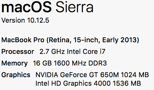

To add to this, the application did look ideal based on everything I had seen and read prior to installing but after using it I find the system performance to be slow. I've attached my system specs as an image file. I don't suspect that to be the issue. Specifically moving items around the interface is slow and, like earlier, the snapping system is inconsistent. Also, the properties panel is painfully slow as well, i.e. clicking on the up and down arrows to adjust values.

You can try increasing the amount of memory Justinmind is able to use, which will better performance. To do this, command-click on the Justinmind application in your applications menu and select 'show package contents'. Then, open the folder 'contents'. There, open the file Justinmind.ini and change the parameter Xmx from 1024m to 2000m.
Let me know how that works for you.
