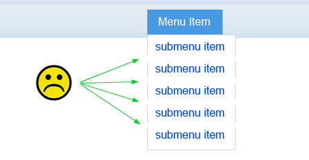

How can I style a sub-menu item to have more padding between the sub-menu items? (see example attached) 54720f4745ebac8302c83486f650f9f7

I tried that, but the top and bottom borders break the left and right borders.
is there any way around that? a2f6b8b2904afdbda42783f2e7cd59b9

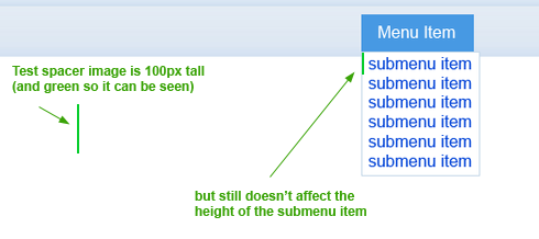

Can you be more specific about how to add an icon to the submenu items?
I know how to create the image, but the only way I see to add an image to the submenu items is in the "Background" section of the Properties panel. And background images don't affect the height. e7216612c2afca263cf14ff8b1460d21
