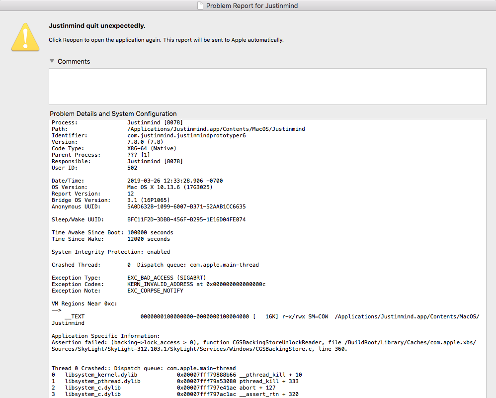

Software: JIM version 7.7.0 | OS: macOS version 10.13.6 (17G3025) The problem below persisted after uninstall and reinstall JIM 7.7.0 Steps to reproduce the error: 1. Install JIM 2. Input username and password at Login window 3. Click "SIGN IN" 4. [b]JIM closed/crashed without displaying any error[/b] 5. MacOS "Problem Report for Justinmind" pops up with this information: Justinmind quit unexpectedly. Process: Justinmind [17694] Path: /Applications/Justinmind.app/Contents/MacOS/Justinmind Identifier: com.justinmind.justinmindprototyper6 Version: 7.7.0 (7.7) Code Type: X86-64 (Native) Parent Process: ??? [1] Responsible: Justinmind [17694] User ID: 502 Date/Time: 2019-01-29 13:57:19.929 -0800 OS Version: Mac OS X 10.13.6 (17G3025) Report Version: 12 Bridge OS Version: 3.1 (16P1065) Anonymous UUID: 5A0D632B-1099-6007-B371-52AAB1CC6635 Sleep/Wake UUID: 2723CE04-17CB-4888-8D96-0FD35D535E1A Time Awake Since Boot: 370000 seconds Time Since Wake: 18000 seconds System Integrity Protection: enabled Crashed Thread: 0 Dispatch queue: com.apple.main-thread Exception Type: EXC_BAD_ACCESS (SIGABRT) Exception Codes: KERN_INVALID_ADDRESS at 0x000000000000000c Exception Note: EXC_CORPSE_NOTIFY VM Regions Near 0xc: --> __TEXT 0000000100000000-0000000100004000 [ 16K] r-x/rwx SM=COW @D [/Applications/Justinmind.app/Contents/MacOS/Justinmind] Application Specific Information: Assertion failed: (backing->lock_access > 0), function CGSBackingStoreUnlockReader, file /BuildRoot/Library/Caches/com.apple.xbs/Sources/SkyLight/SkyLight-312.103.1/SkyLight/Services/Windows/CGSBackingStore.c, line 360. Thread 0 Crashed:: Dispatch queue: com.apple.main-thread 0 libsystem_kernel.dylib 0x00007fff58cecb66 __pthread_kill + 10 1 libsystem_pthread.dylib 0x00007fff58eb7080 pthread_kill + 333 2 libsystem_c.dylib 0x00007fff58c481ae abort + 127 3 libsystem_c.dylib 0x00007fff58c101ac __assert_rtn + 320 4 com.apple.SkyLight 0x00007fff529e20ee SLSUnlockWindowBackingStore + 124 5 com.apple.CoreGraphics 0x00007fff310d3f09 CGSImageDataLockDevice + 482 6 com.apple.CoreGraphics 0x00007fff31184e9c ripc_DrawWindowContents + 1120 7 com.apple.CoreGraphics 0x00007fff31109afd CGContextDelegateDrawWindowContents + 59 8 com.apple.SkyLight 0x00007fff52b28668 SLContextCopyWindowContentsToRect + 178 9 libswt-pi-cocoa-3833.jnilib 0x000000011e3e020b Java_org_eclipse_swt_internal_cocoa_OS_CGContextCopyWindowContentsToRect + 345 10 ??? 0x00000001083eb694 0 + 4433294996 11 ??? 0x00000001083dd98d 0 + 4433238413 12 ??? 0x00000001083dd98d 0 + 4433238413 13 ??? 0x00000001083dd710 0 + 4433237776 14 ??? 0x00000001083dd98d 0 + 4433238413 15 ??? 0x00000001083dd98d 0 + 4433238413 16 ??? 0x00000001083dd98d 0 + 4433238413 17 ??? 0x00000001083dd98d 0 + 4433238413 18 ??? 0x00000001083dd9d2 0 + 4433238482 19 ??? 0x00000001083dd98d 0 + 4433238413 20 ??? 0x00000001083dd98d 0 + 4433238413 21 ??? 0x0000000108e3977c 0 + 4444100476 22 ??? 0x00000001083dd98d 0 + 4433238413 23 ??? 0x00000001083dd3d0 0 + 4433236944 24 ??? 0x00000001083dd3d0 0 + 4433236944 25 ??? 0x00000001083dd3d0 0 + 4433236944 26 ??? 0x00000001083dd3d0 0 + 4433236944 27 ??? 0x00000001083d64e7 0 + 4433208551 28 libjvm.dylib 0x0000000106f09516 JavaCalls::call_helper(JavaValue*, methodHandle*, JavaCallArguments*, Thread*) + 1710 29 libjvm.dylib 0x00000001070d80be Reflection::invoke(instanceKlassHandle, methodHandle, Handle, bool, objArrayHandle, BasicType, objArrayHandle, bool, Thread*) + 3576 30 libjvm.dylib 0x00000001070d85d8 Reflection::invoke_method(oopDesc*, Handle, objArrayHandle, Thread*) + 364 31 libjvm.dylib 0x0000000106f57b98 JVM_InvokeMethod + 358 32 ??? 0x00000001083eb694 0 + 4433294996 33 ??? 0x00000001083dd710 0 + 4433237776 34 ??? 0x00000001083dd710 0 + 4433237776 35 ??? 0x00000001083dd7e4 0 + 4433237988 36 ??? 0x00000001083dd710 0 + 4433237776 37 ??? 0x00000001083dd710 0 + 4433237776 38 ??? 0x00000001083dd7e4 0 + 4433237988 39 ??? 0x00000001083dd710 0 + 4433237776 40 ??? 0x00000001083dd710 0 + 4433237776 41 ??? 0x00000001083dd710 0 + 4433237776 42 ??? 0x00000001083d64e7 0 + 4433208551 43 libjvm.dylib 0x0000000106f09516 JavaCalls::call_helper(JavaValue*, methodHandle*, JavaCallArguments*, Thread*) + 1710 44 libjvm.dylib 0x00000001070d80be Reflection::invoke(instanceKlassHandle, methodHandle, Handle, bool, objArrayHandle, BasicType, objArrayHandle, bool, Thread*) + 3576 45 libjvm.dylib 0x00000001070d85d8 Reflection::invoke_method(oopDesc*, Handle, objArrayHandle, Thread*) + 364 46 libjvm.dylib 0x0000000106f57b98 JVM_InvokeMethod + 358 47 ??? 0x00000001083eb694 0 + 4433294996 48 ??? 0x00000001083dd710 0 + 4433237776 49 ??? 0x00000001083dd710 0 + 4433237776 50 ??? 0x00000001083dd7e4 0 + 4433237988 51 ??? 0x00000001083dd710 0 + 4433237776 52 ??? 0x00000001083dd98d 0 + 4433238413 53 ??? 0x00000001083dd98d 0 + 4433238413 54 ??? 0x00000001083d64e7 0 + 4433208551 55 libjvm.dylib 0x0000000106f09516 JavaCalls::call_helper(JavaValue*, methodHandle*, JavaCallArguments*, Thread*) + 1710 56 libjvm.dylib 0x0000000106f3e93b jni_invoke_nonstatic(JNIEnv_*, JavaValue*, _jobject*, JNICallType, _jmethodID*, JNI_ArgumentPusher*, Thread*) + 773 57 libjvm.dylib 0x0000000106f303ed jni_CallIntMethod + 363 58 eclipse_1607.so 0x00000001000c0ff2 startJavaJNI + 2138 59 eclipse_1607.so 0x00000001000bfc25 startJavaVM + 9 60 eclipse_1607.so 0x00000001000bdf2d _run + 4611 61 eclipse_1607.so 0x00000001000be916 run + 434 62 com.justinmind.justinmindprototyper60x00000001000019ab original_main + 1809 63 com.justinmind.justinmindprototyper60x0000000100001f7d main + 1230 64 com.justinmind.justinmindprototyper60x0000000100001158 start + 52 Thread 1: 0 libsystem_kernel.dylib 0x00007fff58ced28a __workq_kernreturn + 10 1 libsystem_pthread.dylib 0x00007fff58eb420e _pthread_wqthread + 1552 2 libsystem_pthread.dylib 0x00007fff58eb3be9 start_wqthread + 13 Thread 2: 0 libsystem_kernel.dylib 0x00007fff58ceca16 __psynch_cvwait + 10 1 libsystem_pthread.dylib 0x00007fff58eb5589 _pthread_cond_wait + 732 2 libjvm.dylib 0x000000010708e7bc os::PlatformEvent::park() + 192 3 libjvm.dylib 0x000000010706dd64 ParkCommon(ParkEvent*, long) + 42 4 libjvm.dylib 0x000000010706e63c Monitor::IWait(Thread*, long) + 168 5 libjvm.dylib 0x000000010706e8a5 Monitor::wait(bool, long, bool) + 375 6 libjvm.dylib 0x0000000106e95fea GCTaskManager::get_task(unsigned int) + 56 7 libjvm.dylib 0x0000000106e96ef9 GCTaskThread::run() + 349 8 libjvm.dylib 0x000000010709287e java_start(Thread*) + 246 9 libsystem_pthread.dylib 0x00007fff58eb4661 _pthread_body + 340 10 libsystem_pthread.dylib 0x00007fff58eb450d _pthread_start + 377 11 libsystem_pthread.dylib 0x00007fff58eb3bf9 thread_start + 13 Thread 3: 0 libsystem_kernel.dylib 0x00007fff58ceca16 __psynch_cvwait + 10 1 libsystem_pthread.dylib 0x00007fff58eb5589 _pthread_cond_wait + 732 2 libjvm.dylib 0x000000010708e7bc os::PlatformEvent::park() + 192 3 libjvm.dylib 0x000000010706dd64 ParkCommon(ParkEvent*, long) + 42 4 libjvm.dylib 0x000000010706e63c Monitor::IWait(Thread*, long) + 168 5 libjvm.dylib 0x000000010706e8a5 Monitor::wait(bool, long, bool) + 375 6 libjvm.dylib 0x0000000106e95fea GCTaskManager::get_task(unsigned int) + 56 7 libjvm.dylib 0x0000000106e96ef9 GCTaskThread::run() + 349 8 libjvm.dylib 0x000000010709287e java_start(Thread*) + 246 9 libsystem_pthread.dylib 0x00007fff58eb4661 _pthread_body + 340 10 libsystem_pthread.dylib 0x00007fff58eb450d _pthread_start + 377 11 libsystem_pthread.dylib 0x00007fff58eb3bf9 thread_start + 13 Thread 4: 0 libsystem_kernel.dylib 0x00007fff58ceca16 __psynch_cvwait + 10 1 libsystem_pthread.dylib 0x00007fff58eb5589 _pthread_cond_wait + 732 2 libjvm.dylib 0x000000010708e7bc os::PlatformEvent::park() + 192 3 libjvm.dylib 0x000000010706dd64 ParkCommon(ParkEvent*, long) + 42 4 libjvm.dylib 0x000000010706e63c Monitor::IWait(Thread*, long) + 168 5 libjvm.dylib 0x000000010706e8a5 Monitor::wait(bool, long, bool) + 375 6 libjvm.dylib 0x0000000106e95fea GCTaskManager::get_task(unsigned int) + 56 7 libjvm.dylib 0x0000000106e96ef9 GCTaskThread::run() + 349 8 libjvm.dylib 0x000000010709287e java_start(Thread*) + 246 9 libsystem_pthread.dylib 0x00007fff58eb4661 _pthread_body + 340 10 libsystem_pthread.dylib 0x00007fff58eb450d _pthread_start + 377 11 libsystem_pthread.dylib 0x00007fff58eb3bf9 thread_start + 13 Thread 5: 0 libsystem_kernel.dylib 0x00007fff58ceca16 __psynch_cvwait + 10 1 libsystem_pthread.dylib 0x00007fff58eb5589 _pthread_cond_wait + 732 2 libjvm.dylib 0x000000010708e7bc os::PlatformEvent::park() + 192 3 libjvm.dylib 0x000000010706dd64 ParkCommon(ParkEvent*, long) + 42 4 libjvm.dylib 0x000000010706e63c Monitor::IWait(Thread*, long) + 168 5 libjvm.dylib 0x000000010706e8a5 Monitor::wait(bool, long, bool) + 375 6 libjvm.dylib 0x0000000106e95fea GCTaskManager::get_task(unsigned int) + 56 7 libjvm.dylib 0x0000000106e96ef9 GCTaskThread::run() + 349 8 libjvm.dylib 0x000000010709287e java_start(Thread*) + 246 9 libsystem_pthread.dylib 0x00007fff58eb4661 _pthread_body + 340 10 libsystem_pthread.dylib 0x00007fff58eb450d _pthread_start + 377 11 libsystem_pthread.dylib 0x00007fff58eb3bf9 thread_start + 13 Thread 6: 0 libsystem_kernel.dylib 0x00007fff58ceca16 __psynch_cvwait + 10 1 libsystem_pthread.dylib 0x00007fff58eb5589 _pthread_cond_wait + 732 2 libjvm.dylib 0x000000010708e7bc os::PlatformEvent::park() + 192 3 libjvm.dylib 0x000000010706dd64 ParkCommon(ParkEvent*, long) + 42 4 libjvm.dylib 0x000000010706e63c Monitor::IWait(Thread*, long) + 168 5 libjvm.dylib 0x000000010706e8a5 Monitor::wait(bool, long, bool) + 375 6 libjvm.dylib 0x0000000106e95fea GCTaskManager::get_task(unsigned int) + 56 7 libjvm.dylib 0x0000000106e96ef9 GCTaskThread::run() + 349 8 libjvm.dylib 0x000000010709287e java_start(Thread*) + 246 9 libsystem_pthread.dylib 0x00007fff58eb4661 _pthread_body + 340 10 libsystem_pthread.dylib 0x00007fff58eb450d _pthread_start + 377 11 libsystem_pthread.dylib 0x00007fff58eb3bf9 thread_start + 13 Thread 7: 0 libsystem_kernel.dylib 0x00007fff58ceca16 __psynch_cvwait + 10 1 libsystem_pthread.dylib 0x00007fff58eb5589 _pthread_cond_wait + 732 2 libjvm.dylib 0x000000010708e7bc os::PlatformEvent::park() + 192 3 libjvm.dylib 0x000000010706dd64 ParkCommon(ParkEvent*, long) + 42 4 libjvm.dylib 0x000000010706e63c Monitor::IWait(Thread*, long) + 168 5 libjvm.dylib 0x000000010706e8a5 Monitor::wait(bool, long, bool) + 375 6 libjvm.dylib 0x0000000106e95fea GCTaskManager::get_task(unsigned int) + 56 7 libjvm.dylib 0x0000000106e96ef9 GCTaskThread::run() + 349 8 libjvm.dylib 0x000000010709287e java_start(Thread*) + 246 9 libsystem_pthread.dylib 0x00007fff58eb4661 _pthread_body + 340 10 libsystem_pthread.dylib 0x00007fff58eb450d _pthread_start + 377 11 libsystem_pthread.dylib 0x00007fff58eb3bf9 thread_start + 13 Thread 8: 0 libsystem_kernel.dylib 0x00007fff58ceca16 __psynch_cvwait + 10 1 libsystem_pthread.dylib 0x00007fff58eb5589 _pthread_cond_wait + 732 2 libjvm.dylib 0x000000010708e7bc os::PlatformEvent::park() + 192 3 libjvm.dylib 0x000000010706dd64 ParkCommon(ParkEvent*, long) + 42 4 libjvm.dylib 0x000000010706e63c Monitor::IWait(Thread*, long) + 168 5 libjvm.dylib 0x000000010706e8a5 Monitor::wait(bool, long, bool) + 375 6 libjvm.dylib 0x0000000106e95fea GCTaskManager::get_task(unsigned int) + 56 7 libjvm.dylib 0x0000000106e96ef9 GCTaskThread::run() + 349 8 libjvm.dylib 0x000000010709287e java_start(Thread*) + 246 9 libsystem_pthread.dylib 0x00007fff58eb4661 _pthread_body + 340 10 libsystem_pthread.dylib 0x00007fff58eb450d _pthread_start + 377 11 libsystem_pthread.dylib 0x00007fff58eb3bf9 thread_start + 13 Thread 9: 0 libsystem_kernel.dylib 0x00007fff58ceca16 __psynch_cvwait + 10 1 libsystem_pthread.dylib 0x00007fff58eb5589 _pthread_cond_wait + 732 2 libjvm.dylib 0x000000010708e7bc os::PlatformEvent::park() + 192 3 libjvm.dylib 0x000000010706dd64 ParkCommon(ParkEvent*, long) + 42 4 libjvm.dylib 0x000000010706e63c Monitor::IWait(Thread*, long) + 168 5 libjvm.dylib 0x000000010706e8a5 Monitor::wait(bool, long, bool) + 375 6 libjvm.dylib 0x0000000106e95fea GCTaskManager::get_task(unsigned int) + 56 7 libjvm.dylib 0x0000000106e96ef9 GCTaskThread::run() + 349 8 libjvm.dylib 0x000000010709287e java_start(Thread*) + 246 9 libsystem_pthread.dylib 0x00007fff58eb4661 _pthread_body + 340 10 libsystem_pthread.dylib 0x00007fff58eb450d _pthread_start + 377 11 libsystem_pthread.dylib 0x00007fff58eb3bf9 thread_start + 13 Thread 10: 0 libsystem_kernel.dylib 0x00007fff58ceca16 __psynch_cvwait + 10 1 libsystem_pthread.dylib 0x00007fff58eb5589 _pthread_cond_wait + 732 2 libjvm.dylib 0x000000010708f6a6 os::PlatformEvent::park(long) + 404 3 libjvm.dylib 0x000000010706e63c Monitor::IWait(Thread*, long) + 168 4 libjvm.dylib 0x000000010706e8a5 Monitor::wait(bool, long, bool) + 375 5 libjvm.dylib 0x00000001071b4574 VMThread::loop() + 444 6 libjvm.dylib 0x00000001071b3fff VMThread::run() + 121 7 libjvm.dylib 0x000000010709287e java_start(Thread*) + 246 8 libsystem_pthread.dylib 0x00007fff58eb4661 _pthread_body + 340 9 libsystem_pthread.dylib 0x00007fff58eb450d _pthread_start + 377 10 libsystem_pthread.dylib 0x00007fff58eb3bf9 thread_start + 13 Thread 11:: Java: Reference Handler 0 libsystem_kernel.dylib 0x00007fff58ceca16 __psynch_cvwait + 10 1 libsystem_pthread.dylib 0x00007fff58eb5589 _pthread_cond_wait + 732 2 libjvm.dylib 0x000000010708e7bc os::PlatformEvent::park() + 192 3 libjvm.dylib 0x0000000107087122 ObjectMonitor::wait(long, bool, Thread*) + 748 4 libjvm.dylib 0x0000000107139e98 ObjectSynchronizer::wait(Handle, long, Thread*) + 202 5 libjvm.dylib 0x0000000106f60f2e JVM_MonitorWait + 156 6 ??? 0x0000000108a46728 0 + 4439959336 7 ??? 0x00000001083dd98d 0 + 4433238413 8 ??? 0x00000001083dd98d 0 + 4433238413 9 ??? 0x00000001083d64e7 0 + 4433208551 10 libjvm.dylib 0x0000000106f09516 JavaCalls::call_helper(JavaValue*, methodHandle*, JavaCallArguments*, Thread*) + 1710 11 libjvm.dylib 0x0000000106f09ca4 JavaCalls::call_virtual(JavaValue*, KlassHandle, Symbol*, Symbol*, JavaCallArguments*, Thread*) + 356 12 libjvm.dylib 0x0000000106f09e50 JavaCalls::call_virtual(JavaValue*, Handle, KlassHandle, Symbol*, Symbol*, Thread*) + 74 13 libjvm.dylib 0x0000000106f5a83f thread_entry(JavaThread*, Thread*) + 124 14 libjvm.dylib 0x000000010716aed9 JavaThread::thread_main_inner() + 155 15 libjvm.dylib 0x000000010716c61c JavaThread::run() + 450 16 libjvm.dylib 0x000000010709287e java_start(Thread*) + 246 17 libsystem_pthread.dylib 0x00007fff58eb4661 _pthread_body + 340 18 libsystem_pthread.dylib 0x00007fff58eb450d _pthread_start + 377 19 libsystem_pthread.dylib 0x00007fff58eb3bf9 thread_start + 13 Thread 12:: Java: Finalizer 0 libsystem_kernel.dylib 0x00007fff58ceca16 __psynch_cvwait + 10 1 libsystem_pthread.dylib 0x00007fff58eb5589 _pthread_cond_wait + 732 2 libjvm.dylib 0x000000010708e7bc os::PlatformEvent::park() + 192 3 libjvm.dylib 0x0000000107087122 ObjectMonitor::wait(long, bool, Thread*) + 748 4 libjvm.dylib 0x0000000107139e98 ObjectSynchronizer::wait(Handle, long, Thread*) + 202 5 libjvm.dylib 0x0000000106f60f2e JVM_MonitorWait + 156 6 ??? 0x0000000108a46728 0 + 4439959336 7 ??? 0x0000000108a45e04 0 + 4439956996 Thread 13:: Java: Signal Dispatcher 0 libsystem_kernel.dylib 0x00007fff58ce3246 semaphore_wait_trap + 10 1 libjvm.dylib 0x0000000107090be0 check_pending_signals(bool) + 128 2 libjvm.dylib 0x000000010708d849 signal_thread_entry(JavaThread*, Thread*) + 57 3 libjvm.dylib 0x000000010716aed9 JavaThread::thread_main_inner() + 155 4 libjvm.dylib 0x000000010716c61c JavaThread::run() + 450 5 libjvm.dylib 0x000000010709287e java_start(Thread*) + 246 6 libsystem_pthread.dylib 0x00007fff58eb4661 _pthread_body + 340 7 libsystem_pthread.dylib 0x00007fff58eb450d _pthread_start + 377 8 libsystem_pthread.dylib 0x00007fff58eb3bf9 thread_start + 13 Thread 14:: Java: C2 CompilerThread0 0 libsystem_kernel.dylib 0x00007fff58ceca16 __psynch_cvwait + 10 1 libsystem_pthread.dylib 0x00007fff58eb5589 _pthread_cond_wait + 732 2 libjvm.dylib 0x000000010708f6a6 os::PlatformEvent::park(long) + 404 3 libjvm.dylib 0x000000010706e63c Monitor::IWait(Thread*, long) + 168 4 libjvm.dylib 0x000000010706e80c Monitor::wait(bool, long, bool) + 222 5 libjvm.dylib 0x0000000106de2692 CompileQueue::get() + 122 6 libjvm.dylib 0x0000000106de3399 CompileBroker::compiler_thread_loop() + 375 7 libjvm.dylib 0x000000010716aed9 JavaThread::thread_main_inner() + 155 8 libjvm.dylib 0x000000010716c61c JavaThread::run() + 450 9 libjvm.dylib 0x000000010709287e java_start(Thread*) + 246 10 libsystem_pthread.dylib 0x00007fff58eb4661 _pthread_body + 340 11 libsystem_pthread.dylib 0x00007fff58eb450d _pthread_start + 377 12 libsystem_pthread.dylib 0x00007fff58eb3bf9 thread_start + 13 Thread 15:: Java: C2 CompilerThread1 0 libsystem_kernel.dylib 0x00007fff58ceca16 __psynch_cvwait + 10 1 libsystem_pthread.dylib 0x00007fff58eb5589 _pthread_cond_wait + 732 2 libjvm.dylib 0x000000010708f6a6 os::PlatformEvent::park(long) + 404 3 libjvm.dylib 0x000000010706e63c Monitor::IWait(Thread*, long) + 168 4 libjvm.dylib 0x000000010706e80c Monitor::wait(bool, long, bool) + 222 5 libjvm.dylib 0x0000000106de2692 CompileQueue::get() + 122 6 libjvm.dylib 0x0000000106de3399 CompileBroker::compiler_thread_loop() + 375 7 libjvm.dylib 0x000000010716aed9 JavaThread::thread_main_inner() + 155 8 libjvm.dylib 0x000000010716c61c JavaThread::run() + 450 9 libjvm.dylib 0x000000010709287e java_start(Thread*) + 246 10 libsystem_pthread.dylib 0x00007fff58eb4661 _pthread_body + 340 11 libsystem_pthread.dylib 0x00007fff58eb450d _pthread_start + 377 12 libsystem_pthread.dylib 0x00007fff58eb3bf9 thread_start + 13 Thread 16:: Java: C2 CompilerThread2 0 libsystem_kernel.dylib 0x00007fff58ceca16 __psynch_cvwait + 10 1 libsystem_pthread.dylib 0x00007fff58eb5589 _pthread_cond_wait + 732 2 libjvm.dylib 0x000000010708f6a6 os::PlatformEvent::park(long) + 404 3 libjvm.dylib 0x000000010706e63c Monitor::IWait(Thread*, long) + 168 4 libjvm.dylib 0x000000010706e80c Monitor::wait(bool, long, bool) + 222 5 libjvm.dylib 0x0000000106de2692 CompileQueue::get() + 122 6 libjvm.dylib 0x0000000106de3399 CompileBroker::compiler_thread_loop() + 375 7 libjvm.dylib 0x000000010716aed9 JavaThread::thread_main_inner() + 155 8 libjvm.dylib 0x000000010716c61c JavaThread::run() + 450 9 libjvm.dylib 0x000000010709287e java_start(Thread*) + 246 10 libsystem_pthread.dylib 0x00007fff58eb4661 _pthread_body + 340 11 libsystem_pthread.dylib 0x00007fff58eb450d _pthread_start + 377 12 libsystem_pthread.dylib 0x00007fff58eb3bf9 thread_start + 13 Thread 17:: Java: C1 CompilerThread3 0 libsystem_kernel.dylib 0x00007fff58ceca16 __psynch_cvwait + 10 1 libsystem_pthread.dylib 0x00007fff58eb5589 _pthread_cond_wait + 732 2 libjvm.dylib 0x000000010708f6a6 os::PlatformEvent::park(long) + 404 3 libjvm.dylib 0x000000010706e63c Monitor::IWait(Thread*, long) + 168 4 libjvm.dylib 0x000000010706e80c Monitor::wait(bool, long, bool) + 222 5 libjvm.dylib 0x0000000106de2692 CompileQueue::get() + 122 6 libjvm.dylib 0x0000000106de3399 CompileBroker::compiler_thread_loop() + 375 7 libjvm.dylib 0x000000010716aed9 JavaThread::thread_main_inner() + 155 8 libjvm.dylib 0x000000010716c61c JavaThread::run() + 450 9 libjvm.dylib 0x000000010709287e java_start(Thread*) + 246 10 libsystem_pthread.dylib 0x00007fff58eb4661 _pthread_body + 340 11 libsystem_pthread.dylib 0x00007fff58eb450d _pthread_start + 377 12 libsystem_pthread.dylib 0x00007fff58eb3bf9 thread_start + 13 Thread 18:: Java: Service Thread 0 libsystem_kernel.dylib 0x00007fff58ceca16 __psynch_cvwait + 10 1 libsystem_pthread.dylib 0x00007fff58eb5589 _pthread_cond_wait + 732 2 libjvm.dylib 0x000000010708e7bc os::PlatformEvent::park() + 192 3 libjvm.dylib 0x000000010706dd64 ParkCommon(ParkEvent*, long) + 42 4 libjvm.dylib 0x000000010706e63c Monitor::IWait(Thread*, long) + 168 5 libjvm.dylib 0x000000010706e8a5 Monitor::wait(bool, long, bool) + 375 6 libjvm.dylib 0x00000001070e715e ServiceThread::service_thread_entry(JavaThread*, Thread*) + 120 7 libjvm.dylib 0x000000010716aed9 JavaThread::thread_main_inner() + 155 8 libjvm.dylib 0x000000010716c61c JavaThread::run() + 450 9 libjvm.dylib 0x000000010709287e java_start(Thread*) + 246 10 libsystem_pthread.dylib 0x00007fff58eb4661 _pthread_body + 340 11 libsystem_pthread.dylib 0x00007fff58eb450d _pthread_start + 377 12 libsystem_pthread.dylib 0x00007fff58eb3bf9 thread_start + 13 Thread 19: 0 libsystem_kernel.dylib 0x00007fff58ceca16 __psynch_cvwait + 10 1 libsystem_pthread.dylib 0x00007fff58eb5589 _pthread_cond_wait + 732 2 libjvm.dylib 0x000000010708f6a6 os::PlatformEvent::park(long) + 404 3 libjvm.dylib 0x000000010706e63c Monitor::IWait(Thread*, long) + 168 4 libjvm.dylib 0x000000010706e8a5 Monitor::wait(bool, long, bool) + 375 5 libjvm.dylib 0x000000010716b3b0 WatcherThread::sleep() const + 126 6 libjvm.dylib 0x000000010716c28b WatcherThread::run() + 243 7 libjvm.dylib 0x000000010709287e java_start(Thread*) + 246 8 libsystem_pthread.dylib 0x00007fff58eb4661 _pthread_body + 340 9 libsystem_pthread.dylib 0x00007fff58eb450d _pthread_start + 377 10 libsystem_pthread.dylib 0x00007fff58eb3bf9 thread_start + 13 Thread 20:: Java: Framework Active Thread 0 libsystem_kernel.dylib 0x00007fff58ceca16 __psynch_cvwait + 10 1 libsystem_pthread.dylib 0x00007fff58eb5589 _pthread_cond_wait + 732 2 libjvm.dylib 0x000000010708f6a6 os::PlatformEvent::park(long) + 404 3 libjvm.dylib 0x0000000107087133 ObjectMonitor::wait(long, bool, Thread*) + 765 4 libjvm.dylib 0x0000000107139e98 ObjectSynchronizer::wait(Handle, long, Thread*) + 202 5 libjvm.dylib 0x0000000106f60f2e JVM_MonitorWait + 156 6 ??? 0x0000000108a46728 0 + 4439959336 7 ??? 0x00000001083dd98d 0 + 4433238413 8 ??? 0x00000001083dd9d2 0 + 4433238482 9 ??? 0x00000001083d64e7 0 + 4433208551 10 libjvm.dylib 0x0000000106f09516 JavaCalls::call_helper(JavaValue*, methodHandle*, JavaCallArguments*, Thread*) + 1710 11 libjvm.dylib 0x0000000106f09ca4 JavaCalls::call_virtual(JavaValue*, KlassHandle, Symbol*, Symbol*, JavaCallArguments*, Thread*) + 356 12 libjvm.dylib 0x0000000106f09e50 JavaCalls::call_virtual(JavaValue*, Handle, KlassHandle, Symbol*, Symbol*, Thread*) + 74 13 libjvm.dylib 0x0000000106f5a83f thread_entry(JavaThread*, Thread*) + 124 14 libjvm.dylib 0x000000010716aed9 JavaThread::thread_main_inner() + 155 15 libjvm.dylib 0x000000010716c61c JavaThread::run() + 450 16 libjvm.dylib 0x000000010709287e java_start(Thread*) + 246 17 libsystem_pthread.dylib 0x00007fff58eb4661 _pthread_body + 340 18 libsystem_pthread.dylib 0x00007fff58eb450d _pthread_start + 377 19 libsystem_pthread.dylib 0x00007fff58eb3bf9 thread_start + 13 Thread 21:: Java: State Data Manager 0 libsystem_kernel.dylib 0x00007fff58ceca16 __psynch_cvwait + 10 1 libsystem_pthread.dylib 0x00007fff58eb5589 _pthread_cond_wait + 732 2 libjvm.dylib 0x000000010708f6a6 os::PlatformEvent::park(long) + 404 3 libjvm.dylib 0x00000001070922e2 os::sleep(Thread*, long, bool) + 216 4 libjvm.dylib 0x0000000106f5a2b8 JVM_Sleep + 269 5 ??? 0x00000001083eb694 0 + 4433294996 6 ??? 0x00000001083dd98d 0 + 4433238413 7 ??? 0x00000001083dd9d2 0 + 4433238482 8 ??? 0x00000001083d64e7 0 + 4433208551 9 libjvm.dylib 0x0000000106f09516 JavaCalls::call_helper(JavaValue*, methodHandle*, JavaCallArguments*, Thread*) + 1710 10 libjvm.dylib 0x0000000106f09ca4 JavaCalls::call_virtual(JavaValue*, KlassHandle, Symbol*, Symbol*, JavaCallArguments*, Thread*) + 356 11 libjvm.dylib 0x0000000106f09e50 JavaCalls::call_virtual(JavaValue*, Handle, KlassHandle, Symbol*, Symbol*, Thread*) + 74 12 libjvm.dylib 0x0000000106f5a83f thread_entry(JavaThread*, Thread*) + 124 13 libjvm.dylib 0x000000010716aed9 JavaThread::thread_main_inner() + 155 14 libjvm.dylib 0x000000010716c61c JavaThread::run() + 450 15 libjvm.dylib 0x000000010709287e java_start(Thread*) + 246 16 libsystem_pthread.dylib 0x00007fff58eb4661 _pthread_body + 340 17 libsystem_pthread.dylib 0x00007fff58eb450d _pthread_start + 377 18 libsystem_pthread.dylib 0x00007fff58eb3bf9 thread_start + 13 Thread 22:: Java: Start Level Event Dispatcher 0 libsystem_kernel.dylib 0x00007fff58ceca16 __psynch_cvwait + 10 1 libsystem_pthread.dylib 0x00007fff58eb5589 _pthread_cond_wait + 732 2 libjvm.dylib 0x000000010708e7bc os::PlatformEvent::park() + 192 3 libjvm.dylib 0x0000000107087122 ObjectMonitor::wait(long, bool, Thread*) + 748 4 libjvm.dylib 0x0000000107139e98 ObjectSynchronizer::wait(Handle, long, Thread*) + 202 5 libjvm.dylib 0x0000000106f60f2e JVM_MonitorWait + 156 6 ??? 0x00000001083eb694 0 + 4433294996 7 ??? 0x00000001083dd98d 0 + 4433238413 8 ??? 0x00000001083dd98d 0 + 4433238413 9 ??? 0x00000001083dd710 0 + 4433237776 10 ??? 0x00000001083d64e7 0 + 4433208551 11 libjvm.dylib 0x0000000106f09516 JavaCalls::call_helper(JavaValue*, methodHandle*, JavaCallArguments*, Thread*) + 1710 12 libjvm.dylib 0x0000000106f09ca4 JavaCalls::call_virtual(JavaValue*, KlassHandle, Symbol*, Symbol*, JavaCallArguments*, Thread*) + 356 13 libjvm.dylib 0x0000000106f09e50 JavaCalls::call_virtual(JavaValue*, Handle, KlassHandle, Symbol*, Symbol*, Thread*) + 74 14 libjvm.dylib 0x0000000106f5a83f thread_entry(JavaThread*, Thread*) + 124 15 libjvm.dylib 0x000000010716aed9 JavaThread::thread_main_inner() + 155 16 libjvm.dylib 0x000000010716c61c JavaThread::run() + 450 17 libjvm.dylib 0x000000010709287e java_start(Thread*) + 246 18 libsystem_pthread.dylib 0x00007fff58eb4661 _pthread_body + 340 19 libsystem_pthread.dylib 0x00007fff58eb450d _pthread_start + 377 20 libsystem_pthread.dylib 0x00007fff58eb3bf9 thread_start + 13 Thread 23:: Java: Framework Event Dispatcher 0 libsystem_kernel.dylib 0x00007fff58ceca16 __psynch_cvwait + 10 1 libsystem_pthread.dylib 0x00007fff58eb5589 _pthread_cond_wait + 732 2 libjvm.dylib 0x000000010708e7bc os::PlatformEvent::park() + 192 3 libjvm.dylib 0x0000000107087122 ObjectMonitor::wait(long, bool, Thread*) + 748 4 libjvm.dylib 0x0000000107139e98 ObjectSynchronizer::wait(Handle, long, Thread*) + 202 5 libjvm.dylib 0x0000000106f60f2e JVM_MonitorWait + 156 6 ??? 0x00000001083eb694 0 + 4433294996 7 ??? 0x00000001083dd98d 0 + 4433238413 8 ??? 0x00000001083dd98d 0 + 4433238413 9 ??? 0x00000001083dd710 0 + 4433237776 10 ??? 0x00000001083d64e7 0 + 4433208551 11 libjvm.dylib 0x0000000106f09516 JavaCalls::call_helper(JavaValue*, methodHandle*, JavaCallArguments*, Thread*) + 1710 12 libjvm.dylib 0x0000000106f09ca4 JavaCalls::call_virtual(JavaValue*, KlassHandle, Symbol*, Symbol*, JavaCallArguments*, Thread*) + 356 13 libjvm.dylib 0x0000000106f09e50 JavaCalls::call_virtual(JavaValue*, Handle, KlassHandle, Symbol*, Symbol*, Thread*) + 74 14 libjvm.dylib 0x0000000106f5a83f thread_entry(JavaThread*, Thread*) + 124 15 libjvm.dylib 0x000000010716aed9 JavaThread::thread_main_inner() + 155 16 libjvm.dylib 0x000000010716c61c JavaThread::run() + 450 17 libjvm.dylib 0x000000010709287e java_start(Thread*) + 246 18 libsystem_pthread.dylib 0x00007fff58eb4661 _pthread_body + 340 19 libsystem_pthread.dylib 0x00007fff58eb450d _pthread_start + 377 20 libsystem_pthread.dylib 0x00007fff58eb3bf9 thread_start + 13 Thread 24:: Java: Worker-JM 0 libsystem_kernel.dylib 0x00007fff58ceca16 __psynch_cvwait + 10 1 libsystem_pthread.dylib 0x00007fff58eb5589 _pthread_cond_wait + 732 2 libjvm.dylib 0x000000010708e7bc os::PlatformEvent::park() + 192 3 libjvm.dylib 0x0000000107087122 ObjectMonitor::wait(long, bool, Thread*) + 748 4 libjvm.dylib 0x0000000107139e98 ObjectSynchronizer::wait(Handle, long, Thread*) + 202 5 libjvm.dylib 0x0000000106f60f2e JVM_MonitorWait + 156 6 ??? 0x00000001083eb694 0 + 4433294996 7 ??? 0x00000001083dd98d 0 + 4433238413 8 ??? 0x00000001083d64e7 0 + 4433208551 9 libjvm.dylib 0x0000000106f09516 JavaCalls::call_helper(JavaValue*, methodHandle*, JavaCallArguments*, Thread*) + 1710 10 libjvm.dylib 0x0000000106f09ca4 JavaCalls::call_virtual(JavaValue*, KlassHandle, Symbol*, Symbol*, JavaCallArguments*, Thread*) + 356 11 libjvm.dylib 0x0000000106f09e50 JavaCalls::call_virtual(JavaValue*, Handle, KlassHandle, Symbol*, Symbol*, Thread*) + 74 12 libjvm.dylib 0x0000000106f5a83f thread_entry(JavaThread*, Thread*) + 124 13 libjvm.dylib 0x000000010716aed9 JavaThread::thread_main_inner() + 155 14 libjvm.dylib 0x000000010716c61c JavaThread::run() + 450 15 libjvm.dylib 0x000000010709287e java_start(Thread*) + 246 16 libsystem_pthread.dylib 0x00007fff58eb4661 _pthread_body + 340 17 libsystem_pthread.dylib 0x00007fff58eb450d _pthread_start + 377 18 libsystem_pthread.dylib 0x00007fff58eb3bf9 thread_start + 13 Thread 25:: Java: Timer-0 0 libsystem_kernel.dylib 0x00007fff58ceca16 __psynch_cvwait + 10 1 libsystem_pthread.dylib 0x00007fff58eb5589 _pthread_cond_wait + 732 2 libjvm.dylib 0x000000010708e7bc os::PlatformEvent::park() + 192 3 libjvm.dylib 0x0000000107087122 ObjectMonitor::wait(long, bool, Thread*) + 748 4 libjvm.dylib 0x0000000107139e98 ObjectSynchronizer::wait(Handle, long, Thread*) + 202 5 libjvm.dylib 0x0000000106f60f2e JVM_MonitorWait + 156 6 ??? 0x0000000108a46728 0 + 4439959336 7 ??? 0x00000001083dd98d 0 + 4433238413 8 ??? 0x00000001083dd98d 0 + 4433238413 9 ??? 0x00000001083dd98d 0 + 4433238413 10 ??? 0x00000001083d64e7 0 + 4433208551 11 libjvm.dylib 0x0000000106f09516 JavaCalls::call_helper(JavaValue*, methodHandle*, JavaCallArguments*, Thread*) + 1710 12 libjvm.dylib 0x0000000106f09ca4 JavaCalls::call_virtual(JavaValue*, KlassHandle, Symbol*, Symbol*, JavaCallArguments*, Thread*) + 356 13 libjvm.dylib 0x0000000106f09e50 JavaCalls::call_virtual(JavaValue*, Handle, KlassHandle, Symbol*, Symbol*, Thread*) + 74 14 libjvm.dylib 0x0000000106f5a83f thread_entry(JavaThread*, Thread*) + 124 15 libjvm.dylib 0x000000010716aed9 JavaThread::thread_main_inner() + 155 16 libjvm.dylib 0x000000010716c61c JavaThread::run() + 450 17 libjvm.dylib 0x000000010709287e java_start(Thread*) + 246 18 libsystem_pthread.dylib 0x00007fff58eb4661 _pthread_body + 340 19 libsystem_pthread.dylib 0x00007fff58eb450d _pthread_start + 377 20 libsystem_pthread.dylib 0x00007fff58eb3bf9 thread_start + 13 Thread 26:: Java: Timer-1 0 libsystem_kernel.dylib 0x00007fff58ceca16 __psynch_cvwait + 10 1 libsystem_pthread.dylib 0x00007fff58eb5589 _pthread_cond_wait + 732 2 libjvm.dylib 0x000000010708f6a6 os::PlatformEvent::park(long) + 404 3 libjvm.dylib 0x0000000107087133 ObjectMonitor::wait(long, bool, Thread*) + 765 4 libjvm.dylib 0x0000000107139e98 ObjectSynchronizer::wait(Handle, long, Thread*) + 202 5 libjvm.dylib 0x0000000106f60f2e JVM_MonitorWait + 156 6 ??? 0x0000000108a46728 0 + 4439959336 7 ??? 0x00000001083dd98d 0 + 4433238413 8 ??? 0x00000001083dd98d 0 + 4433238413 9 ??? 0x00000001083d64e7 0 + 4433208551 10 libjvm.dylib 0x0000000106f09516 JavaCalls::call_helper(JavaValue*, methodHandle*, JavaCallArguments*, Thread*) + 1710 11 libjvm.dylib 0x0000000106f09ca4 JavaCalls::call_virtual(JavaValue*, KlassHandle, Symbol*, Symbol*, JavaCallArguments*, Thread*) + 356 12 libjvm.dylib 0x0000000106f09e50 JavaCalls::call_virtual(JavaValue*, Handle, KlassHandle, Symbol*, Symbol*, Thread*) + 74 13 libjvm.dylib 0x0000000106f5a83f thread_entry(JavaThread*, Thread*) + 124 14 libjvm.dylib 0x000000010716aed9 JavaThread::thread_main_inner() + 155 15 libjvm.dylib 0x000000010716c61c JavaThread::run() + 450 16 libjvm.dylib 0x000000010709287e java_start(Thread*) + 246 17 libsystem_pthread.dylib 0x00007fff58eb4661 _pthread_body + 340 18 libsystem_pthread.dylib 0x00007fff58eb450d _pthread_start + 377 19 libsystem_pthread.dylib 0x00007fff58eb3bf9 thread_start + 13 Thread 27:: com.apple.NSEventThread 0 libsystem_kernel.dylib 0x00007fff58ce320a mach_msg_trap + 10 1 libsystem_kernel.dylib 0x00007fff58ce2724 mach_msg + 60 2 com.apple.CoreFoundation 0x00007fff30c7e665 __CFRunLoopServiceMachPort + 341 3 com.apple.CoreFoundation 0x00007fff30c7d9b7 __CFRunLoopRun + 1783 4 com.apple.CoreFoundation 0x00007fff30c7d033 CFRunLoopRunSpecific + 483 5 com.apple.AppKit 0x00007fff2e354fc4 _NSEventThread + 184 6 libsystem_pthread.dylib 0x00007fff58eb4661 _pthread_body + 340 7 libsystem_pthread.dylib 0x00007fff58eb450d _pthread_start + 377 8 libsystem_pthread.dylib 0x00007fff58eb3bf9 thread_start + 13 Thread 28:: CVDisplayLink 0 libsystem_kernel.dylib 0x00007fff58ceca16 __psynch_cvwait + 10 1 libsystem_pthread.dylib 0x00007fff58eb5589 _pthread_cond_wait + 732 2 com.apple.CoreVideo 0x00007fff32855a44 CVDisplayLink::runIOThread() + 660 3 libsystem_pthread.dylib 0x00007fff58eb4661 _pthread_body + 340 4 libsystem_pthread.dylib 0x00007fff58eb450d _pthread_start + 377 5 libsystem_pthread.dylib 0x00007fff58eb3bf9 thread_start + 13 Thread 29: 0 libsystem_kernel.dylib 0x00007fff58ced28a __workq_kernreturn + 10 1 libsystem_pthread.dylib 0x00007fff58eb4009 _pthread_wqthread + 1035 2 libsystem_pthread.dylib 0x00007fff58eb3be9 start_wqthread + 13 Thread 30: 0 libsystem_kernel.dylib 0x00007fff58ced28a __workq_kernreturn + 10 1 libsystem_pthread.dylib 0x00007fff58eb420e _pthread_wqthread + 1552 2 libsystem_pthread.dylib 0x00007fff58eb3be9 start_wqthread + 13 Thread 31: 0 libsystem_kernel.dylib 0x00007fff58ced28a __workq_kernreturn + 10 1 libsystem_pthread.dylib 0x00007fff58eb420e _pthread_wqthread + 1552 2 libsystem_pthread.dylib 0x00007fff58eb3be9 start_wqthread + 13 Thread 0 crashed with X86 Thread State (64-bit): rax: 0x0000000000000000 rbx: 0x00007fff915f2380 rcx: 0x00007ffeefbfc908 rdx: 0x0000000000000000 rdi: 0x0000000000000307 rsi: 0x0000000000000006 rbp: 0x00007ffeefbfc940 rsp: 0x00007ffeefbfc908 r8: 0x0000000000000000 r9: 0x0000000000000000 r10: 0x0000000000000000 r11: 0x0000000000000206 r12: 0x0000000000000307 r13: 0x000000011d58b000 r14: 0x0000000000000006 r15: 0x000000000000002d rip: 0x00007fff58cecb66 rfl: 0x0000000000000206 cr2: 0x00007fff915cf168 Logical CPU: 0 Error Code: 0x02000148 Trap Number: 133 Binary Images: 0x100000000 - 0x100003fff +com.justinmind.justinmindprototyper6 (7.7.0 - 7.7) <6704B929-D159-74BF-2689-4584226EC227> /Applications/Justinmind.app/Contents/MacOS/Justinmind 0x1000bb000 - 0x1000c4fff +eclipse_1607.so (???) /Applications/Justinmind.app/Contents/Resources/Java/plugins/org.eclipse.equinox.launcher.cocoa.macosx.x86_64_1.1.200.v20150204-1316/eclipse_1607.so 0x1000e5000 - 0x1000effff +libjli.dylib (1) <5A822F92-8ABC-318C-AC4A-BF067FCAF134> /Applications/Justinmind.app/Contents/Resources/Java/jre/Contents/Home/jre/lib/jli/libjli.dylib 0x1004d7000 - 0x1004dffff +libverify.dylib (1) /Applications/Justinmind.app/Contents/Resources/Java/jre/Contents/Home/jre/lib/libverify.dylib 0x1004e5000 - 0x1004eafff +libzip.dylib (1) <88CEB337-FFF6-35DB-BD63-F44A4A4CE6C6> /Applications/Justinmind.app/Contents/Resources/Java/jre/Contents/Home/jre/lib/libzip.dylib 0x103988000 - 0x1039abff7 +libjava.dylib (1) <8872158F-A5DF-36BE-83F6-30FCD748E8FF> /Applications/Justinmind.app/Contents/Resources/Java/jre/Contents/Home/jre/lib/libjava.dylib 0x106c35000 - 0x1073f6fff +libjvm.dylib (1) <09257199-272B-302D-9651-E6EFEE6AB5C9> /Applications/Justinmind.app/Contents/Resources/Java/jre/Contents/Home/jre/lib/server/libjvm.dylib 0x108338000 - 0x108382acf dyld (551.5) <30B355CB-35BA-3112-AA76-4E46CD45F699> /usr/lib/dyld 0x11d3e2000 - 0x11d3f1fff +libnet.dylib (1) /Applications/Justinmind.app/Contents/Resources/Java/jre/Contents/Home/jre/lib/libnet.dylib 0x11d3f9000 - 0x11d401fff +libnio.dylib (1) <2045715E-9704-33C2-9289-3392EAA95996> /Applications/Justinmind.app/Contents/Resources/Java/jre/Contents/Home/jre/lib/libnio.dylib 0x11d531000 - 0x11d535fff +libmanagement.dylib (1) /Applications/Justinmind.app/Contents/Resources/Java/jre/Contents/Home/jre/lib/libmanagement.dylib 0x11d6af000 - 0x11d6b6fff +libosx.dylib (1) /Applications/Justinmind.app/Contents/Resources/Java/jre/Contents/Home/jre/lib/libosx.dylib 0x11d6bd000 - 0x11d6c3ff7 +libosxapp.dylib (1) /Applications/Justinmind.app/Contents/Resources/Java/jre/Contents/Home/jre/lib/libosxapp.dylib 0x11e00f000 - 0x11e02cff7 +libsunec.dylib (1) /Applications/Justinmind.app/Contents/Resources/Java/jre/Contents/Home/jre/lib/libsunec.dylib 0x11e14a000 - 0x11e183fff +libswt-cocoa-3833.jnilib (???) /Users/USER/*/libswt-cocoa-3833.jnilib 0x11e3dc000 - 0x11e402fff +libswt-pi-cocoa-3833.jnilib (???) <2361B247-34EB-8F1A-D47E-2300DA1273A6> /Users/USER/*/libswt-pi-cocoa-3833.jnilib 0x128d59000 - 0x129ad6ff7 com.apple.driver.AppleIntelKBLGraphicsGLDriver (10.36.19 - 10.3.6) <50D22754-2CA5-3D9A-A14E-11A0016F217E> /System/Library/Extensions/AppleIntelKBLGraphicsGLDriver.bundle/Contents/MacOS/AppleIntelKBLGraphicsGLDriver 0x7fff291ae000 - 0x7fff294fcff7 com.apple.RawCamera.bundle (8.05.0 - 1017.4.1) /System/Library/CoreServices/RawCamera.bundle/Contents/MacOS/RawCamera 0x7fff2ab91000 - 0x7fff2ad7cfff com.apple.driver.AppleIntelKBLGraphicsMTLDriver (10.36.19 - 10.3.6) <422BAFE9-5A69-38DF-ADCA-7266CD18C1EB> /System/Library/Extensions/AppleIntelKBLGraphicsMTLDriver.bundle/Contents/MacOS/AppleIntelKBLGraphicsMTLDriver 0x7fff2d170000 - 0x7fff2d170fff com.apple.Accelerate (1.11 - Accelerate 1.11) <8632A9C5-19EA-3FD7-A44D-80765CC9C540> /System/Library/Frameworks/Accelerate.framework/Versions/A/Accelerate 0x7fff2d171000 - 0x7fff2d187fef libCGInterfaces.dylib (417.2) /System/Library/Frameworks/Accelerate.framework/Versions/A/Frameworks/vImage.framework/Versions/A/Libraries/libCGInterfaces.dylib 0x7fff2d188000 - 0x7fff2d686fc3 com.apple.vImage (8.1 - ???) /System/Library/Frameworks/Accelerate.framework/Versions/A/Frameworks/vImage.framework/Versions/A/vImage 0x7fff2d687000 - 0x7fff2d7e1fe3 libBLAS.dylib (1211.50.2) <62C659EB-3E32-3B5F-83BF-79F5DF30D5CE> /System/Library/Frameworks/Accelerate.framework/Versions/A/Frameworks/vecLib.framework/Versions/A/libBLAS.dylib 0x7fff2d7e2000 - 0x7fff2d810fef libBNNS.dylib (38.1) <7BAEFDCA-3227-3E07-80D8-59B6370B89C6> /System/Library/Frameworks/Accelerate.framework/Versions/A/Frameworks/vecLib.framework/Versions/A/libBNNS.dylib 0x7fff2d811000 - 0x7fff2dbd0ff7 libLAPACK.dylib (1211.50.2) <40ADBA5F-8B2D-30AC-A7AD-7B17C37EE52D> /System/Library/Frameworks/Accelerate.framework/Versions/A/Frameworks/vecLib.framework/Versions/A/libLAPACK.dylib 0x7fff2dbd1000 - 0x7fff2dbe6ff7 libLinearAlgebra.dylib (1211.50.2) /System/Library/Frameworks/Accelerate.framework/Versions/A/Frameworks/vecLib.framework/Versions/A/libLinearAlgebra.dylib 0x7fff2dbe7000 - 0x7fff2dbecff3 libQuadrature.dylib (3) <3D6BF66A-55B2-3692-BAC7-DEB0C676ED29> /System/Library/Frameworks/Accelerate.framework/Versions/A/Frameworks/vecLib.framework/Versions/A/libQuadrature.dylib 0x7fff2dbed000 - 0x7fff2dc6dfff libSparse.dylib (79.50.2) <0DC25CDD-F8C1-3D6E-B472-8B060708424F> /System/Library/Frameworks/Accelerate.framework/Versions/A/Frameworks/vecLib.framework/Versions/A/libSparse.dylib 0x7fff2dc6e000 - 0x7fff2dc81fff libSparseBLAS.dylib (1211.50.2) <722573CC-31CC-34B2-9032-E4F652A9CCFE> /System/Library/Frameworks/Accelerate.framework/Versions/A/Frameworks/vecLib.framework/Versions/A/libSparseBLAS.dylib 0x7fff2dc82000 - 0x7fff2de2ffc3 libvDSP.dylib (622.50.5) <40690941-CF89-3F90-A0AC-A4D200744A5D> /System/Library/Frameworks/Accelerate.framework/Versions/A/Frameworks/vecLib.framework/Versions/A/libvDSP.dylib 0x7fff2de30000 - 0x7fff2dee1fff libvMisc.dylib (622.50.5) /System/Library/Frameworks/Accelerate.framework/Versions/A/Frameworks/vecLib.framework/Versions/A/libvMisc.dylib 0x7fff2dee2000 - 0x7fff2dee2fff com.apple.Accelerate.vecLib (3.11 - vecLib 3.11) <54FF3B43-E66C-3F36-B34B-A2B3B0A36502> /System/Library/Frameworks/Accelerate.framework/Versions/A/Frameworks/vecLib.framework/Versions/A/vecLib 0x7fff2e1d6000 - 0x7fff2f034fff com.apple.AppKit (6.9 - 1561.60.100) <6857AED3-9D72-3B73-AAC1-82E3D0D28FF0> /System/Library/Frameworks/AppKit.framework/Versions/C/AppKit 0x7fff2f086000 - 0x7fff2f086fff com.apple.ApplicationServices (48 - 50) <35B88A29-7E2D-39CA-80DF-CB2967ECA054> /System/Library/Frameworks/ApplicationServices.framework/Versions/A/ApplicationServices 0x7fff2f087000 - 0x7fff2f0edfff com.apple.ApplicationServices.ATS (377 - 445.5) <703CE7E4-426A-35C0-A229-F140F30F5340> /System/Library/Frameworks/ApplicationServices.framework/Versions/A/Frameworks/ATS.framework/Versions/A/ATS 0x7fff2f186000 - 0x7fff2f2a8fff libFontParser.dylib (222.1.6) <6CEBACDD-B848-302E-B4B2-630CB16E663E> /System/Library/Frameworks/ApplicationServices.framework/Versions/A/Frameworks/ATS.framework/Versions/A/Resources/libFontParser.dylib 0x7fff2f2a9000 - 0x7fff2f2f3ff7 libFontRegistry.dylib (221.5) <8F68EA59-C8EE-3FA3-BD19-0F1A58441440> /System/Library/Frameworks/ApplicationServices.framework/Versions/A/Frameworks/ATS.framework/Versions/A/Resources/libFontRegistry.dylib 0x7fff2f398000 - 0x7fff2f3cbff7 libTrueTypeScaler.dylib (222.1.6) <9147F859-8BD9-31D9-AB54-8E9549B92AE9> /System/Library/Frameworks/ApplicationServices.framework/Versions/A/Frameworks/ATS.framework/Versions/A/Resources/libTrueTypeScaler.dylib 0x7fff2f435000 - 0x7fff2f439ff3 com.apple.ColorSyncLegacy (4.13.0 - 1) /System/Library/Frameworks/ApplicationServices.framework/Versions/A/Frameworks/ColorSyncLegacy.framework/Versions/A/ColorSyncLegacy 0x7fff2f4d9000 - 0x7fff2f52bffb com.apple.HIServices (1.22 - 624.1) <66FD9ED2-9630-313C-86AE-4C2FBCB3F351> /System/Library/Frameworks/ApplicationServices.framework/Versions/A/Frameworks/HIServices.framework/Versions/A/HIServices 0x7fff2f52c000 - 0x7fff2f53afff com.apple.LangAnalysis (1.7.0 - 1.7.0) /System/Library/Frameworks/ApplicationServices.framework/Versions/A/Frameworks/LangAnalysis.framework/Versions/A/LangAnalysis 0x7fff2f53b000 - 0x7fff2f587fff com.apple.print.framework.PrintCore (13.4 - 503.2) /System/Library/Frameworks/ApplicationServices.framework/Versions/A/Frameworks/PrintCore.framework/Versions/A/PrintCore 0x7fff2f588000 - 0x7fff2f5c2fff com.apple.QD (3.12 - 404.2) <38B20AFF-9D54-3B52-A6DC-C0D71380AA5F> /System/Library/Frameworks/ApplicationServices.framework/Versions/A/Frameworks/QD.framework/Versions/A/QD 0x7fff2f5c3000 - 0x7fff2f5cffff com.apple.speech.synthesis.framework (7.8.1 - 7.8.1) /System/Library/Frameworks/ApplicationServices.framework/Versions/A/Frameworks/SpeechSynthesis.framework/Versions/A/SpeechSynthesis 0x7fff2f5d0000 - 0x7fff2f85eff7 com.apple.audio.toolbox.AudioToolbox (1.14 - 1.14) /System/Library/Frameworks/AudioToolbox.framework/Versions/A/AudioToolbox 0x7fff2f860000 - 0x7fff2f860fff com.apple.audio.units.AudioUnit (1.14 - 1.14) /System/Library/Frameworks/AudioUnit.framework/Versions/A/AudioUnit 0x7fff2fb83000 - 0x7fff2ff1eff7 com.apple.CFNetwork (902.3.1 - 902.3.1) <4C012538-BB8A-32F3-AACA-011092BEFAB1> /System/Library/Frameworks/CFNetwork.framework/Versions/A/CFNetwork 0x7fff2ff33000 - 0x7fff2ff33fff com.apple.Carbon (158 - 158) /System/Library/Frameworks/Carbon.framework/Versions/A/Carbon 0x7fff2ff34000 - 0x7fff2ff37ffb com.apple.CommonPanels (1.2.6 - 98) <2391761C-5CAA-3F68-86B7-50B37927B104> /System/Library/Frameworks/Carbon.framework/Versions/A/Frameworks/CommonPanels.framework/Versions/A/CommonPanels 0x7fff2ff38000 - 0x7fff3023dfff com.apple.HIToolbox (2.1.1 - 911.10) /System/Library/Frameworks/Carbon.framework/Versions/A/Frameworks/HIToolbox.framework/Versions/A/HIToolbox 0x7fff3023e000 - 0x7fff30241ffb com.apple.help (1.3.8 - 66) /System/Library/Frameworks/Carbon.framework/Versions/A/Frameworks/Help.framework/Versions/A/Help 0x7fff30242000 - 0x7fff30247fff com.apple.ImageCapture (9.0 - 9.0) <23B4916F-3B43-3DFF-B956-FC390EECA284> /System/Library/Frameworks/Carbon.framework/Versions/A/Frameworks/ImageCapture.framework/Versions/A/ImageCapture 0x7fff30248000 - 0x7fff302ddffb com.apple.ink.framework (10.9 - 221) <5206C8B0-22DA-36C9-998E-846EDB626D5B> /System/Library/Frameworks/Carbon.framework/Versions/A/Frameworks/Ink.framework/Versions/A/Ink 0x7fff302de000 - 0x7fff302f8ff7 com.apple.openscripting (1.7 - 174) <1B2A1F9E-5534-3D61-83CA-9199B39E8708> /System/Library/Frameworks/Carbon.framework/Versions/A/Frameworks/OpenScripting.framework/Versions/A/OpenScripting 0x7fff30319000 - 0x7fff3031afff com.apple.print.framework.Print (12 - 267) <3682ABFB-2561-3419-847D-02C247F4800D> /System/Library/Frameworks/Carbon.framework/Versions/A/Frameworks/Print.framework/Versions/A/Print 0x7fff3031b000 - 0x7fff3031dff7 com.apple.securityhi (9.0 - 55006) /System/Library/Frameworks/Carbon.framework/Versions/A/Frameworks/SecurityHI.framework/Versions/A/SecurityHI 0x7fff3031e000 - 0x7fff30324fff com.apple.speech.recognition.framework (6.0.3 - 6.0.3) <2ED8643D-B0C3-3F17-82A2-BBF13E6CBABC> /System/Library/Frameworks/Carbon.framework/Versions/A/Frameworks/SpeechRecognition.framework/Versions/A/SpeechRecognition 0x7fff30445000 - 0x7fff30445fff com.apple.Cocoa (6.11 - 22) <80C1AABB-FC32-3833-A53B-0E36E70EBABA> /System/Library/Frameworks/Cocoa.framework/Versions/A/Cocoa 0x7fff30453000 - 0x7fff3050cfff com.apple.ColorSync (4.13.0 - 3325) /System/Library/Frameworks/ColorSync.framework/Versions/A/ColorSync 0x7fff30699000 - 0x7fff3072cff7 com.apple.audio.CoreAudio (4.3.0 - 4.3.0) /System/Library/Frameworks/CoreAudio.framework/Versions/A/CoreAudio 0x7fff30793000 - 0x7fff307bcffb com.apple.CoreBluetooth (1.0 - 1) /System/Library/Frameworks/CoreBluetooth.framework/Versions/A/CoreBluetooth 0x7fff307bd000 - 0x7fff30b13fef com.apple.CoreData (120 - 851) /System/Library/Frameworks/CoreData.framework/Versions/A/CoreData 0x7fff30b14000 - 0x7fff30bf7fff com.apple.CoreDisplay (99.14 - 99.14) /System/Library/Frameworks/CoreDisplay.framework/Versions/A/CoreDisplay 0x7fff30bf8000 - 0x7fff31099ff7 com.apple.CoreFoundation (6.9 - 1454.93) /System/Library/Frameworks/CoreFoundation.framework/Versions/A/CoreFoundation 0x7fff3109b000 - 0x7fff316abfef com.apple.CoreGraphics (2.0 - 1161.21) <9A0BCB56-F93A-3648-82CC-A47AD4D42084> /System/Library/Frameworks/CoreGraphics.framework/Versions/A/CoreGraphics 0x7fff316ad000 - 0x7fff3199cfff com.apple.CoreImage (13.0.0 - 579.5) /System/Library/Frameworks/CoreImage.framework/Versions/A/CoreImage 0x7fff31c2b000 - 0x7fff31d21ffb com.apple.CoreMedia (1.0 - 2276.68) <5F0001EF-10FF-3334-9170-7FD5FB026205> /System/Library/Frameworks/CoreMedia.framework/Versions/A/CoreMedia 0x7fff31d71000 - 0x7fff31d71fff com.apple.CoreServices (822.37 - 822.37) <264305C4-BB1C-3D3B-A2B1-D4EAA02669BF> /System/Library/Frameworks/CoreServices.framework/Versions/A/CoreServices 0x7fff31d72000 - 0x7fff31de6ffb com.apple.AE (735.1 - 735.1) <08EBA184-20F7-3725-AEA6-C314448161C6> /System/Library/Frameworks/CoreServices.framework/Versions/A/Frameworks/AE.framework/Versions/A/AE 0x7fff31de7000 - 0x7fff320befff com.apple.CoreServices.CarbonCore (1178.4 - 1178.4) <0D5E19BF-18CB-3FA4-8A5F-F6C787C5EE08> /System/Library/Frameworks/CoreServices.framework/Versions/A/Frameworks/CarbonCore.framework/Versions/A/CarbonCore 0x7fff320bf000 - 0x7fff320f3fff com.apple.DictionaryServices (1.2 - 284.2) <6505B075-41C3-3C62-A4C3-85CE3F6825CD> /System/Library/Frameworks/CoreServices.framework/Versions/A/Frameworks/DictionaryServices.framework/Versions/A/DictionaryServices 0x7fff320f4000 - 0x7fff320fcffb com.apple.CoreServices.FSEvents (1239.50.1 - 1239.50.1) <3637CEC7-DF0E-320E-9634-44A442925C65> /System/Library/Frameworks/CoreServices.framework/Versions/A/Frameworks/FSEvents.framework/Versions/A/FSEvents 0x7fff320fd000 - 0x7fff322bbff7 com.apple.LaunchServices (822.37 - 822.37) <6AA93307-220A-3417-BBC2-FE1C0DE0B652> /System/Library/Frameworks/CoreServices.framework/Versions/A/Frameworks/LaunchServices.framework/Versions/A/LaunchServices 0x7fff322bc000 - 0x7fff3236cfff com.apple.Metadata (10.7.0 - 1191.7) <3DD530A7-E104-3469-98BB-20449834B2FE> /System/Library/Frameworks/CoreServices.framework/Versions/A/Frameworks/Metadata.framework/Versions/A/Metadata 0x7fff3236d000 - 0x7fff323cdfff com.apple.CoreServices.OSServices (822.37 - 822.37) <4AD2FC98-C6CB-392A-A22F-196A723D7FAE> /System/Library/Frameworks/CoreServices.framework/Versions/A/Frameworks/OSServices.framework/Versions/A/OSServices 0x7fff323ce000 - 0x7fff3243cfff com.apple.SearchKit (1.4.0 - 1.4.0) <3662545A-B1CF-3079-BDCD-C83855CEFEEE> /System/Library/Frameworks/CoreServices.framework/Versions/A/Frameworks/SearchKit.framework/Versions/A/SearchKit 0x7fff3243d000 - 0x7fff32461ffb com.apple.coreservices.SharedFileList (71.21 - 71.21) <1B5228EF-D869-3A50-A373-7F4B0289FADD> /System/Library/Frameworks/CoreServices.framework/Versions/A/Frameworks/SharedFileList.framework/Versions/A/SharedFileList 0x7fff32702000 - 0x7fff32852fff com.apple.CoreText (352.0 - 578.22) <6129F39D-284D-3BBF-8999-7854AB61C01C> /System/Library/Frameworks/CoreText.framework/Versions/A/CoreText 0x7fff32853000 - 0x7fff3288dfff com.apple.CoreVideo (1.8 - 0.0) <86CCC036-51BB-3DD1-9601-D93798BCCD0F> /System/Library/Frameworks/CoreVideo.framework/Versions/A/CoreVideo 0x7fff3288e000 - 0x7fff32919ff3 com.apple.framework.CoreWLAN (13.0 - 1350.2) <53966601-3913-3027-92AC-D79506F4DB6E> /System/Library/Frameworks/CoreWLAN.framework/Versions/A/CoreWLAN 0x7fff32aa7000 - 0x7fff32ab2ff7 com.apple.DirectoryService.Framework (10.13 - 207.50.1) /System/Library/Frameworks/DirectoryService.framework/Versions/A/DirectoryService 0x7fff32ab3000 - 0x7fff32b6dfff com.apple.DiscRecording (9.0.3 - 9030.4.5) <35D1FF9A-432C-39AD-9C1F-9022246EC5C0> /System/Library/Frameworks/DiscRecording.framework/Versions/A/DiscRecording 0x7fff32b94000 - 0x7fff32b99fff com.apple.DiskArbitration (2.7 - 2.7) /System/Library/Frameworks/DiskArbitration.framework/Versions/A/DiskArbitration 0x7fff32d33000 - 0x7fff32d35ff3 com.apple.ExceptionHandling (1.5 - 12) <66F613CE-62BE-31C0-9F52-DCC2DAB762CA> /System/Library/Frameworks/ExceptionHandling.framework/Versions/A/ExceptionHandling 0x7fff32d5a000 - 0x7fff33120ff3 com.apple.Foundation (6.9 - 1454.93) <4780F1E1-7F46-3028-B2D1-C7960A8BD5AB> /System/Library/Frameworks/Foundation.framework/Versions/C/Foundation 0x7fff33191000 - 0x7fff331c1ff3 com.apple.GSS (4.0 - 2.0) /System/Library/Frameworks/GSS.framework/Versions/A/GSS 0x7fff332d3000 - 0x7fff333d7ffb com.apple.Bluetooth (6.0.7 - 6.0.7f11) <2C81A646-8D1E-3FAE-8A36-154DB2EE9651> /System/Library/Frameworks/IOBluetooth.framework/Versions/A/IOBluetooth 0x7fff33437000 - 0x7fff334d2ff7 com.apple.framework.IOKit (2.0.2 - 1445.71.3) /System/Library/Frameworks/IOKit.framework/Versions/A/IOKit 0x7fff334d4000 - 0x7fff334dbfff com.apple.IOSurface (211.15 - 211.15) <9FD406F1-6BF2-35B0-8339-DF83A1A661EB> /System/Library/Frameworks/IOSurface.framework/Versions/A/IOSurface 0x7fff33532000 - 0x7fff336acff7 com.apple.ImageIO.framework (3.3.0 - 1739.3) <7C579D3F-AE0B-31C9-8F80-67F2290B8DE0> /System/Library/Frameworks/ImageIO.framework/Versions/A/ImageIO 0x7fff336ad000 - 0x7fff336b1ffb libGIF.dylib (1739.3) <7AA44C9D-48E8-3090-B044-61FE6F0AEF38> /System/Library/Frameworks/ImageIO.framework/Versions/A/Resources/libGIF.dylib 0x7fff336b2000 - 0x7fff33799fef libJP2.dylib (1739.3) /System/Library/Frameworks/ImageIO.framework/Versions/A/Resources/libJP2.dylib 0x7fff3379a000 - 0x7fff337bdff7 libJPEG.dylib (1739.3) /System/Library/Frameworks/ImageIO.framework/Versions/A/Resources/libJPEG.dylib 0x7fff33a99000 - 0x7fff33abffeb libPng.dylib (1739.3) <1737F680-99D1-3F03-BFA5-5CDA30EB880A> /System/Library/Frameworks/ImageIO.framework/Versions/A/Resources/libPng.dylib 0x7fff33ac0000 - 0x7fff33ac2ffb libRadiance.dylib (1739.3) <21746434-FCC7-36DE-9331-11277DF66AA8> /System/Library/Frameworks/ImageIO.framework/Versions/A/Resources/libRadiance.dylib 0x7fff33ac3000 - 0x7fff33b11fef libTIFF.dylib (1739.3) /System/Library/Frameworks/ImageIO.framework/Versions/A/Resources/libTIFF.dylib 0x7fff33ccd000 - 0x7fff349b3fff com.apple.JavaScriptCore (13605 - 13605.3.8) /System/Library/Frameworks/JavaScriptCore.framework/Versions/A/JavaScriptCore 0x7fff349b4000 - 0x7fff349bcfff JavaNativeFoundation (74) /System/Library/Frameworks/JavaVM.framework/Versions/A/Frameworks/JavaNativeFoundation.framework/Versions/A/JavaNativeFoundation 0x7fff349bd000 - 0x7fff349c5ff3 com.apple.java.JavaRuntimeSupport (15.0.1 - 15.0.1) /System/Library/Frameworks/JavaVM.framework/Versions/A/Frameworks/JavaRuntimeSupport.framework/Versions/A/JavaRuntimeSupport 0x7fff349c6000 - 0x7fff349cafff com.apple.JavaVM (15.0.2 - 15.0.2) <8309C09B-05D4-3B4B-9136-616AA8271537> /System/Library/Frameworks/JavaVM.framework/Versions/A/JavaVM 0x7fff349cb000 - 0x7fff349e4ff7 com.apple.Kerberos (3.0 - 1) /System/Library/Frameworks/Kerberos.framework/Versions/A/Kerberos 0x7fff349e5000 - 0x7fff34a1afff com.apple.LDAPFramework (2.4.28 - 194.5) <08888215-BBCE-3402-8142-2C9ADB091580> /System/Library/Frameworks/LDAP.framework/Versions/A/LDAP 0x7fff34ca3000 - 0x7fff34caafff com.apple.MediaAccessibility (1.0 - 114) <9F72AACD-BAEB-3646-BD0F-12C47591C20D> /System/Library/Frameworks/MediaAccessibility.framework/Versions/A/MediaAccessibility 0x7fff34d5a000 - 0x7fff353c4ff7 com.apple.MediaToolbox (1.0 - 2276.68) /System/Library/Frameworks/MediaToolbox.framework/Versions/A/MediaToolbox 0x7fff353c6000 - 0x7fff35447fff com.apple.Metal (125.30 - 125.30) <6B9EBDEE-C64C-3C1C-922A-0363B642C9BC> /System/Library/Frameworks/Metal.framework/Versions/A/Metal 0x7fff35464000 - 0x7fff3547ffff com.apple.MetalPerformanceShaders.MPSCore (1.0 - 1) /System/Library/Frameworks/MetalPerformanceShaders.framework/Frameworks/MPSCore.framework/Versions/A/MPSCore 0x7fff35480000 - 0x7fff354effef com.apple.MetalPerformanceShaders.MPSImage (1.0 - 1) <338B7779-E608-3D68-8A07-2ACC11299744> /System/Library/Frameworks/MetalPerformanceShaders.framework/Frameworks/MPSImage.framework/Versions/A/MPSImage 0x7fff354f0000 - 0x7fff35514fff com.apple.MetalPerformanceShaders.MPSMatrix (1.0 - 1) <9CE072D7-853B-3939-9645-7EB951376B87> /System/Library/Frameworks/MetalPerformanceShaders.framework/Frameworks/MPSMatrix.framework/Versions/A/MPSMatrix 0x7fff35515000 - 0x7fff355fcff7 com.apple.MetalPerformanceShaders.MPSNeuralNetwork (1.0 - 1) <0DE891AD-27E5-38FF-AEC8-4A95356C4357> /System/Library/Frameworks/MetalPerformanceShaders.framework/Frameworks/MPSNeuralNetwork.framework/Versions/A/MPSNeuralNetwork 0x7fff355fd000 - 0x7fff355fdff7 com.apple.MetalPerformanceShaders.MetalPerformanceShaders (1.0 - 1) <2D2D261C-50B0-32F9-BF9A-5C01382BB528> /System/Library/Frameworks/MetalPerformanceShaders.framework/Versions/A/MetalPerformanceShaders 0x7fff365fc000 - 0x7fff36608ffb com.apple.NetFS (6.0 - 4.0) <471DD96F-FA2E-3FE9-9746-2519A6780D1A> /System/Library/Frameworks/NetFS.framework/Versions/A/NetFS 0x7fff393f1000 - 0x7fff393f9fef libcldcpuengine.dylib (2.8.7) /System/Library/Frameworks/OpenCL.framework/Versions/A/Libraries/libcldcpuengine.dylib 0x7fff393fa000 - 0x7fff39454ff7 com.apple.opencl (2.8.24 - 2.8.24) <058114A8-6825-31D7-976E-0612B6A273E9> /System/Library/Frameworks/OpenCL.framework/Versions/A/OpenCL 0x7fff39455000 - 0x7fff39471ffb com.apple.CFOpenDirectory (10.13 - 207.50.1) <29F55F7B-379F-3053-8FF3-5C6675A3DD4D> /System/Library/Frameworks/OpenDirectory.framework/Versions/A/Frameworks/CFOpenDirectory.framework/Versions/A/CFOpenDirectory 0x7fff39472000 - 0x7fff3947dfff com.apple.OpenDirectory (10.13 - 207.50.1) /System/Library/Frameworks/OpenDirectory.framework/Versions/A/OpenDirectory 0x7fff3a5fc000 - 0x7fff3a5fefff libCVMSPluginSupport.dylib (16.7.4) /System/Library/Frameworks/OpenGL.framework/Versions/A/Libraries/libCVMSPluginSupport.dylib 0x7fff3a5ff000 - 0x7fff3a604ffb libCoreFSCache.dylib (162.9) /System/Library/Frameworks/OpenGL.framework/Versions/A/Libraries/libCoreFSCache.dylib 0x7fff3a605000 - 0x7fff3a609fff libCoreVMClient.dylib (162.9) <4E4F3EA2-5B53-31A3-8256-54EFAA94E4D6> /System/Library/Frameworks/OpenGL.framework/Versions/A/Libraries/libCoreVMClient.dylib 0x7fff3a60a000 - 0x7fff3a613ff3 libGFXShared.dylib (16.7.4) /System/Library/Frameworks/OpenGL.framework/Versions/A/Libraries/libGFXShared.dylib 0x7fff3a614000 - 0x7fff3a61ffff libGL.dylib (16.7.4) <2BB333D3-5C61-33DF-8545-06DF2D08B83D> /System/Library/Frameworks/OpenGL.framework/Versions/A/Libraries/libGL.dylib 0x7fff3a620000 - 0x7fff3a65bfe7 libGLImage.dylib (16.7.4) <4DA003CE-0B74-3FE4-808C-B2FBCE517EB4> /System/Library/Frameworks/OpenGL.framework/Versions/A/Libraries/libGLImage.dylib 0x7fff3a65c000 - 0x7fff3a7c9ff3 libGLProgrammability.dylib (16.7.4) /System/Library/Frameworks/OpenGL.framework/Versions/A/Libraries/libGLProgrammability.dylib 0x7fff3a7ca000 - 0x7fff3a808ffb libGLU.dylib (16.7.4) /System/Library/Frameworks/OpenGL.framework/Versions/A/Libraries/libGLU.dylib 0x7fff3b180000 - 0x7fff3b18fff3 com.apple.opengl (16.7.4 - 16.7.4) <9BDE8FF9-5418-3C70-8D1C-09656884CE48> /System/Library/Frameworks/OpenGL.framework/Versions/A/OpenGL 0x7fff3b190000 - 0x7fff3b327ff3 GLEngine (16.7.4) /System/Library/Frameworks/OpenGL.framework/Versions/A/Resources/GLEngine.bundle/GLEngine 0x7fff3b328000 - 0x7fff3b350ffb GLRendererFloat (16.7.4) <3B51AC1B-0A3C-30E5-80EB-F64EBB1B1F77> /System/Library/Frameworks/OpenGL.framework/Versions/A/Resources/GLRendererFloat.bundle/GLRendererFloat 0x7fff3bfde000 - 0x7fff3c22aff7 com.apple.QuartzCore (1.11 - 584.62.2) /System/Library/Frameworks/QuartzCore.framework/Versions/A/QuartzCore 0x7fff3ca60000 - 0x7fff3cd8bfff com.apple.security (7.0 - 58286.70.9) /System/Library/Frameworks/Security.framework/Versions/A/Security 0x7fff3cd8c000 - 0x7fff3ce18ff7 com.apple.securityfoundation (6.0 - 55185.50.5) <67B7E8AD-2C9A-35B0-B05E-88ED346FC02B> /System/Library/Frameworks/SecurityFoundation.framework/Versions/A/SecurityFoundation 0x7fff3ce19000 - 0x7fff3ce49fff com.apple.securityinterface (10.0 - 55109.50.6) /System/Library/Frameworks/SecurityInterface.framework/Versions/A/SecurityInterface 0x7fff3ce4a000 - 0x7fff3ce4effb com.apple.xpc.ServiceManagement (1.0 - 1) <71B45D83-ECA4-3265-997E-683A8B8DF413> /System/Library/Frameworks/ServiceManagement.framework/Versions/A/ServiceManagement 0x7fff3d1f3000 - 0x7fff3d263ff3 com.apple.SystemConfiguration (1.17 - 1.17) <8532B8E9-7E30-35A3-BC4A-DDE8E0614FDA> /System/Library/Frameworks/SystemConfiguration.framework/Versions/A/SystemConfiguration 0x7fff3d418000 - 0x7fff3d793fff com.apple.VideoToolbox (1.0 - 2276.68) <8F6FBC7D-60EA-38B2-B583-7ECB58E8936E> /System/Library/Frameworks/VideoToolbox.framework/Versions/A/VideoToolbox 0x7fff3da3b000 - 0x7fff3df9afeb libwebrtc.dylib (7605.3.8) /System/Library/Frameworks/WebKit.framework/Versions/A/Frameworks/WebCore.framework/Versions/A/Frameworks/libwebrtc.dylib 0x7fff3df9b000 - 0x7fff3f66eff7 com.apple.WebCore (13605 - 13605.3.8) <7A44888D-C70E-39D6-A7A7-DB8228B4CB63> /System/Library/Frameworks/WebKit.framework/Versions/A/Frameworks/WebCore.framework/Versions/A/WebCore 0x7fff3f66f000 - 0x7fff3f856ff7 com.apple.WebKitLegacy (13605 - 13605.3.8) /System/Library/Frameworks/WebKit.framework/Versions/A/Frameworks/WebKitLegacy.framework/Versions/A/WebKitLegacy 0x7fff3f857000 - 0x7fff3fcf0fff com.apple.WebKit (13605 - 13605.3.8) /System/Library/Frameworks/WebKit.framework/Versions/A/WebKit 0x7fff40160000 - 0x7fff401f3fff com.apple.APFS (1.0 - 1) <6BBB3988-1C91-314F-A77A-4E093A1B18F0> /System/Library/PrivateFrameworks/APFS.framework/Versions/A/APFS 0x7fff40dd1000 - 0x7fff40decff3 com.apple.AppContainer (4.0 - 360.50.7) <59F95A1A-15DF-33CE-9E52-DDEEFDC4D138> /System/Library/PrivateFrameworks/AppContainer.framework/Versions/A/AppContainer 0x7fff40e1e000 - 0x7fff40e46fff com.apple.framework.Apple80211 (13.0 - 1370.4) <21593061-5389-3689-BBC2-F9F0E9D929F0> /System/Library/PrivateFrameworks/Apple80211.framework/Versions/A/Apple80211 0x7fff40e48000 - 0x7fff40e57fef com.apple.AppleFSCompression (96.60.1 - 1.0) /System/Library/PrivateFrameworks/AppleFSCompression.framework/Versions/A/AppleFSCompression 0x7fff40f56000 - 0x7fff40f61ff7 com.apple.AppleIDAuthSupport (1.0 - 1) <2FAF5567-CDB3-33EF-AB71-05D37F2248B7> /System/Library/PrivateFrameworks/AppleIDAuthSupport.framework/Versions/A/AppleIDAuthSupport 0x7fff40f9b000 - 0x7fff40fe3ff3 com.apple.AppleJPEG (1.0 - 1) <8DD410CB-76A1-3F22-9A9F-0491FA0CEB4A> /System/Library/PrivateFrameworks/AppleJPEG.framework/Versions/A/AppleJPEG 0x7fff41015000 - 0x7fff4101dff3 com.apple.AppleSRP (5.0 - 1) <4CEC34CF-63E3-3023-B61B-F8D133698534> /System/Library/PrivateFrameworks/AppleSRP.framework/Versions/A/AppleSRP 0x7fff4101e000 - 0x7fff41046fff com.apple.applesauce (1.0 - ???) /System/Library/PrivateFrameworks/AppleSauce.framework/Versions/A/AppleSauce 0x7fff41113000 - 0x7fff41163ff7 com.apple.AppleVAFramework (5.0.41 - 5.0.41) <14E91E09-C345-3C5F-8D3C-4BC291FAF796> /System/Library/PrivateFrameworks/AppleVA.framework/Versions/A/AppleVA 0x7fff41499000 - 0x7fff41732ffb com.apple.AuthKit (1.0 - 1) <6CA71A11-91C5-307C-B933-9FCDEDCB580A> /System/Library/PrivateFrameworks/AuthKit.framework/Versions/A/AuthKit 0x7fff41869000 - 0x7fff41870ff7 com.apple.coreservices.BackgroundTaskManagement (1.0 - 57.1) <51A41CA3-DB1D-3380-993E-99C54AEE518E> /System/Library/PrivateFrameworks/BackgroundTaskManagement.framework/Versions/A/BackgroundTaskManagement 0x7fff41871000 - 0x7fff418f8ff7 com.apple.backup.framework (1.9.5 - 1.9.5) <9171156B-6D2D-32FD-8588-5646E0EF793C> /System/Library/PrivateFrameworks/Backup.framework/Versions/A/Backup 0x7fff432a5000 - 0x7fff432b1ff7 com.apple.CommerceCore (1.0 - 658.2) <1422B395-E7C1-30F7-9B15-8364CF77FB96> /System/Library/PrivateFrameworks/CommerceKit.framework/Versions/A/Frameworks/CommerceCore.framework/Versions/A/CommerceCore 0x7fff432b2000 - 0x7fff432bbff3 com.apple.CommonAuth (4.0 - 2.0) <230E9C02-9A73-3ED5-BD3D-9E04CAC5F74F> /System/Library/PrivateFrameworks/CommonAuth.framework/Versions/A/CommonAuth 0x7fff435f7000 - 0x7fff439fffff com.apple.CoreAUC (259.0.0 - 259.0.0) <1E0FB2C7-109E-3924-8E7F-8C6ACD78AF26> /System/Library/PrivateFrameworks/CoreAUC.framework/Versions/A/CoreAUC 0x7fff43a00000 - 0x7fff43a30ff7 com.apple.CoreAVCHD (5.9.0 - 5900.4.1) /System/Library/PrivateFrameworks/CoreAVCHD.framework/Versions/A/CoreAVCHD 0x7fff43c58000 - 0x7fff43c61ff7 com.apple.frameworks.CoreDaemon (1.3 - 1.3) <35A43584-2AF8-3202-A139-27D916E444BE> /System/Library/PrivateFrameworks/CoreDaemon.framework/Versions/B/CoreDaemon 0x7fff43dcf000 - 0x7fff43ddfff7 com.apple.CoreEmoji (1.0 - 69.3) /System/Library/PrivateFrameworks/CoreEmoji.framework/Versions/A/CoreEmoji 0x7fff44242000 - 0x7fff4429fff7 com.apple.CoreNLP (1.0 - 130.5.4) <1FDB3609-F745-3874-84EB-473570632E50> /System/Library/PrivateFrameworks/CoreNLP.framework/Versions/A/CoreNLP 0x7fff44428000 - 0x7fff4442dff7 com.apple.CoreOptimization (1.0 - 1) <785B622B-8F7D-3B4D-83AF-EB98CB79FFF6> /System/Library/PrivateFrameworks/CoreOptimization.framework/Versions/A/CoreOptimization 0x7fff44573000 - 0x7fff4457bff3 com.apple.CorePhoneNumbers (1.0 - 1) /System/Library/PrivateFrameworks/CorePhoneNumbers.framework/Versions/A/CorePhoneNumbers 0x7fff4457c000 - 0x7fff445d8fff com.apple.CorePrediction (1.0 - 1) /System/Library/PrivateFrameworks/CorePrediction.framework/Versions/A/CorePrediction 0x7fff44706000 - 0x7fff44737ff3 com.apple.CoreServicesInternal (309.1 - 309.1) <4ECD14EA-A493-3B84-A32F-CF928474A405> /System/Library/PrivateFrameworks/CoreServicesInternal.framework/Versions/A/CoreServicesInternal 0x7fff44ab1000 - 0x7fff44b42fff com.apple.CoreSymbolication (9.3 - 64026.2) /System/Library/PrivateFrameworks/CoreSymbolication.framework/Versions/A/CoreSymbolication 0x7fff44bc5000 - 0x7fff44cfafff com.apple.coreui (2.1 - 494.1) /System/Library/PrivateFrameworks/CoreUI.framework/Versions/A/CoreUI 0x7fff44cfb000 - 0x7fff44e2cfff com.apple.CoreUtils (5.6 - 560.11) <1A02D6F0-8C65-3FAE-AD63-56477EDE4773> /System/Library/PrivateFrameworks/CoreUtils.framework/Versions/A/CoreUtils 0x7fff44e81000 - 0x7fff44ee5fff com.apple.framework.CoreWiFi (13.0 - 1350.2) <373AD7DB-3947-300A-8B8C-9BABC6D1AE12> /System/Library/PrivateFrameworks/CoreWiFi.framework/Versions/A/CoreWiFi 0x7fff44ee6000 - 0x7fff44ef6ff7 com.apple.CrashReporterSupport (10.13 - 1) /System/Library/PrivateFrameworks/CrashReporterSupport.framework/Versions/A/CrashReporterSupport 0x7fff44f75000 - 0x7fff44f84ff7 com.apple.framework.DFRFoundation (1.0 - 191.7) <3B8ED6F7-5DFF-34C3-BA90-DDB85679684C> /System/Library/PrivateFrameworks/DFRFoundation.framework/Versions/A/DFRFoundation 0x7fff44f87000 - 0x7fff44f8bffb com.apple.DSExternalDisplay (3.1 - 380) <901B7F6D-376A-3848-99D0-170C4D00F776> /System/Library/PrivateFrameworks/DSExternalDisplay.framework/Versions/A/DSExternalDisplay 0x7fff4500d000 - 0x7fff45083fff com.apple.datadetectorscore (7.0 - 590.3) /System/Library/PrivateFrameworks/DataDetectorsCore.framework/Versions/A/DataDetectorsCore 0x7fff450d1000 - 0x7fff45111ff7 com.apple.DebugSymbols (181.0 - 181.0) <299A0238-ED78-3676-B131-274D972824AA> /System/Library/PrivateFrameworks/DebugSymbols.framework/Versions/A/DebugSymbols 0x7fff45112000 - 0x7fff45241fff com.apple.desktopservices (1.12.5 - 1.12.5) <7739C9A5-64D9-31A5-899B-5FFA242AD70D> /System/Library/PrivateFrameworks/DesktopServicesPriv.framework/Versions/A/DesktopServicesPriv 0x7fff4534c000 - 0x7fff4541eff7 com.apple.DiskImagesFramework (480.60.1 - 480.60.1) /System/Library/PrivateFrameworks/DiskImages.framework/Versions/A/DiskImages 0x7fff4541f000 - 0x7fff4550dff7 com.apple.DiskManagement (11.5 - 1429) <086D1935-D5AC-31DE-BBBE-813CFF596038> /System/Library/PrivateFrameworks/DiskManagement.framework/Versions/A/DiskManagement 0x7fff4559b000 - 0x7fff4559efff com.apple.EFILogin (2.0 - 2) <63C8BB1B-B694-3B1B-A046-FC0C9CEC9454> /System/Library/PrivateFrameworks/EFILogin.framework/Versions/A/EFILogin 0x7fff4605b000 - 0x7fff46489fff com.apple.vision.FaceCore (3.3.2 - 3.3.2) /System/Library/PrivateFrameworks/FaceCore.framework/Versions/A/FaceCore 0x7fff46493000 - 0x7fff464b5fff com.apple.framework.familycontrols (4.1 - 410) /System/Library/PrivateFrameworks/FamilyControls.framework/Versions/A/FamilyControls 0x7fff480e5000 - 0x7fff480e5fff libmetal_timestamp.dylib (802.4.8) /System/Library/PrivateFrameworks/GPUCompiler.framework/Versions/3802/Libraries/libmetal_timestamp.dylib 0x7fff49745000 - 0x7fff49750ff7 libGPUSupportMercury.dylib (16.7.4) /System/Library/PrivateFrameworks/GPUSupport.framework/Versions/A/Libraries/libGPUSupportMercury.dylib 0x7fff49751000 - 0x7fff49756fff com.apple.GPUWrangler (3.20.0 - 3.20.0) <54EC174A-C5E6-3CA2-8A8D-9DA6ACE68C3D> /System/Library/PrivateFrameworks/GPUWrangler.framework/Versions/A/GPUWrangler 0x7fff4a4cc000 - 0x7fff4a4dbfff com.apple.GraphVisualizer (1.0 - 5) /System/Library/PrivateFrameworks/GraphVisualizer.framework/Versions/A/GraphVisualizer 0x7fff4a55e000 - 0x7fff4a5d2fff com.apple.Heimdal (4.0 - 2.0) /System/Library/PrivateFrameworks/Heimdal.framework/Versions/A/Heimdal 0x7fff4aee2000 - 0x7fff4aee9ff7 com.apple.IOAccelerator (378.26 - 378.26) <2274BE11-18DE-3B13-BCDB-C488C9BB19AD> /System/Library/PrivateFrameworks/IOAccelerator.framework/Versions/A/IOAccelerator 0x7fff4aeed000 - 0x7fff4af04fff com.apple.IOPresentment (1.0 - 35.1) <7C6332FF-6535-3064-B437-1E9F70671927> /System/Library/PrivateFrameworks/IOPresentment.framework/Versions/A/IOPresentment 0x7fff4b2cf000 - 0x7fff4b2f5ffb com.apple.IconServices (97.6 - 97.6) /System/Library/PrivateFrameworks/IconServices.framework/Versions/A/IconServices 0x7fff4b490000 - 0x7fff4b494fff JavaLaunching (42) /System/Library/PrivateFrameworks/JavaLaunching.framework/Versions/A/JavaLaunching 0x7fff4b57a000 - 0x7fff4b58dff3 com.apple.security.KeychainCircle.KeychainCircle (1.0 - 1) /System/Library/PrivateFrameworks/KeychainCircle.framework/Versions/A/KeychainCircle 0x7fff4b58e000 - 0x7fff4b683ff7 com.apple.LanguageModeling (1.0 - 159.5.3) <7F0AC200-E3DD-39FB-8A95-00DD70B66A9F> /System/Library/PrivateFrameworks/LanguageModeling.framework/Versions/A/LanguageModeling 0x7fff4b684000 - 0x7fff4b6c6fff com.apple.Lexicon-framework (1.0 - 33.5) /System/Library/PrivateFrameworks/Lexicon.framework/Versions/A/Lexicon 0x7fff4b6ca000 - 0x7fff4b6d1ff7 com.apple.LinguisticData (1.0 - 238.3) <49A54649-1021-3DBD-99B8-1B2EDFFA5378> /System/Library/PrivateFrameworks/LinguisticData.framework/Versions/A/LinguisticData 0x7fff4b7c1000 - 0x7fff4b7c6fff com.apple.LoginUICore (4.0 - 4.0) /System/Library/PrivateFrameworks/LoginUIKit.framework/Versions/A/Frameworks/LoginUICore.framework/Versions/A/LoginUICore 0x7fff4bed0000 - 0x7fff4bed3fff com.apple.Mangrove (1.0 - 1) <27D6DF76-B5F8-3443-8826-D25B284331BF> /System/Library/PrivateFrameworks/Mangrove.framework/Versions/A/Mangrove 0x7fff4bfef000 - 0x7fff4c022ff7 com.apple.MediaKit (16 - 873) /System/Library/PrivateFrameworks/MediaKit.framework/Versions/A/MediaKit 0x7fff4c3e3000 - 0x7fff4c44cff7 com.apple.gpusw.MetalTools (1.0 - 1) /System/Library/PrivateFrameworks/MetalTools.framework/Versions/A/MetalTools 0x7fff4c455000 - 0x7fff4c46cff7 com.apple.MobileAssets (1.0 - 437.60.1) <5FFD8A8B-F33F-3FA9-8F50-31C24A67862C> /System/Library/PrivateFrameworks/MobileAsset.framework/Versions/A/MobileAsset 0x7fff4c5cc000 - 0x7fff4c5e5fff com.apple.MobileKeyBag (2.0 - 1.0) <32E63C7B-E133-33DE-A593-C3C10D64FCAA> /System/Library/PrivateFrameworks/MobileKeyBag.framework/Versions/A/MobileKeyBag 0x7fff4c671000 - 0x7fff4c69bffb com.apple.MultitouchSupport.framework (1614.1 - 1614.1) /System/Library/PrivateFrameworks/MultitouchSupport.framework/Versions/A/MultitouchSupport 0x7fff4c902000 - 0x7fff4c90dfff com.apple.NetAuth (6.2 - 6.2) /System/Library/PrivateFrameworks/NetAuth.framework/Versions/A/NetAuth 0x7fff4e1aa000 - 0x7fff4e1baffb com.apple.PerformanceAnalysis (1.194 - 194) <8022ED1F-CE70-388E-B37B-6FB1E5F90CF2> /System/Library/PrivateFrameworks/PerformanceAnalysis.framework/Versions/A/PerformanceAnalysis 0x7fff4ff21000 - 0x7fff4ff78fff com.apple.ProtectedCloudStorage (1.0 - 1) <99598601-64DB-3A82-A13B-B62641709213> /System/Library/PrivateFrameworks/ProtectedCloudStorage.framework/Versions/A/ProtectedCloudStorage 0x7fff4ff79000 - 0x7fff4ff97fff com.apple.ProtocolBuffer (1 - 260) <40704740-4A53-3010-A49B-08D1D69D1D5E> /System/Library/PrivateFrameworks/ProtocolBuffer.framework/Versions/A/ProtocolBuffer 0x7fff5016e000 - 0x7fff50191ffb com.apple.RemoteViewServices (2.0 - 125) <592323D1-CB44-35F1-9921-4C2AB8D920A0> /System/Library/PrivateFrameworks/RemoteViewServices.framework/Versions/A/RemoteViewServices 0x7fff5196d000 - 0x7fff51970ff3 com.apple.SecCodeWrapper (4.0 - 360.50.7) /System/Library/PrivateFrameworks/SecCodeWrapper.framework/Versions/A/SecCodeWrapper 0x7fff51ab5000 - 0x7fff51bcaff7 com.apple.Sharing (1050.22.2 - 1050.22.2) <4E3CCDF2-EA26-334F-8EBA-79BD28486C9D> /System/Library/PrivateFrameworks/Sharing.framework/Versions/A/Sharing 0x7fff51bf5000 - 0x7fff51bf6ff7 com.apple.performance.SignpostNotification (1.2.6 - 2.6) <8F04800F-3570-3392-A24D-B229FF03F7F9> /System/Library/PrivateFrameworks/SignpostNotification.framework/Versions/A/SignpostNotification 0x7fff52953000 - 0x7fff52befff7 com.apple.SkyLight (1.600.0 - 312.103.1) <9D0ECB22-52A9-3F55-AD92-0C54C5932C69> /System/Library/PrivateFrameworks/SkyLight.framework/Versions/A/SkyLight 0x7fff533b8000 - 0x7fff533c5fff com.apple.SpeechRecognitionCore (4.6.1 - 4.6.1) <87EE7AB5-6925-3D21-BE00-F155CB457699> /System/Library/PrivateFrameworks/SpeechRecognitionCore.framework/Versions/A/SpeechRecognitionCore 0x7fff53872000 - 0x7fff53899fff com.apple.StreamingZip (1.0 - 1) <32F550C9-3DF8-3DF9-A1EC-699C3D32621B> /System/Library/PrivateFrameworks/StreamingZip.framework/Versions/A/StreamingZip 0x7fff53f6b000 - 0x7fff53ff4fc7 com.apple.Symbolication (9.3 - 64033) /System/Library/PrivateFrameworks/Symbolication.framework/Versions/A/Symbolication 0x7fff542ba000 - 0x7fff542e6fff com.apple.framework.SystemAdministration (1.0 - 1.0) <25488296-D347-3146-BD53-194FA9F7152A> /System/Library/PrivateFrameworks/SystemAdministration.framework/Versions/A/SystemAdministration 0x7fff54564000 - 0x7fff5456cff7 com.apple.TCC (1.0 - 1) /System/Library/PrivateFrameworks/TCC.framework/Versions/A/TCC 0x7fff54779000 - 0x7fff54836ff7 com.apple.TextureIO (3.7 - 3.7) /System/Library/PrivateFrameworks/TextureIO.framework/Versions/A/TextureIO 0x7fff548e0000 - 0x7fff548e1fff com.apple.TrustEvaluationAgent (2.0 - 31) <39F533B2-211E-3635-AF47-23F27749FF4A> /System/Library/PrivateFrameworks/TrustEvaluationAgent.framework/Versions/A/TrustEvaluationAgent 0x7fff548e7000 - 0x7fff54a96fff com.apple.UIFoundation (1.0 - 547.5) <86A2FBA7-2709-3894-A3D5-A00C19BAC48D> /System/Library/PrivateFrameworks/UIFoundation.framework/Versions/A/UIFoundation 0x7fff5576b000 - 0x7fff5583aff7 com.apple.ViewBridge (343.2 - 343.2) <5519FCED-1F88-3BE6-9BE1-69992086B01B> /System/Library/PrivateFrameworks/ViewBridge.framework/Versions/A/ViewBridge 0x7fff56212000 - 0x7fff56214ffb com.apple.loginsupport (1.0 - 1) /System/Library/PrivateFrameworks/login.framework/Versions/A/Frameworks/loginsupport.framework/Versions/A/loginsupport 0x7fff56215000 - 0x7fff5622afff com.apple.login (3.0 - 3.0) <79189BF9-70D4-3839-9E2F-B3990B673A3E> /System/Library/PrivateFrameworks/login.framework/Versions/A/login 0x7fff5637b000 - 0x7fff563aeff7 libclosured.dylib (551.5) <112BC241-6626-3848-8DD8-B34B5B6F7ABC> /usr/lib/closure/libclosured.dylib 0x7fff56468000 - 0x7fff564a1ff7 libCRFSuite.dylib (41) /usr/lib/libCRFSuite.dylib 0x7fff564a2000 - 0x7fff564adfff libChineseTokenizer.dylib (28) <53633C9B-A3A8-36F7-A53C-432D802F4BB8> /usr/lib/libChineseTokenizer.dylib 0x7fff564ae000 - 0x7fff5653bff7 libCoreStorage.dylib (546.50.1) <6AFD6AAE-2EFE-3CF3-90C6-A66F67FCB309> /usr/lib/libCoreStorage.dylib 0x7fff5653f000 - 0x7fff56540ff3 libDiagnosticMessagesClient.dylib (104) <9712E980-76EE-3A89-AEA6-DF4BAF5C0574> /usr/lib/libDiagnosticMessagesClient.dylib 0x7fff56577000 - 0x7fff56741ff3 libFosl_dynamic.dylib (17.8) /usr/lib/libFosl_dynamic.dylib 0x7fff56779000 - 0x7fff56779fff libOpenScriptingUtil.dylib (174) <610F0242-7CE5-3C86-951B-B646562694AF> /usr/lib/libOpenScriptingUtil.dylib 0x7fff568b0000 - 0x7fff568b4ffb libScreenReader.dylib (562.18.4) /usr/lib/libScreenReader.dylib 0x7fff568b5000 - 0x7fff568b6ffb libSystem.B.dylib (1252.50.4) <5BDEB632-6CFD-30E4-B917-F6EE581DB4F2> /usr/lib/libSystem.B.dylib 0x7fff56935000 - 0x7fff56936fff libThaiTokenizer.dylib (2.2) <6F416F41-BF77-3078-A05C-AFF5DA5AB008> /usr/lib/libThaiTokenizer.dylib 0x7fff56949000 - 0x7fff56949fff libapple_crypto.dylib (109.50.14) <48BA2E76-BF2F-3522-A54E-D7FB7EAF7A57> /usr/lib/libapple_crypto.dylib 0x7fff5694a000 - 0x7fff56960ff7 libapple_nghttp2.dylib (1.24) <01402BC4-4822-3676-9C80-50D83F816424> /usr/lib/libapple_nghttp2.dylib 0x7fff56961000 - 0x7fff5698bff3 libarchive.2.dylib (54) <8FC28DD8-E315-3C3E-95FE-D1D2CBE49888> /usr/lib/libarchive.2.dylib 0x7fff5698c000 - 0x7fff56a0dfdf libate.dylib (1.13.1) <178ACDAD-DE7E-346C-A613-1CBF7929AC07> /usr/lib/libate.dylib 0x7fff56a11000 - 0x7fff56a11ff3 libauto.dylib (187) /usr/lib/libauto.dylib 0x7fff56a12000 - 0x7fff56acaff3 libboringssl.dylib (109.50.14) /usr/lib/libboringssl.dylib 0x7fff56acb000 - 0x7fff56adbff3 libbsm.0.dylib (39) <6BC96A72-AFBE-34FD-91B1-748A530D8AE6> /usr/lib/libbsm.0.dylib 0x7fff56adc000 - 0x7fff56ae9ffb libbz2.1.0.dylib (38) <0A5086BB-4724-3C14-979D-5AD4F26B5B45> /usr/lib/libbz2.1.0.dylib 0x7fff56aea000 - 0x7fff56b40fff libc++.1.dylib (400.9) <7D3DACCC-3804-393C-ABC1-1A580FD00CB6> /usr/lib/libc++.1.dylib 0x7fff56b41000 - 0x7fff56b65ff7 libc++abi.dylib (400.8.2) /usr/lib/libc++abi.dylib 0x7fff56b67000 - 0x7fff56b77fff libcmph.dylib (6) <890DEC4C-4334-393C-8B56-7C8560BBED9D> /usr/lib/libcmph.dylib 0x7fff56b78000 - 0x7fff56b8ffcf libcompression.dylib (47.60.2) <543F07BF-2F2F-37D5-9866-E84BF659885B> /usr/lib/libcompression.dylib 0x7fff56e3a000 - 0x7fff56e52ff7 libcoretls.dylib (155.50.1) /usr/lib/libcoretls.dylib 0x7fff56e53000 - 0x7fff56e54ff3 libcoretls_cfhelpers.dylib (155.50.1) /usr/lib/libcoretls_cfhelpers.dylib 0x7fff56fed000 - 0x7fff5717efff libcrypto.35.dylib (22.50.2) <97828BFD-4675-35DF-BE2E-C6D1555BB71D> /usr/lib/libcrypto.35.dylib 0x7fff57319000 - 0x7fff57324ff7 libcsfde.dylib (546.50.1) /usr/lib/libcsfde.dylib 0x7fff57325000 - 0x7fff5737bff3 libcups.2.dylib (462.2.5) /usr/lib/libcups.2.dylib 0x7fff573a6000 - 0x7fff573faffb libcurl.4.dylib (105.40.1) /usr/lib/libcurl.4.dylib 0x7fff574bb000 - 0x7fff574bbfff libenergytrace.dylib (16) /usr/lib/libenergytrace.dylib 0x7fff574ed000 - 0x7fff574f1ff7 libgermantok.dylib (17) <37C1C061-5214-3050-9C3A-783A784435A8> /usr/lib/libgermantok.dylib 0x7fff574f2000 - 0x7fff574f7ff3 libheimdal-asn1.dylib (520.50.7) /usr/lib/libheimdal-asn1.dylib 0x7fff57523000 - 0x7fff57614ff7 libiconv.2.dylib (51.50.1) <2FEC9707-3FAF-3828-A50D-8605086D060F> /usr/lib/libiconv.2.dylib 0x7fff57615000 - 0x7fff5783cffb libicucore.A.dylib (59181.0.1) <2CE6205F-D375-3BF5-AA0A-3254BC4773D0> /usr/lib/libicucore.A.dylib 0x7fff57889000 - 0x7fff5788afff liblangid.dylib (128) <39C39393-0D05-301D-93B2-F224FC4949AA> /usr/lib/liblangid.dylib 0x7fff5788b000 - 0x7fff578a4ffb liblzma.5.dylib (10) <3D419A50-961F-37D2-8A01-3DC7AB7B8D18> /usr/lib/liblzma.5.dylib 0x7fff578a5000 - 0x7fff578bbff7 libmarisa.dylib (9) /usr/lib/libmarisa.dylib 0x7fff578bc000 - 0x7fff5796bfff libmecab.1.0.0.dylib (779.7.6) <334D4742-BDDD-3C2D-BBEB-85B32643BFA0> /usr/lib/libmecab.1.0.0.dylib 0x7fff5796c000 - 0x7fff57b94ff7 libmecabra.dylib (779.7.6) /usr/lib/libmecabra.dylib 0x7fff57d6c000 - 0x7fff57ee7fff libnetwork.dylib (1229.70.2) /usr/lib/libnetwork.dylib 0x7fff57f6e000 - 0x7fff5835c7e7 libobjc.A.dylib (723) /usr/lib/libobjc.A.dylib 0x7fff5835d000 - 0x7fff5835efff libodfde.dylib (24.50.1) <972F9662-D4FA-304F-9D13-AC440F908A6F> /usr/lib/libodfde.dylib 0x7fff5836f000 - 0x7fff58373fff libpam.2.dylib (22) <7B4D2CE2-1438-387A-9802-5CEEFBF26F86> /usr/lib/libpam.2.dylib 0x7fff58376000 - 0x7fff583aafff libpcap.A.dylib (79.20.1) /usr/lib/libpcap.A.dylib 0x7fff58429000 - 0x7fff58445ffb libresolv.9.dylib (65) /usr/lib/libresolv.9.dylib 0x7fff58481000 - 0x7fff58493fff libsasl2.2.dylib (211) <04EF3F61-12EC-3319-A649-851999F4C7A4> /usr/lib/libsasl2.2.dylib 0x7fff58494000 - 0x7fff58495ff3 libspindump.dylib (252) /usr/lib/libspindump.dylib 0x7fff58496000 - 0x7fff58629ff7 libsqlite3.dylib (274.8.1) /usr/lib/libsqlite3.dylib 0x7fff58685000 - 0x7fff586d8ffb libssl.35.dylib (22.50.2) /usr/lib/libssl.35.dylib 0x7fff5872b000 - 0x7fff58779fff libstdc++.6.0.9.dylib (104.1) <0EA35E7E-B536-3628-B462-A4098805CEAC> /usr/lib/libstdc++.6.0.9.dylib 0x7fff587fd000 - 0x7fff5885dff3 libusrtcp.dylib (1229.70.2) <1E065228-D0E3-3808-9405-894056C6BEC0> /usr/lib/libusrtcp.dylib 0x7fff5885e000 - 0x7fff58861ffb libutil.dylib (51.20.1) <216D18E5-0BAF-3EAF-A38E-F6AC37CBABD9> /usr/lib/libutil.dylib 0x7fff58862000 - 0x7fff5886ffff libxar.1.dylib (400) <0316128D-3B47-3052-995D-97B4FE5491DC> /usr/lib/libxar.1.dylib 0x7fff58873000 - 0x7fff5895afff libxml2.2.dylib (31.13) <8C12B82A-66FD-330C-9BEA-AAC090C7076A> /usr/lib/libxml2.2.dylib 0x7fff5895b000 - 0x7fff58983fff libxslt.1.dylib (15.12) <4A5E011D-8B29-3135-A52B-9A9070ABD752> /usr/lib/libxslt.1.dylib 0x7fff58984000 - 0x7fff58996ffb libz.1.dylib (70) <48C67CFC-940D-3857-8DAD-857774605352> /usr/lib/libz.1.dylib 0x7fff58a32000 - 0x7fff58a36ff7 libcache.dylib (80) <092479CB-1008-3A83-BECF-E115F24D13C1> /usr/lib/system/libcache.dylib 0x7fff58a37000 - 0x7fff58a41ff3 libcommonCrypto.dylib (60118.50.1) <029F5985-9B6E-3DCB-9B96-FD007678C6A7> /usr/lib/system/libcommonCrypto.dylib 0x7fff58a42000 - 0x7fff58a49fff libcompiler_rt.dylib (62) <968B8E3F-3681-3230-9D78-BB8732024F6E> /usr/lib/system/libcompiler_rt.dylib 0x7fff58a4a000 - 0x7fff58a53ffb libcopyfile.dylib (146.50.5) <3885083D-50D8-3EEC-B481-B2E605180D7F> /usr/lib/system/libcopyfile.dylib 0x7fff58a54000 - 0x7fff58ad9ffb libcorecrypto.dylib (562.70.2) <495BACA2-67D7-369D-ABB1-FE67FAF63A6A> /usr/lib/system/libcorecrypto.dylib 0x7fff58b61000 - 0x7fff58b9aff7 libdispatch.dylib (913.60.3) /usr/lib/system/libdispatch.dylib 0x7fff58b9b000 - 0x7fff58bb8ff7 libdyld.dylib (551.5) <49BF9E96-8297-30CF-8AA6-128CC14054B2> /usr/lib/system/libdyld.dylib 0x7fff58bb9000 - 0x7fff58bb9ffb libkeymgr.dylib (28) /usr/lib/system/libkeymgr.dylib 0x7fff58bba000 - 0x7fff58bc6ff3 libkxld.dylib (4570.71.13) <8B5CF013-E6D0-385D-B648-1153FCF3EAB3> /usr/lib/system/libkxld.dylib 0x7fff58bc7000 - 0x7fff58bc7ff7 liblaunch.dylib (1205.70.9) /usr/lib/system/liblaunch.dylib 0x7fff58bc8000 - 0x7fff58bccffb libmacho.dylib (906) <1902A611-081A-3452-B11E-EBD1B166E831> /usr/lib/system/libmacho.dylib 0x7fff58bcd000 - 0x7fff58bcfff3 libquarantine.dylib (86) <26C0BA22-8F93-3A07-9A4E-C8D53D2CE42E> /usr/lib/system/libquarantine.dylib 0x7fff58bd0000 - 0x7fff58bd1ff3 libremovefile.dylib (45) <711E18B2-5BBE-3211-A916-56740C27D17A> /usr/lib/system/libremovefile.dylib 0x7fff58bd2000 - 0x7fff58be9fff libsystem_asl.dylib (356.70.1) <39E46A6F-B228-3E78-B83E-1779F9707A39> /usr/lib/system/libsystem_asl.dylib 0x7fff58bea000 - 0x7fff58beafff libsystem_blocks.dylib (67) <17303FDF-0D2D-3963-B05E-B4DF63052D47> /usr/lib/system/libsystem_blocks.dylib 0x7fff58beb000 - 0x7fff58c74ff7 libsystem_c.dylib (1244.50.9) <1187BFE8-4576-3247-8177-481554E1F9E7> /usr/lib/system/libsystem_c.dylib 0x7fff58c75000 - 0x7fff58c78ffb libsystem_configuration.dylib (963.50.8) /usr/lib/system/libsystem_configuration.dylib 0x7fff58c79000 - 0x7fff58c7cffb libsystem_coreservices.dylib (51) <486000D3-D8CB-3BE7-8EE5-8BF380DE6DF7> /usr/lib/system/libsystem_coreservices.dylib 0x7fff58c7d000 - 0x7fff58c7efff libsystem_darwin.dylib (1244.50.9) <09C21A4A-9EE0-388B-A9D9-DFF8F6758791> /usr/lib/system/libsystem_darwin.dylib 0x7fff58c7f000 - 0x7fff58c85ff7 libsystem_dnssd.dylib (878.70.2) <976168E4-0F95-3725-800F-CEC6166C9E76> /usr/lib/system/libsystem_dnssd.dylib 0x7fff58c86000 - 0x7fff58ccfff7 libsystem_info.dylib (517.30.1) /usr/lib/system/libsystem_info.dylib 0x7fff58cd0000 - 0x7fff58cf6ff7 libsystem_kernel.dylib (4570.71.13) <7601E31F-FC69-3FD9-B2F4-1BA00E0E4381> /usr/lib/system/libsystem_kernel.dylib 0x7fff58cf7000 - 0x7fff58d42fcb libsystem_m.dylib (3147.50.1) <17570F46-566C-39FC-BEF6-635A355DD549> /usr/lib/system/libsystem_m.dylib 0x7fff58d43000 - 0x7fff58d62fff libsystem_malloc.dylib (140.50.6) <7FD43735-9DDD-300E-8C4A-F909A74BDF49> /usr/lib/system/libsystem_malloc.dylib 0x7fff58d63000 - 0x7fff58e93ff7 libsystem_network.dylib (1229.70.2) <5E86B2DE-9E15-3354-8714-4094ED5F698D> /usr/lib/system/libsystem_network.dylib 0x7fff58e94000 - 0x7fff58e9effb libsystem_networkextension.dylib (767.70.2) <9DC03712-552D-3AEE-9519-B5ED70980B70> /usr/lib/system/libsystem_networkextension.dylib 0x7fff58e9f000 - 0x7fff58ea8ff3 libsystem_notify.dylib (172) <08012EC0-2CD2-34BE-BF93-E7F56491299A> /usr/lib/system/libsystem_notify.dylib 0x7fff58ea9000 - 0x7fff58eb0ff7 libsystem_platform.dylib (161.50.1) <6355EE2D-5456-3CA8-A227-B96E8F1E2AF8> /usr/lib/system/libsystem_platform.dylib 0x7fff58eb1000 - 0x7fff58ebcfff libsystem_pthread.dylib (301.50.1) <0E51CCBA-91F2-34E1-BF2A-FEEFD3D321E4> /usr/lib/system/libsystem_pthread.dylib 0x7fff58ebd000 - 0x7fff58ec0fff libsystem_sandbox.dylib (765.70.1) <553DFCC6-9D31-3B9C-AB7C-30F6F265786D> /usr/lib/system/libsystem_sandbox.dylib 0x7fff58ec1000 - 0x7fff58ec2ff3 libsystem_secinit.dylib (30) /usr/lib/system/libsystem_secinit.dylib 0x7fff58ec3000 - 0x7fff58ecaff7 libsystem_symptoms.dylib (820.60.3) <441C6CA0-5711-3BB1-8420-DDAC3D5272E1> /usr/lib/system/libsystem_symptoms.dylib 0x7fff58ecb000 - 0x7fff58edefff libsystem_trace.dylib (829.70.1) <3A6CB706-8CA6-3616-8AFC-14AAD7FAF187> /usr/lib/system/libsystem_trace.dylib 0x7fff58ee0000 - 0x7fff58ee5ff7 libunwind.dylib (35.3) /usr/lib/system/libunwind.dylib 0x7fff58ee6000 - 0x7fff58f13ff7 libxpc.dylib (1205.70.9) <0BC7AD67-671D-31D4-8B88-C317B8379598> /usr/lib/system/libxpc.dylib External Modification Summary: Calls made by other processes targeting this process: task_for_pid: 1 thread_create: 0 thread_set_state: 0 Calls made by this process: task_for_pid: 0 thread_create: 0 thread_set_state: 0 Calls made by all processes on this machine: task_for_pid: 309401 thread_create: 0 thread_set_state: 0 VM Region Summary: ReadOnly portion of Libraries: Total=442.7M resident=0K(0%) swapped_out_or_unallocated=442.7M(100%) Writable regions: Total=881.2M written=0K(0%) resident=0K(0%) swapped_out=0K(0%) unallocated=881.2M(100%) VIRTUAL REGION REGION TYPE SIZE COUNT (non-coalesced) =========== ======= ======= ATS (font support) 32.0M 10 ATS (font support) (reserved) 4K 2 reserved VM address space (unallocated) Accelerate framework 640K 6 Activity Tracing 256K 2 CG backing stores 3436K 11 CG image 15.0M 56 CoreAnimation 24K 2 CoreGraphics 8K 2 CoreImage 56K 7 CoreUI image data 320K 6 CoreUI image file 196K 5 Foundation 20K 3 IOKit 7940K 2 Kernel Alloc Once 8K 2 MALLOC 225.9M 77 MALLOC guard page 48K 13 MALLOC_LARGE (reserved) 1280K 4 reserved VM address space (unallocated) Memory Tag 242 12K 2 Memory Tag 251 24K 2 OpenGL GLSL 256K 4 STACK GUARD 256K 33 Stack 47.1M 33 Stack Guard 56.1M 17 VM_ALLOCATE 2.1G 52 VM_ALLOCATE (reserved) 171.0M 4 reserved VM address space (unallocated) __DATA 30.1M 304 __FONT_DATA 4K 2 __GLSLBUILTINS 2588K 2 __LINKEDIT 202.5M 19 __TEXT 240.1M 306 __UNICODE 560K 2 mapped file 83.4M 134 shared memory 816K 13 =========== ======= ======= TOTAL 3.2G 1106 TOTAL, minus reserved VM space 3.1G 1106 Model: MacBookPro15,2, BootROM 220.220.102.0.0 (iBridge: 16.16.1065.0.0,0), 4 processors, Intel Core i7, 2.7 GHz, 16 GB, SMC Graphics: kHW_IntelIrisGraphics655Item, Intel Iris Plus Graphics 655, Built-In Memory Module: BANK 0/ChannelA-DIMM0, 8 GB, LPDDR3, 2133 MHz, Micron, - Memory Module: BANK 2/ChannelB-DIMM0, 8 GB, LPDDR3, 2133 MHz, Micron, - AirPort: spairport_wireless_card_type_airport_extreme (0x14E4, 0x7BF), wl0: Jun 24 2018 21:15:25 version 9.130.28.44.32.1.55 FWID 01-d4b01473 Bluetooth: Version 6.0.7f11, 3 services, 27 devices, 1 incoming serial ports Network Service: Wi-Fi, AirPort, en0 USB Device: USB 3.1 Bus USB Device: USB2.0 Hub USB Device: USB Keyboard USB Device: AirPod Case USB Device: USB 2.0 BILLBOARD USB Device: USB3.0 Hub USB Device: iBridge Bus USB Device: iBridge DFR brightness USB Device: iBridge Display USB Device: Apple Internal Keyboard / Trackpad USB Device: Headset USB Device: iBridge ALS USB Device: iBridge FaceTime HD Camera (Built-in) USB Device: iBridge Thunderbolt Bus: MacBook Pro, Apple Inc., 30.2 Thunderbolt Bus: MacBook Pro, Apple Inc., 30.2

I downloaded version 7.8.0 per your advice and the problem still occurs. When I click "Sign In" or "Setting" in the login screen Justinmind closes down with no error message. The attached Mac problem report then pops up.
