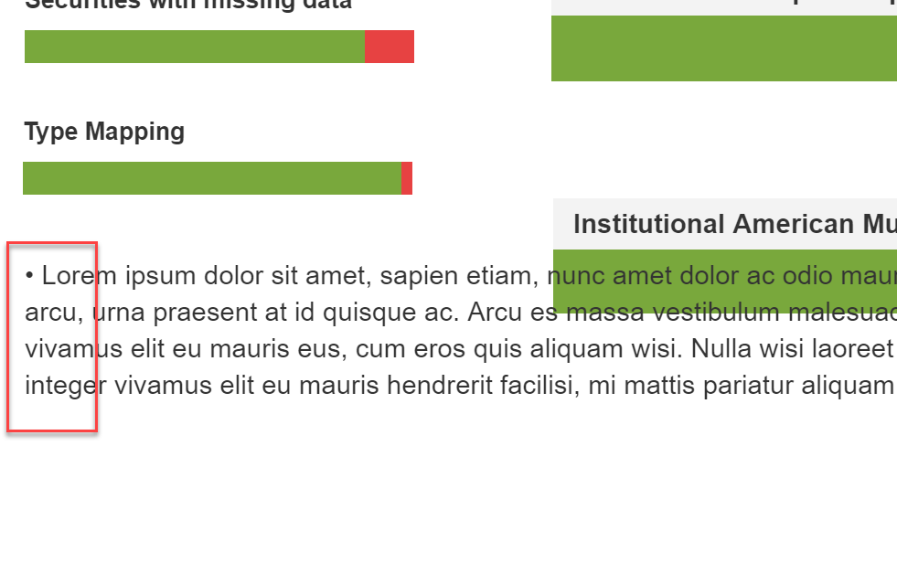

The bullet list doesn't properly align the text.
  • this is a bullet and on the second line the text starts at the same alignment of the first, is is a bullet and on the second line the text starts at the same alignment of the first
This doesn't happen in justinmind the second line of text starts at the same alignment as the bullet.
Can you explain more about this issue? If possible, can you attach a file in which this occurs?
Hi Danielle, see attached, the text wraps at the wrong alignment.
Thanks for including the image. I can see the issue. I have sent this to our development team and we'll work on fixing this.
