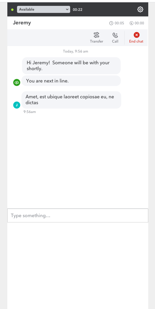

Is there a way to fix the HEIGHT of a simulation. I'm able to fix the width. But, I'm working with a custom container that has a very specific height by default. When I run the prototype, the height expands the height of the browser. I attached an example.

Sure! In the attached image, the white background is extending the entire height of the browser window. However, the widget I've designed is only 480 x 750 (custom size). I was expecting the height of the widget during simulation to stop at 750. Resizing the browser window is an OK work-around. But, it would be nice if I could send the link to people to check out the prototype w/o having to ask them to resize their browser window.
Is that widget the only thing on the screen? If so, you could try a workaround of making the background color of the screen the same as the simulation window (EFEFEF), and then Pin the image to the center of the Canvas.
