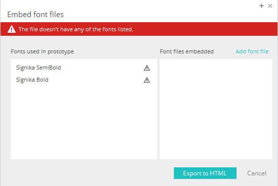

I have a problem with the fonts used in my prototype and trying to embed this font. In my prototype I have used the font Signika Semibold and Signika bold. When I try to export my prototype to HTML I have to embed the font.
But when I try to add the font file to the prototype I get the following warning (see attachment) eventhough I have selected the correct font file on my laptop and the font is also a Google font in my library in JIM. How can I solve this problem? Because I really would like to use the font Signika.

Unfortunately, we haven't been able to reproduce this issue. Can you confirm if the font is already installed directly on your computer?
Hi Sonia,
Yes the font is already directly installed om my personal computer. But I've made a prototype for an iPad, which means that I would like to show the prototype on an iPad (on which the font is not installed) (I also would like to share the prototype with other people, who may have not installed the font). Is it possible to show the same font on the iPad as I have used in the prototype on my own computer?

There may be a slight difference between the fonts that is causing the issue. The font files must be exactly the same, and stored the same way in folders. We are working to find a way to make embedding fonts easier.
Also, you can replace all fonts at once by going to Edit -> Replace styles.

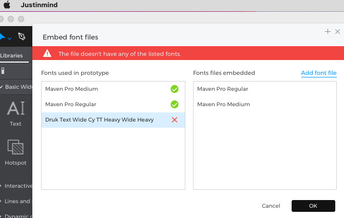

Interested specifically in the font: DrukTextWideCyTTHeavy. But I noticed a problem with google fonts, for example, with ArchivoBlack-Regular. Fonts could not be attached to the message. Link to the cloud: https://drive.google.com/drive/folders/18iX2SbylgfhrlqHQarh6ne5kuP1uXIfB?usp=share_link

Please try using the font "DrukTextWideCyTTHeavy.ttf" . There are no problems with the font "ArchivoBlack-Regular.ttf" in Mac OS, but there are problems with the font "DrukTextWideCyTTHeavy.ttf" in macOS and Windows.
Hello, could you try to make a new prototype with the font "Druk Text Wide Cy TT Heavy" and embed it on Mac?

Hi Marveligor,
Developers have fixed that font bug you have. We will release an update in a few days with this issue resolved among other fixes.

Hello, please download the latest version, and let us know.
https://www.justinmind.com/download
As soon as I try, I'll write to you.
Everything works, thank you.
