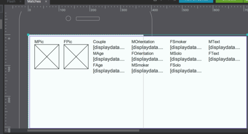

From the tutorial : " Arrange all the content inside that cell until it matches the example." - I can seem to arrange anything I just see each label followed by the field in brackets - this is to wisiwig interface - just text. Should I be "arranging", by knowing the exact locations that I want to place each field at? b6f174b623ab04cc69146605246e276f
