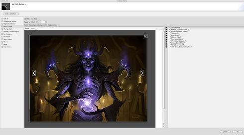

I created the modal as a Master and then added it to the screen, but I am not sure how to implement the Close button. All modals must have close buttons, and it would make sense that it should be part of the Master, so you do not have to create it multiple times, correct?
When I try to create an interaction from the Close button on the master, there does not appear to be a way to select the entire master from within the Interactions dialog. I can only hide one object. Unless I am mistaken, this makes it impossible to implement an entire modal as master.
In the image below, you should be able to see the problem. I selected the Close button on the top right and tried to Hide the entire modal. I could create a link to the original page, but then I would have to create a different master for each page (which defeats the purpose of the master)![097e5483e31869a9aebf41fb2da7bbb2](https://assets.justinmind.com/community/public/attachments/097e5483e31869a9aebf41fb2da7bbb2.png)
I am not sure if this is going to work.
You are right, there is no way to hide the entire master within the master itself. What I would do in your case is to build the master without the 'close' icon. Then I would drag it to some screen. Once in a screen I'd draw the close icon just above the master in the screen. Then I'd group the icon and the master in the screen. Finally I'd define the event on the icon that hides the entire group. Next time I'd like to use that master I'd go to that screen and just copy and paste the group.
