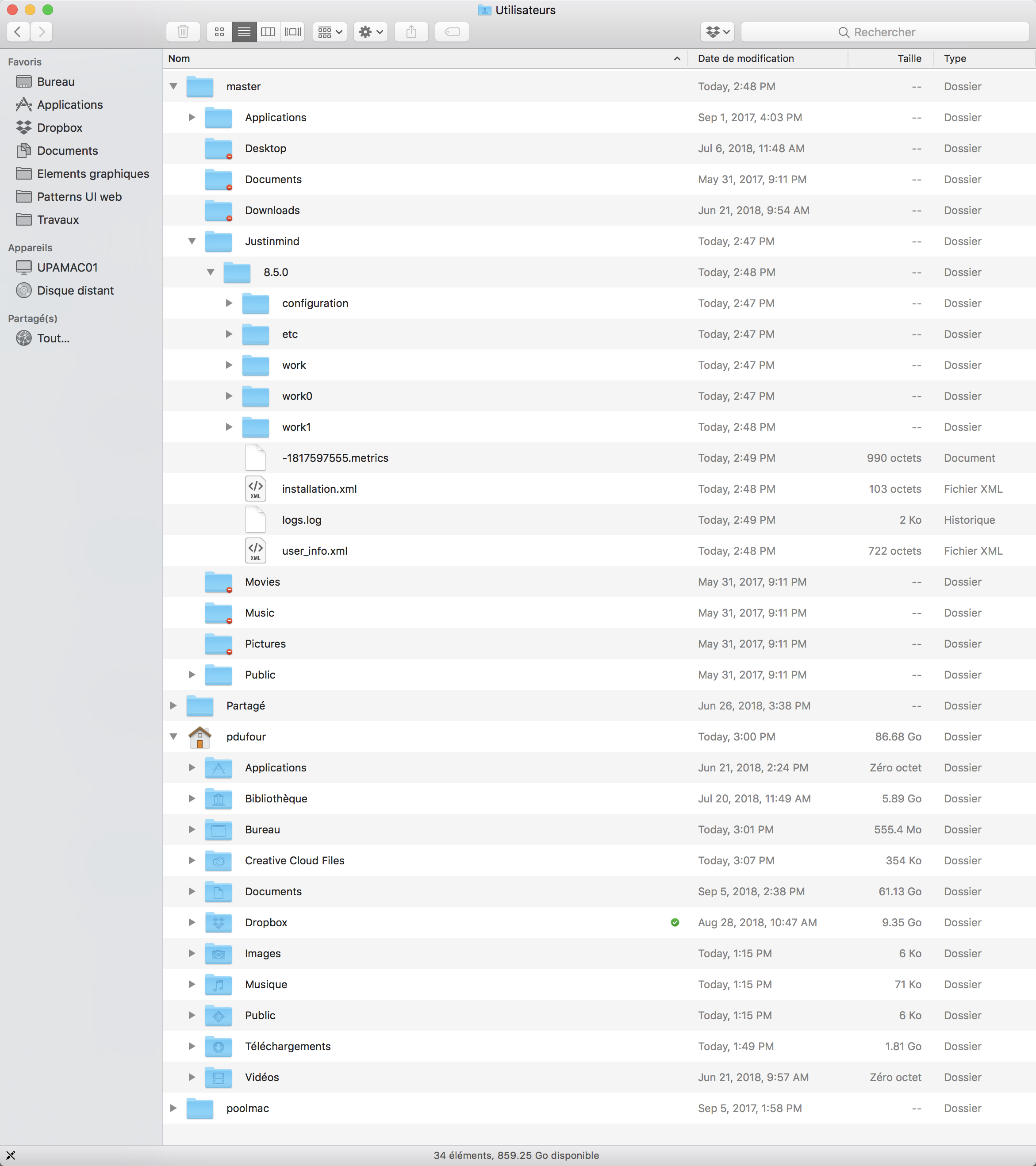

The log file isn't there. With the technical support here, we succeed to install the app on the Admin session, the app was working correctly and the justinmind folder was created in the user folder. So after we try again to install it again on my own session, but this time by giving me admin access, but it didn't work. Any ideas of what is causing the problem?

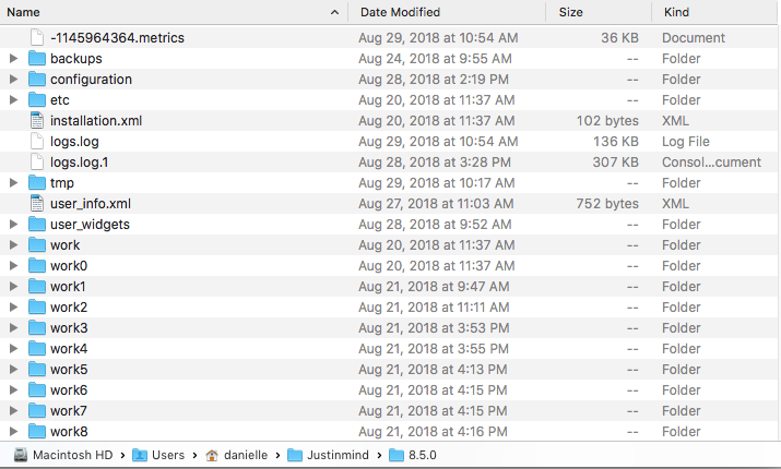

Are there any other logs in the folder? Can you attach a screenshot of that folder? It should look similarly to the attached screenshot.

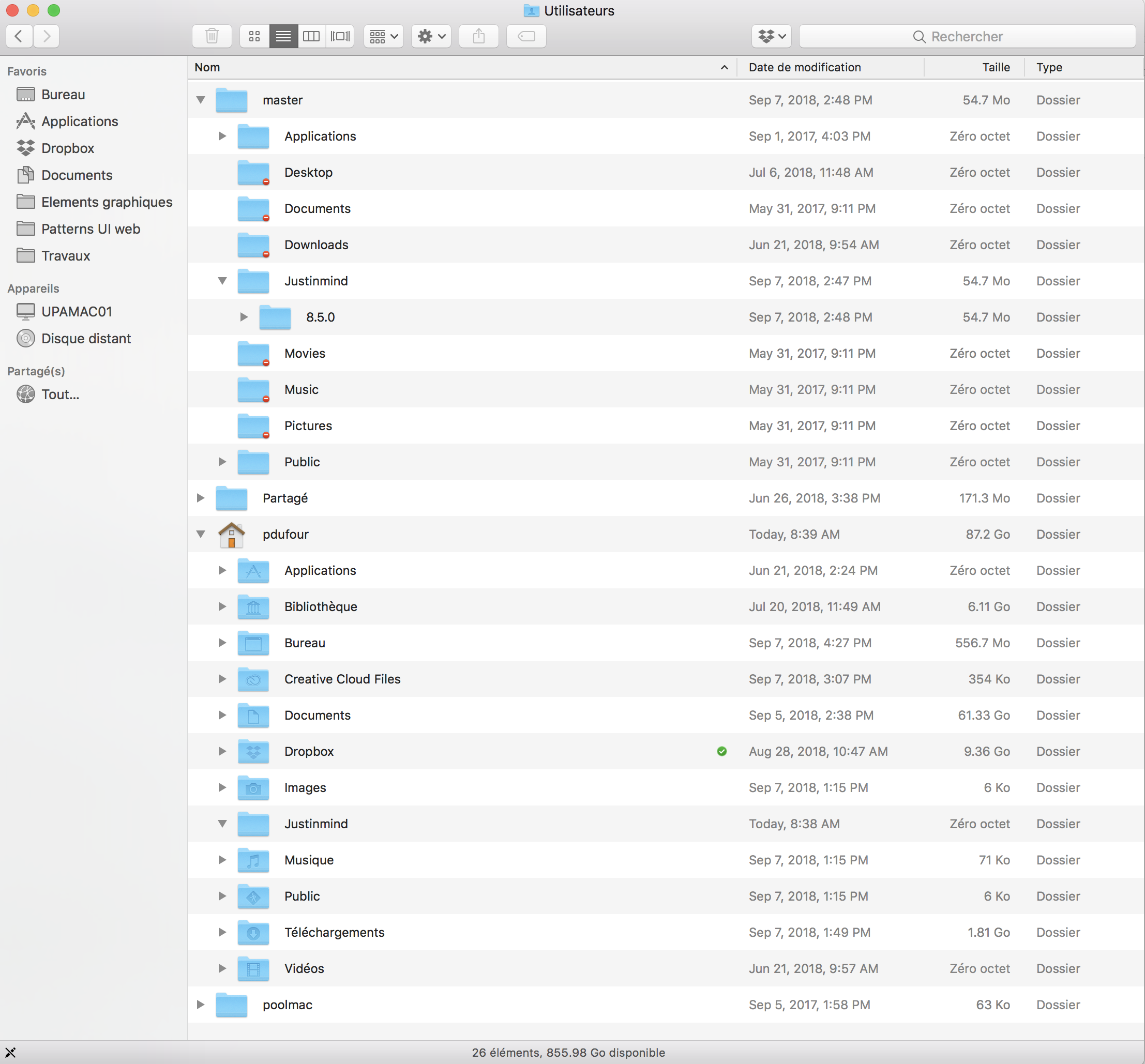

There is none in my user (PDUFOUR), but there is one in master.
That should work. Can you attach the logs.log file shown in that screenshot?

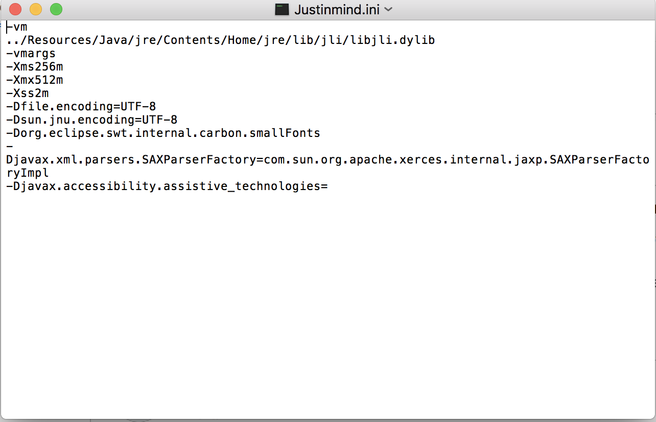

Can you try right clicking on the Justinmind application, then click on show package contents? From there, open contents, then MacOS, and there is a folder called Justinmind.ini. Open that file in a text editor and then remove the first 4 lines of the text in that file.
Then try restarting Justinmind.

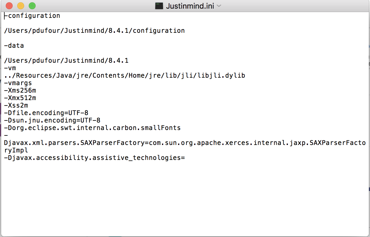

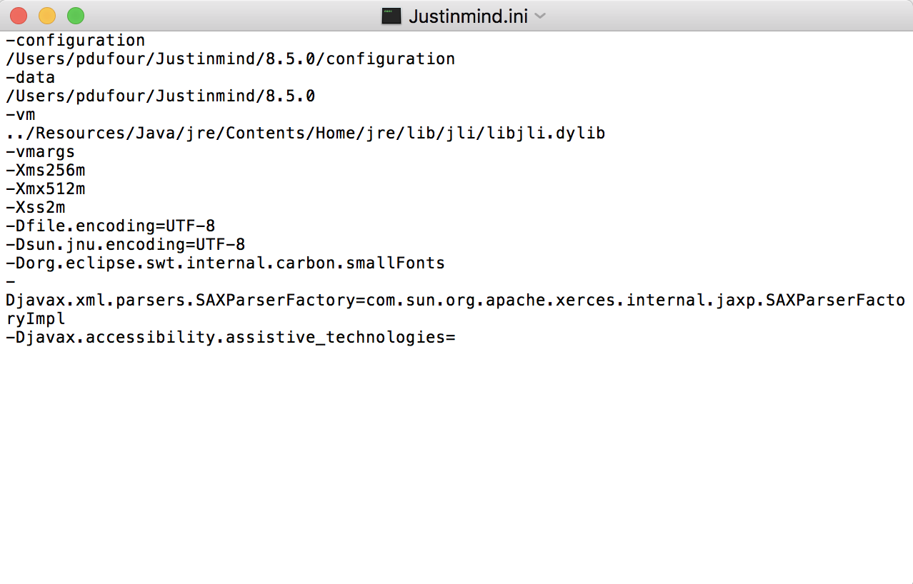

It's done. But the app remain Not responding when I try to open it. See screen capture, is that how the file should be?
Okay, open that .ini file again and replace the four lines you deleted with:
-configuration
/Users/pdufour/Justinmind/8.4.1/configuration
-data

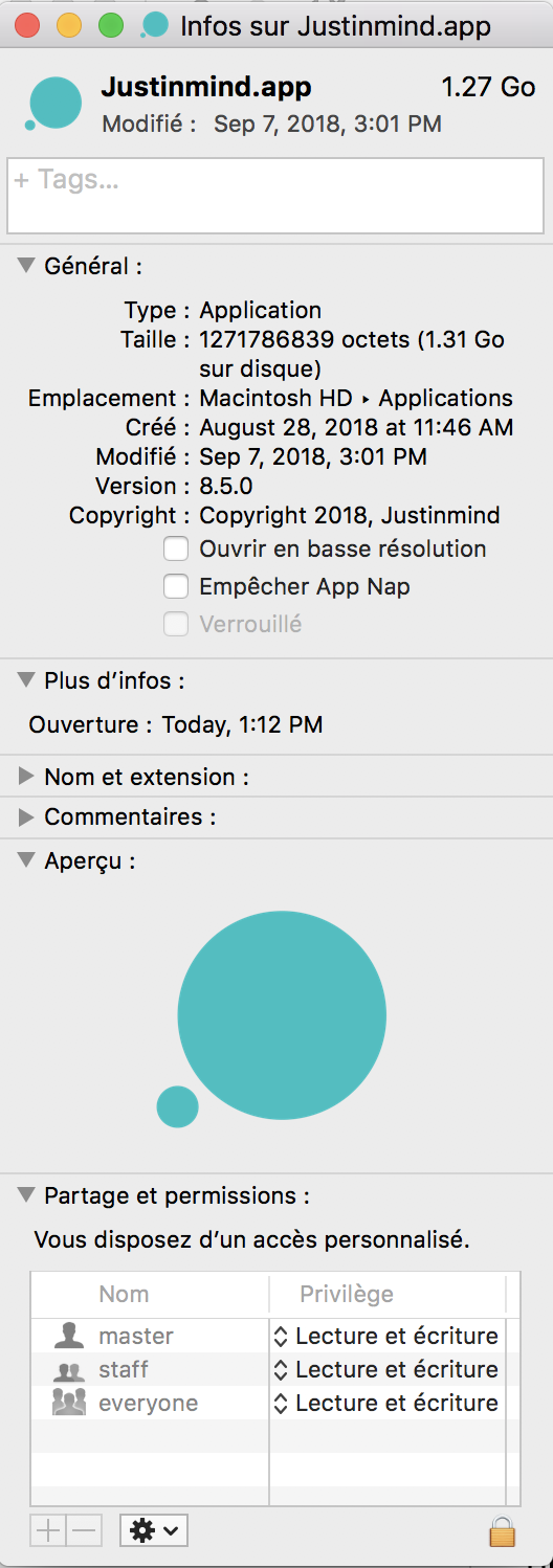

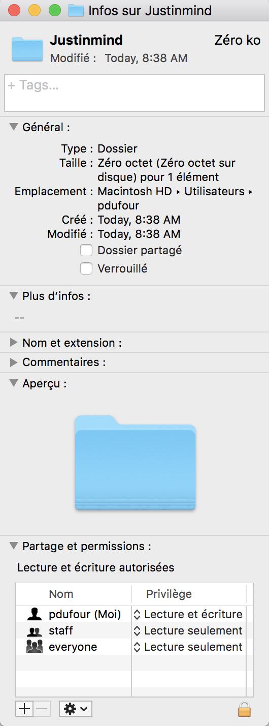

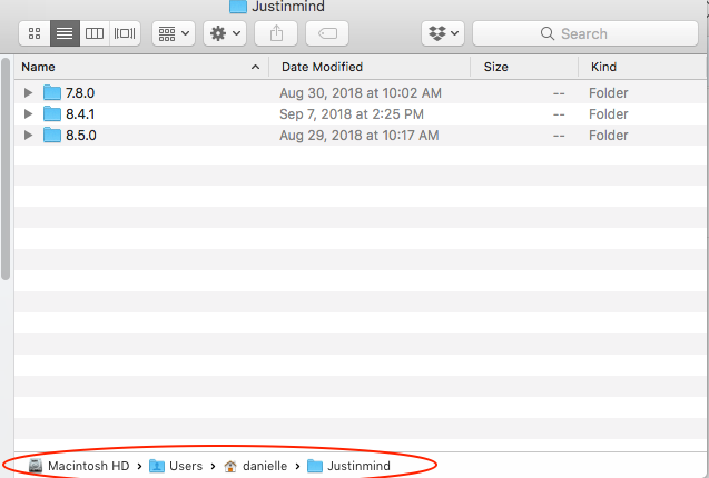

Can you list the path of the Justinmind folder you created? Can you also take a screenshot of the 'get info' screen for the Justinmind application?
Here it is. Thanks for your help.
Can you list the actual path of the Justinmind folder?
Is this ok?

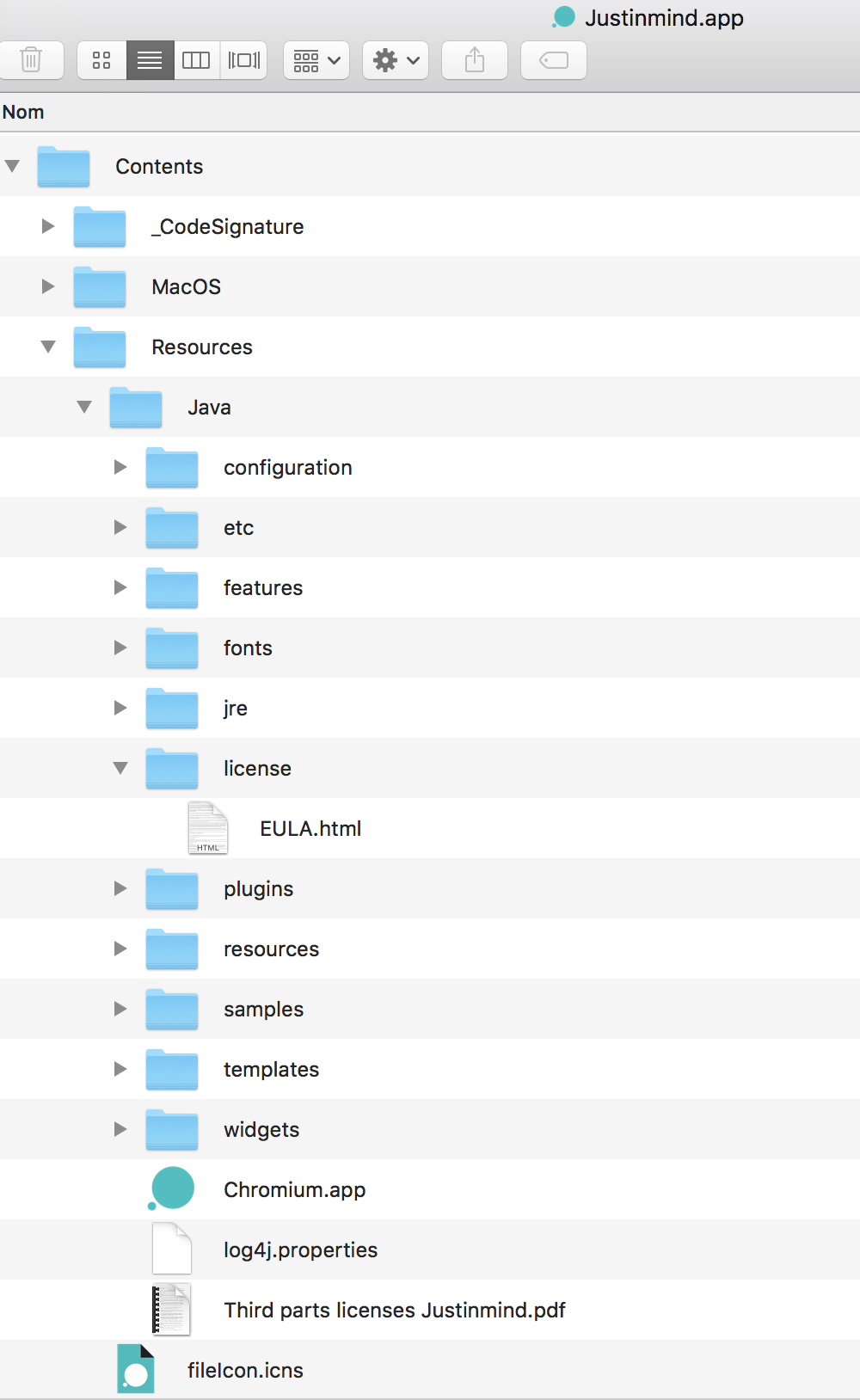

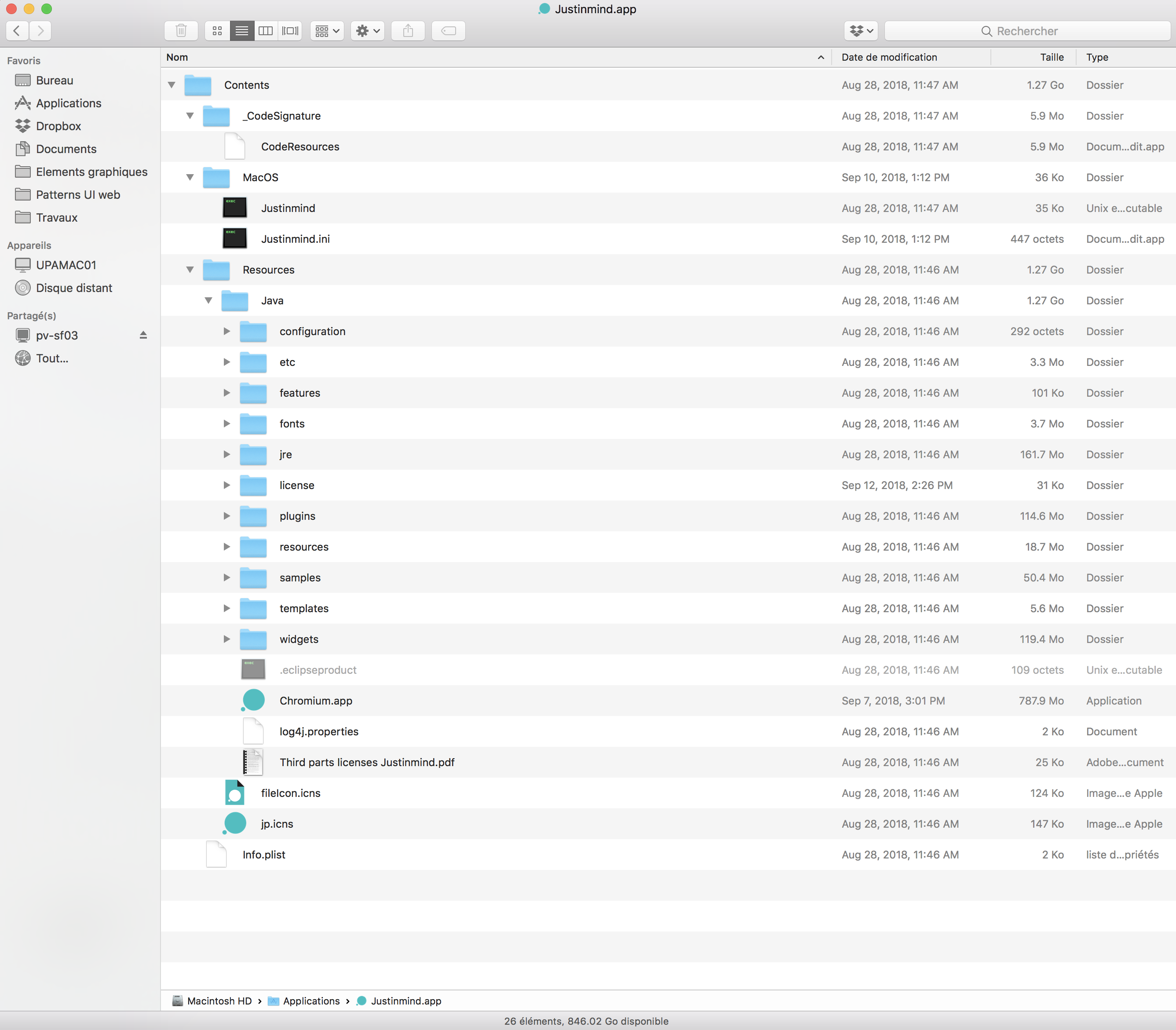

Can you check if the license file for a trial is in the folder (/Applications/Justinmind/Contents/Resources/Java/license)? It is named “JustinmindPrototyper.lic”. If is there, send it to us. You can also try to create a folder inside that (Applications/Justinmind/Contents/Resources/Java/license) folder and see if you can write in it.
Hello. There is no file named JustinmindPrototyper.lic in the folder License. I can create a new folder, but what am I suppose to write in it?

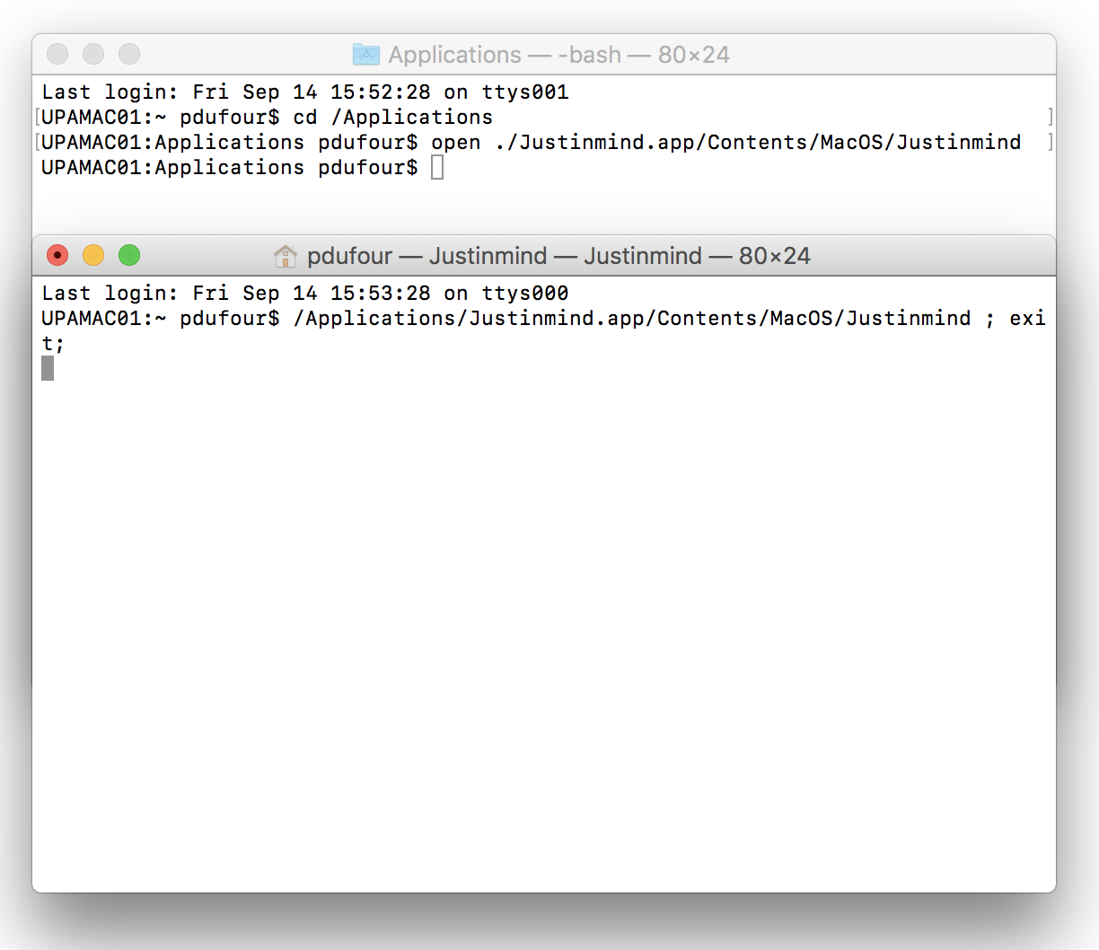

We have a test to figure out why it's still not working.
First, copy the attached files in “/Applications/Justinmind.app/Contents/MacOS/”. One is a hidden file named “.options” so the best would be to show the hidden files (“CMD + SHIFT + .”) if you're not doing that already. (Using the shortcut again will hide them!)
Then, the rest is done in Terminal.app, so you need to run shortcut CMD + SPACE and type “Terminal” in spotlight.
Once you open Terminal.app, type:
cd /Applications
Then:
open ./Justinmind.app/Contents/MacOS/Justinmind
This will open a new Terminal window with a bunch of text and Justinmind in the background.
We’d like you to attach the text inside this new terminal window, in a TextEdit file, for instance.

Apologies, we meant to attach some files in our last message, but they weren't attached.
Unzip the files we attached and then copy them into “/Applications/Justinmind.app/Contents/MacOS/”
Now open the terminal app and type:
cd /Applications
Then:
In the new terminal window that opens there will be some text that you can select and then copy and paste into a TextEdit file and attach here.
