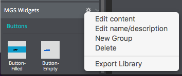

I am using Justinmind Ver. 8.4.1 and there is no option to share my widget library as in the above link. Only Export. I am using an Enterprise version of the app.
Hi Chris,
According to our database, you are actually using the Professional version. You can go to 'About Justinmind' in your application to confirm this. Unfortunately sharing widget libraries is only available for the Enterprise version, so you will need to manually export and send the library.
