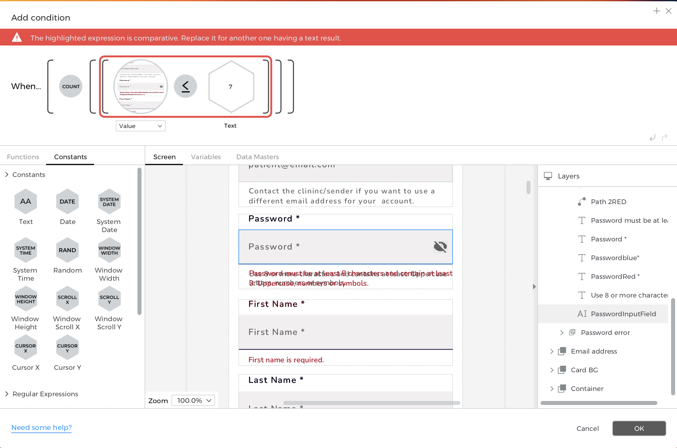

Thank you for your message. I have attempted to apply the conditions you provided, but only capital letters (A-Z) are functioning properly. The other expressions are not working, especially when I combine them, and they do not work even when applied separately. I have attached a screenshot (Ref: Screenshot 2023-05-12) to show the error that occurs when I use the regular expression for an eight-character count in the input field.
Additionally, I have attached a working file to demonstrate that the error does not detect when I do not include numbers in the password input field, but it does detect when there are no capital letters. I would appreciate any assistance you can provide with this issue.
Moreover, when I share the screen for user testing on Android phones, it becomes stuck, and the fonts are not being embedded in the prototype. The headline and sub-headline fonts should be Abhaya Libre and Nunito, respectively, but they are not being detected.
You are using onChange and onFocusOut events at the same time in the password input, you could choose one, for example the focusOut one.
The count of a text counts how many characters the text has, but you have to pass the text as a parameter, in the screenshot you are trying to pass a comparison as a parameter, that is, count(text < 7), it should be count (text) < 7.
I am attaching an example with all the conditions combined so you can see how it works.
