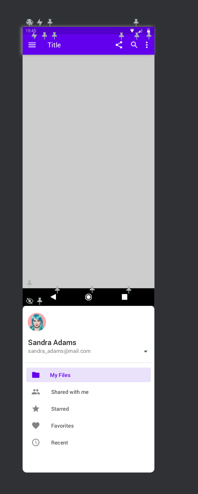

Where can I find this Android screen example?
Need Answer Cuzimsummer ● 4 years ago
When I first installed JustInMind, there were thumbnails of these example screens.
Now that I've relaunched the program, I can't find them anymore.
Where are they?
Hello, here is some information that may be useful to you.
Let me know.
https://www.justinmind.com/design-templates
https://www.justinmind.com/examples
Hello, apologies for the inconvenience, in version 9.8.0 the android library were updated and the widgets you are looking for are from the old version, to recover them we can dowload the file from this link:
  1. http://d2ld3he4yll0xl.cloudfront.net/AndroidComponentsOld.jpl
and import from "more libraries".
