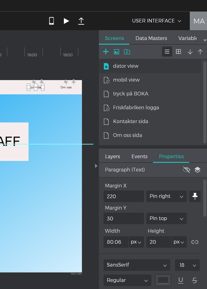

Hi! I am trying to make my screen's text fonts adjust to the screen size of the user. The problem is that the background is adjusting right but the text slowly disappears letter by letter. This happens when simulating my prototype. I have tried to pin them but it doesn't help.

Hello Kaihan, here I attach your .vp with some modifications, and I attach a screenshot. The elements with pins measured in percentage is what is causing you problems, if you change them to pixels, you will no longer have this issue. On the other hand, the rectangles have their own text attribute, double click on the rectangle to enable it. Let me know if this information is useful to you.

Thanks, I will try them but I am having a bit difficulties. I have changed the different buttons such as "kontakter" and "Om oss" to percentage width and height but other things changed. Now all of a sudden the "BOKA" and "STAFF" buttons are not aligned and there is a white stripe on the right side of the screen when simulating the "mobil view"- screen on DEVICE. Could you possibly help me with this?

Hello, I made some modifications, the blank space disappears when you make a pin to the backgrown, and by removing the pin from the information rectangle, the scroll down is solved.
