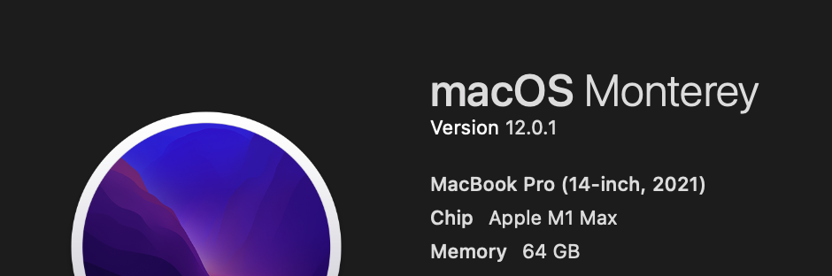

Hello Karl,
Could you tell me what version of macOS Monterey you have?
Thank you.
Greetings
Monterey 12.0.1 (About this Mac screenshot attached)
Thanks Matheus for the information, we will get back to you soon.
