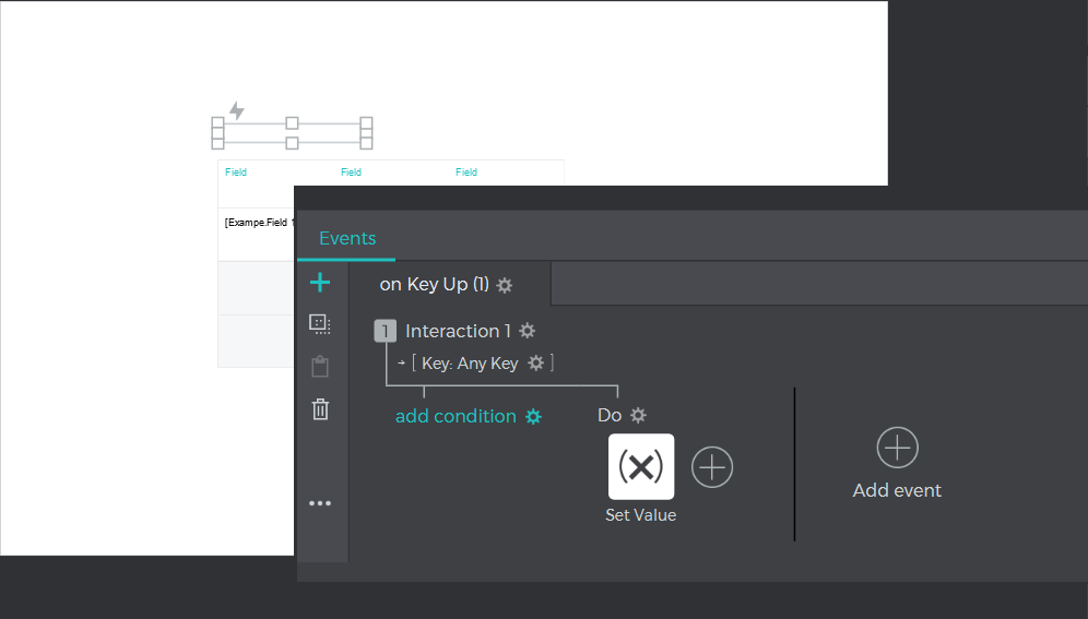

Here I attach an example, remember that the option shows the entire list and when entering a character or a word in the input field, it returns only the results of the applied filter.
look at the interaction in the input field,
let me know if it worked for you.

To be able to see the interactions: select at the top of the screen - windows: events - to be sure that you have the tab displayed -, then click on the input field, there you can see the interactions attached to the item.

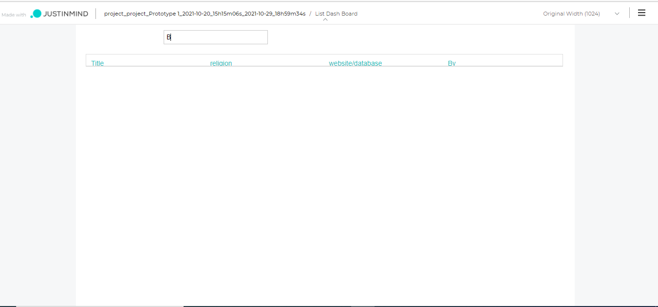

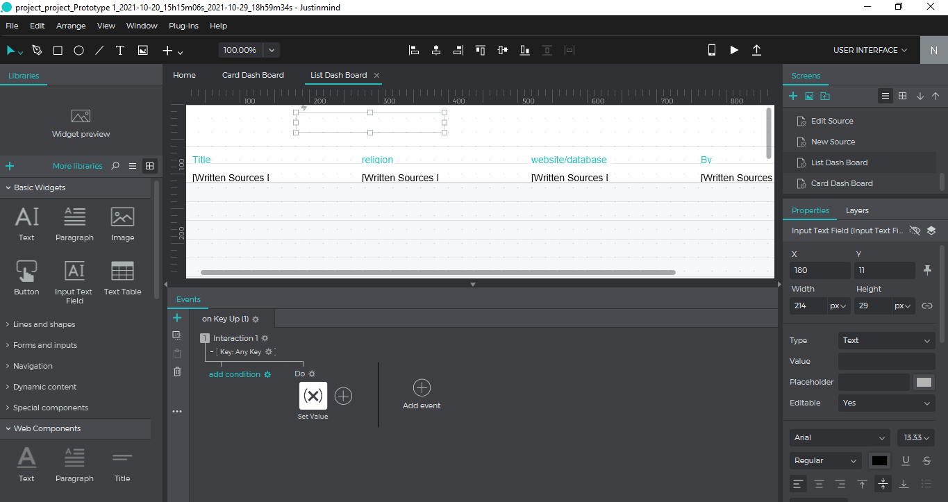

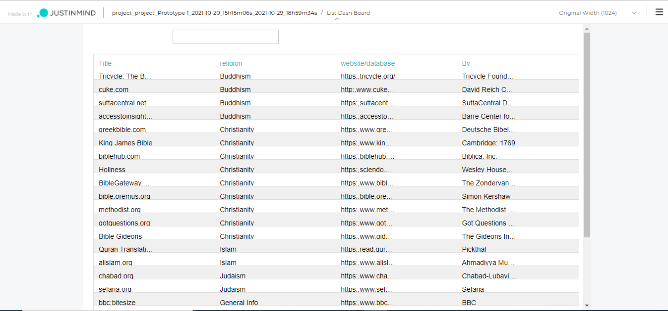

I repeated all the process written in tutorial one again and checked the interactions pattern in events panel is also the same. On simulating, it shows data list but by entering any character in the search bar the whole list disappears except the header row. screenshots attached.
see file1, file 2 and file 3 respectively.

I have reviewed your vp and in order to perform the search action in a database, you would need to add a data grid / list to your prototype.
Here I leave you the tutorials on how you can use the grids and list to display Data.
https://www.justinmind.com/support/data-grids/
