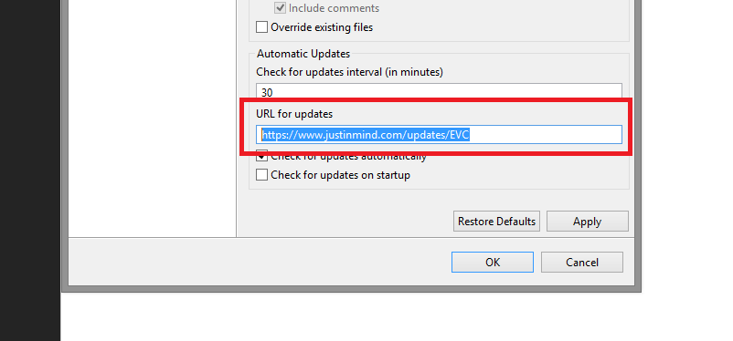

Can you confirm that you are connected to the internet properly? Also please check out that at "FIle" / "Preferences" / "URL for Updates" contains the same URL as the screenshot attached.

Hi Sonia,
you were right with the internet connection.
There was no connection between Justinmind and the internet.
However, Justinmind has not displayed the error.
Our network admin could fix it.
Now it´s working.
Thanks for your help! :)
