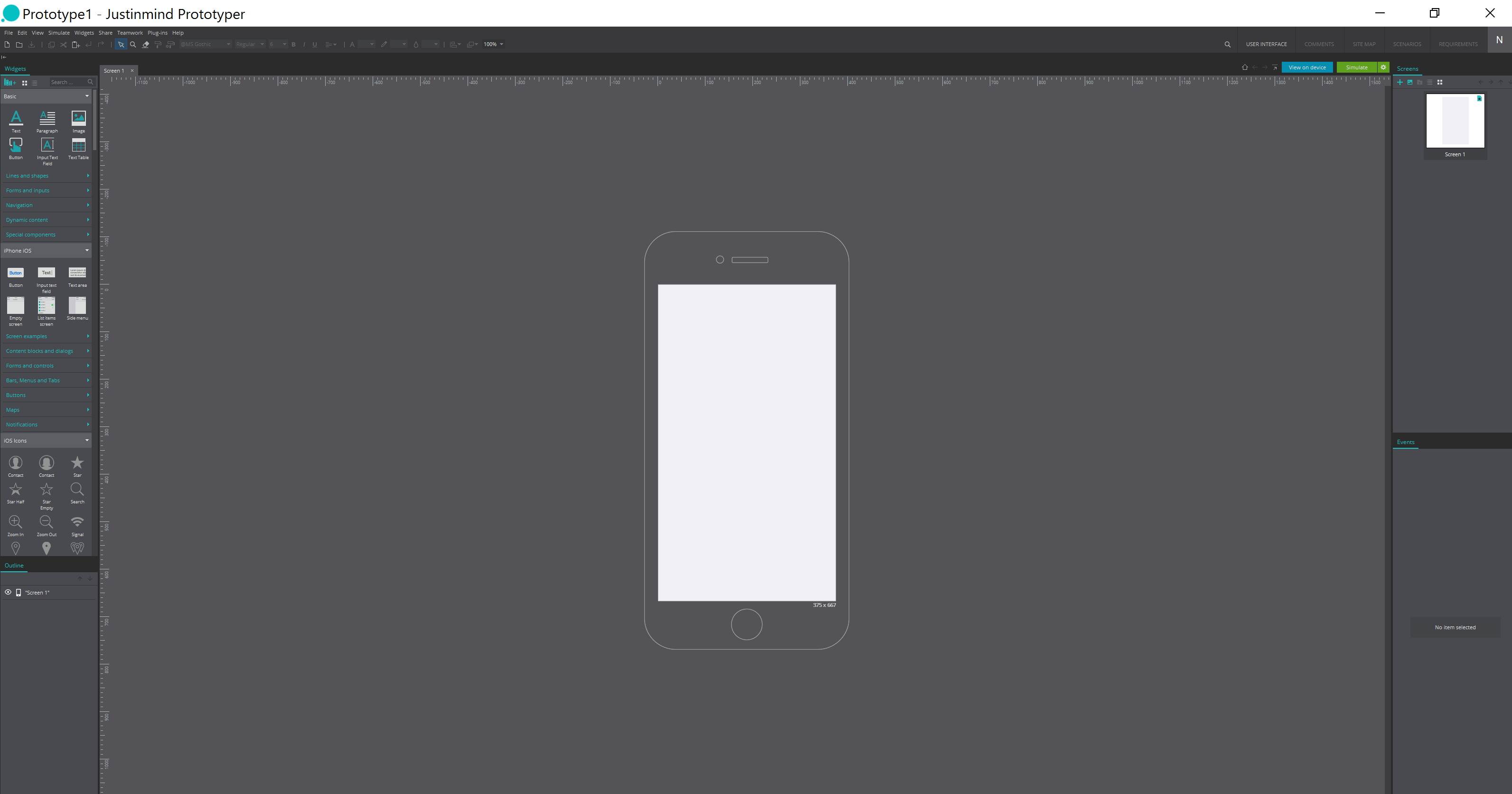

The desktop app for windows 10 makes the sidebars appear extremely, extremly small making it very difficult to work with. It is not the settings on my laptop, as no other screen or programme I run appears this size.
Any ideas why? Or what fixes I can try to make it a readable size?
Attached is an image true to size.
Hi Nicole,
Look for and launch this file and it will fix the issue:C:\Program Files (x86)\Justinmind\Justinmind Prototyper 7.6\JustinmindPrototyperHiDPI.exe
