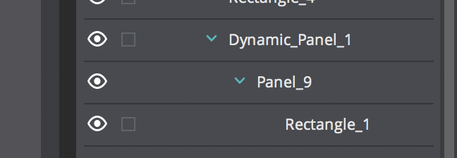

1. Add a Dynamic Panel to screen, set width to 100px
2. Set Dynamic Panel padding left and right to 20px and Layout to vertical or horizontal
3. Add a Rectangle to Dynamic Panel

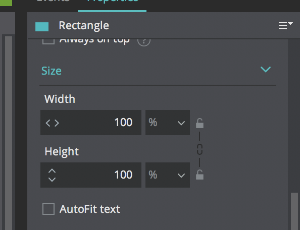

4. Set Rectangle width and height to 100%

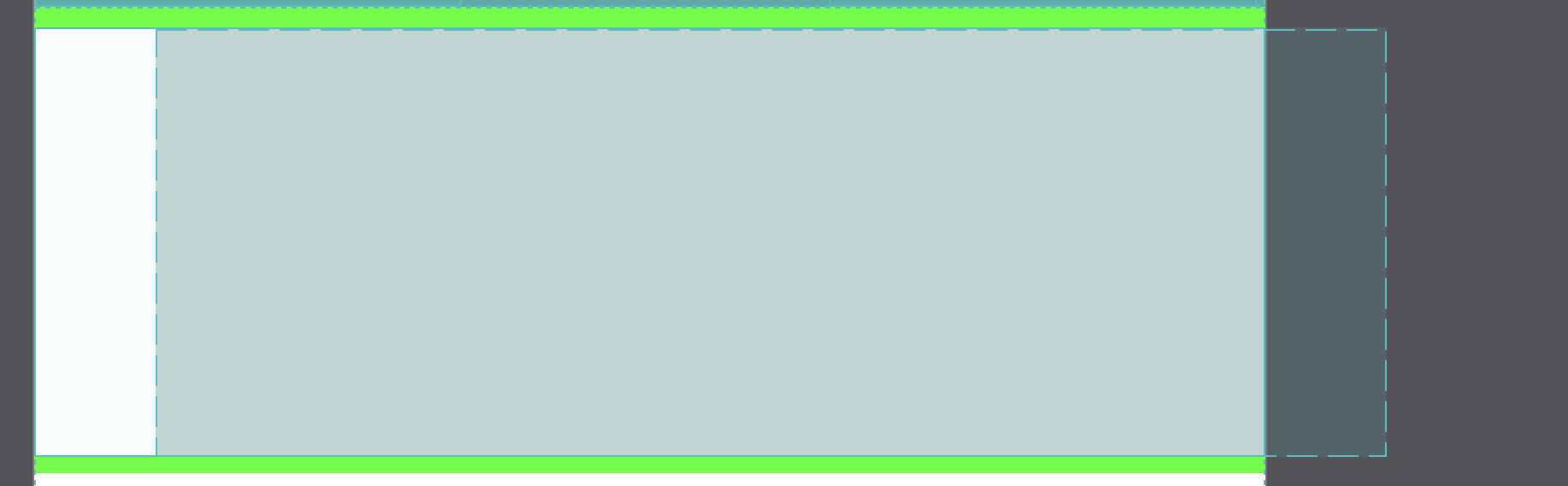

The rectangle will overflow outside of the dynamic panel by 20px, and width is 100px.
Note that the same behaviour is for Dynamic Panel bottom padding.
Expected Result
The rectangle width should be 60px (100px - 2 * 20 px padding) and be centered in the Dynamic Panel.
