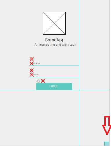

Hi Lisa,
After some analysis we have detected it's a bug that will need to be fixed by our development team on future updates. Meanwhile as a workaround you could place a hotspot at the bottom right corner (see the screenshot attached).
Sorry for any inconvenience.
