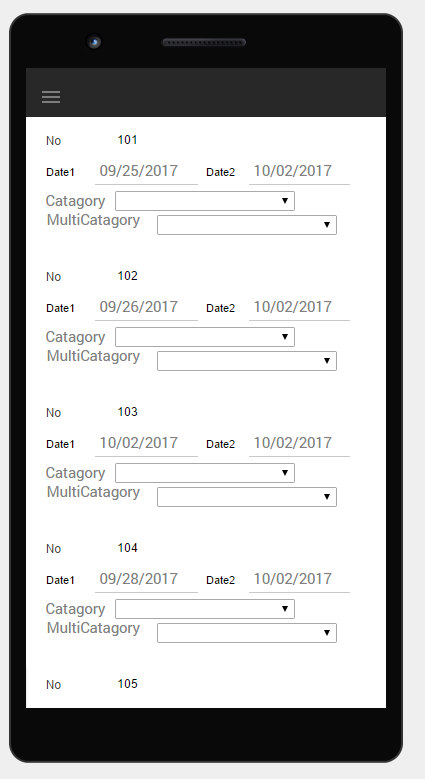

Hi Danielle, thank you for your response. I am attaching a .csv files and the screenshot of the simulated prototype. I am not able to upload .vp file here. How do I share that with you?
.vp file has only one default screen having a datagrid bound to the data master. The test data master has fields of various types. There are two dates fields one editable and another is non-editable. In the simulation it shows both dates but doesn't provide the option of changing the date in the simulation mode. On the phone it never shows the data loaded in from the data master, but it shows ......... with down arrow to click for calendar wizard.

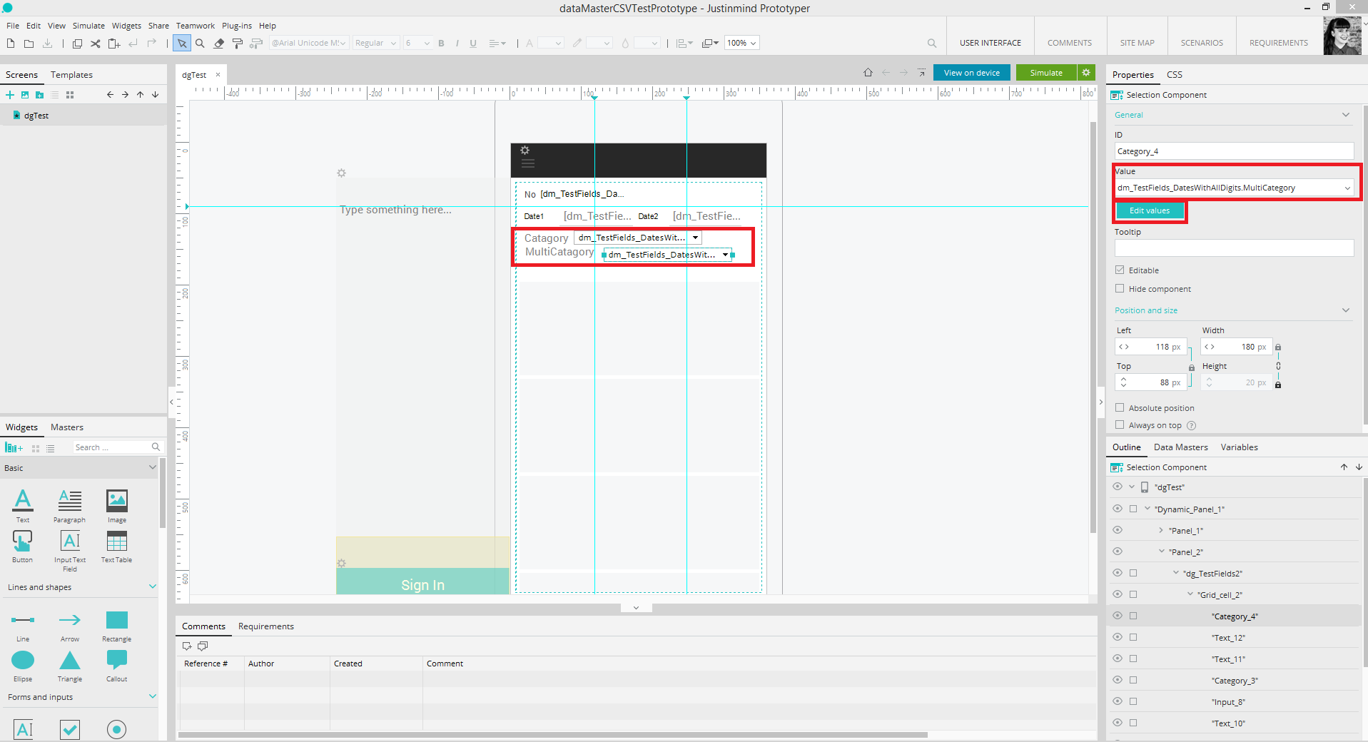

Please see the attached prototype with the Category and Multicategory fields associated to the DataMaster.
The main problem is that the categories (options) were not introduced at the DataMaster (explained how to do it in this video https://www.dropbox.com/s/russgrgkkrcykys/TestCategories.rar?dl=0) and also the "Selection Components" where not associated correctly with the DataMasters. (Capture Attached)
