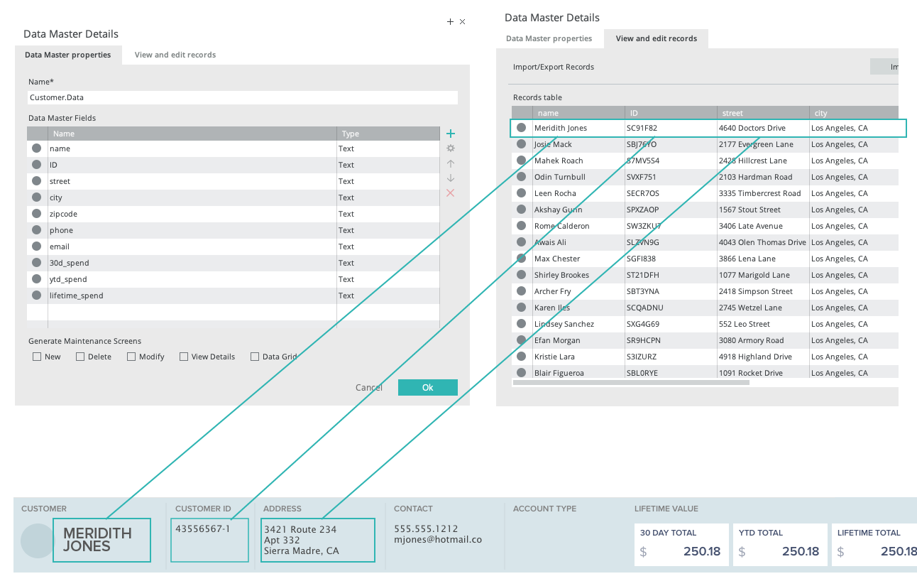

I am trying to leverage a customer data master + with a list of 20+ customer records. I want to pull data from a single row within the record - (name in one location) + (address in another location) etc to populate across multiple screens. I haven't been able to find a specific solution here to this problem.

Thank you. In the example you posted, you are filtering the list to a specific name within the record. In my thinking, if the name changed, the expression would break. Is there any other way to point to that record/row/column without hard coding the name into the expression?
Yes, you just need something to filter it by. For example, you can have a search field that you can enter a name in to filter the list.
Understood. I am thinking that it is much easier to actually create a data.master with all of the specifics of a customer view, and just set the value based on each. I think if you all could actually generate variables based on the records created - it would be super easy to do this...without a lot of complexity in building expressions for each input/display.
