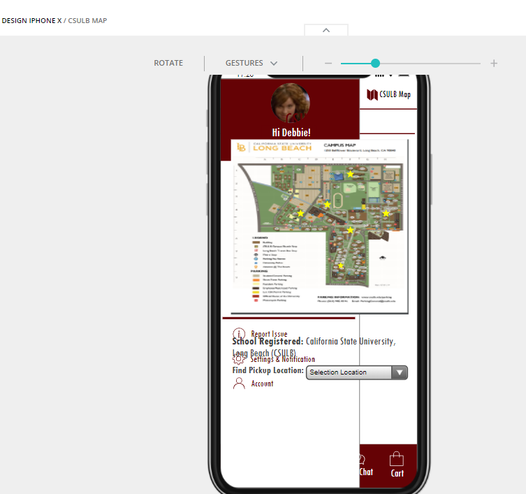

Template screen side menu not working on other screens.
In Progress John Nance ● 6 years ago
Whenever I try to simulate my app and click the side menu from the template on the other screens, the text and images on the other screens are over the side menu. Is there any resolutions for this?
Try grouping everything in the Template, and mark it as 'Always on Top' in the Properties palette. Then, the Template's contents should appear above other content in the screens when you simulate.
