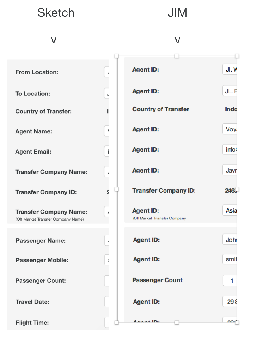

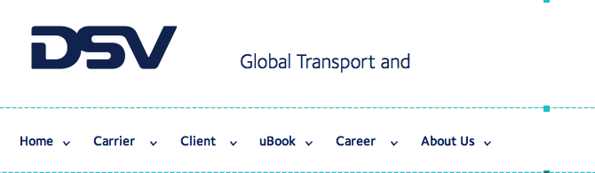

I am evaluating your software to see if it will work for my team's prototyping process. We currently use Sketch to design our layouts, I've downloaded and installed your plugin to test the functionality, however, I have run into some very significant issues.
1) The app has crashed 7times while trying to learn and work with it. I'm not sure if this is caused by the files being imported from Sketch, but it is a significant pain and not encouraging.
2) When working on the different screens that have been imported many of the text layers are being cut off. I have to manually go in and adjust them to see all of the text. This basically forces me to have to re-design the layouts as they no longer have proper spacing, etc.
Please see attached.
If you're having a problem with the Sketch plugin for Justinmind, make sure you're using the latest version of the plugin, which you can download here.
If you're using the latest version and still have a problem, please let us know, and attach the Sketch file so we can check it out.

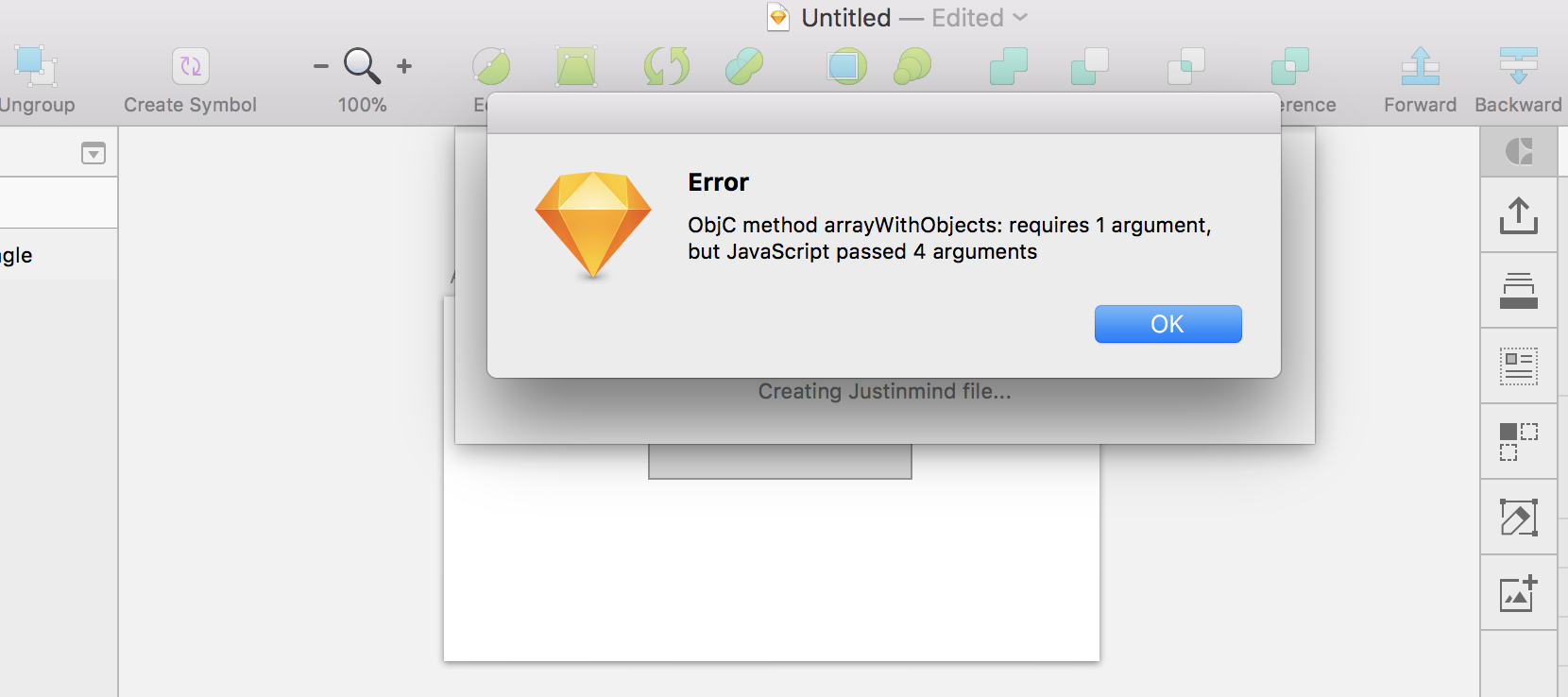

I am also having the same problem when I am trying to export layers from Sketch to JustInMind file. This only happens when I uncheck "Export text layers as images"
https://gyazo.com/8cda2a8e6bb9ef3cf8bb3f5c1a8e19f7
https://gyazo.com/a44ce0f5ac8437664b806ffc51f64890
Hi Rachel,
Thank you so much for that info. Does this happen for all Sketch files when you uncheck "Export text layers as images," or just that one?
The process seemed to be running/exporting fine until it hit that specific art-board/mockup in Sketch. Then it failed.
Hi Rachel,
Try downloading the new version of the plugin here: https://github.com/vconesa/justinmind-sketch
If this issue is still occurring after this, please let me know, and if possible, attach the sketch file.
Thanks for reporting this. You mentioned that this happens with multiple Sketch files - are they blank Sketch files, or do they each have some common element within them that could be causing the crash?

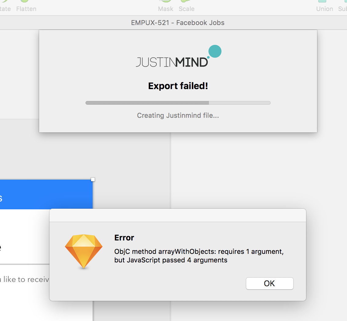

I am using the latest plugin, and the export keeps failing.'Object out of bounds' or something like that
Dear Tommy,
Can you make sure you are using v.1.0.3 of the plugin? https://github.com/vconesa/justinmind-sketch
Also, if possible can you attach a sample of your sketch file so we can try reproducing your issue. You can attach any file here at the community in a .rar extension.
Yes I am sure I'm using 1.0.3. (Mac OS Sierra 10.12.6)56dfd919fcbb26861c159e74328d429e
I cant compress my file below 6MB. Sorry about that
Could you upload it to a file sharing service such as Dropbox and attach the link here?
Dear Tommy,
You are right. It's a bug. I will transfer this information to our development team so they can take it into account for future updates.
Sorry for any inconvenience.

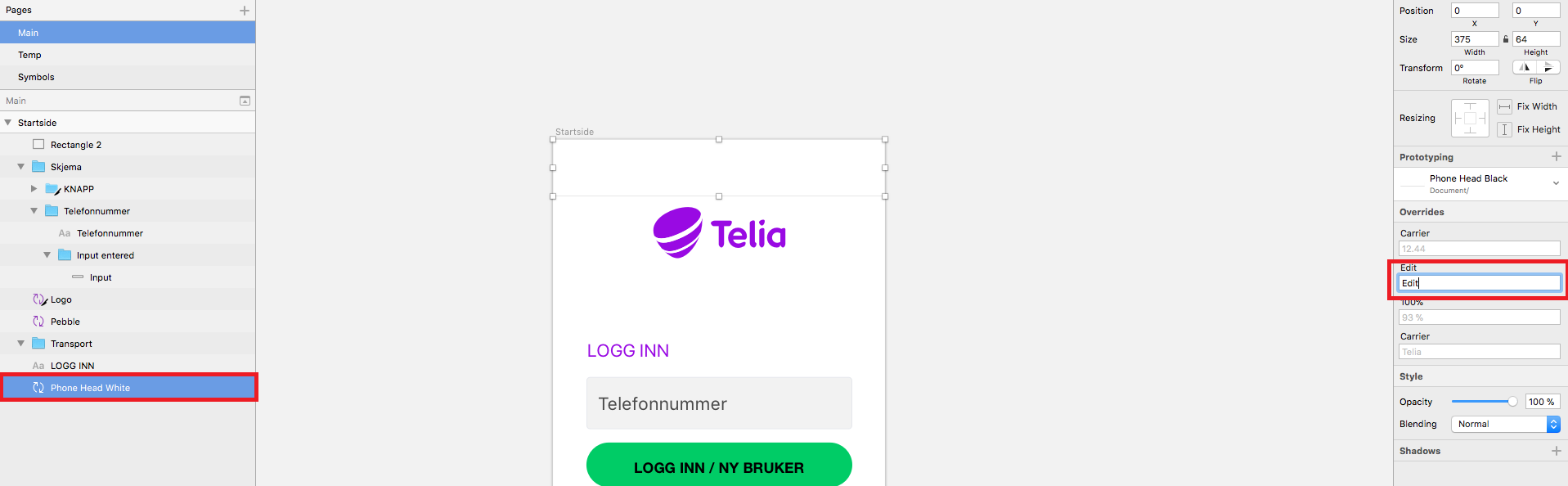

Dear Tommy,
We've been analysing your sample and we have detected that there is a component named "Phone Head White" that has a text gap. In case you add a text on it (Overrides Tab / Edit) you will be able to export without any issues.
Files: text.png
Thanks!

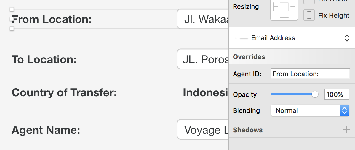

Hi Sonia,
Thanks heaps for answering.
I am actually talking about the "Override" side bar action (see attached).
I haven't made any changes after importing into JIM
Would you know how to solve this?
Regards,
Douglas
Dear Douglas,
You're right. Unfortunately, it's a limitation of Justinmind. I have transfered this information to our development team so they can take it into account on future updates.

Since this thread opened, I'm still having the same issues stated below:
Is there a work-around ? Or Is there going to be any update regarding such issues related to sketch import ? Thx
Thanks for letting us know about this problem. Unfortunately the only workaround is to manually adjust them, but I'll inform our team about this and we'll work on finding a solution.
