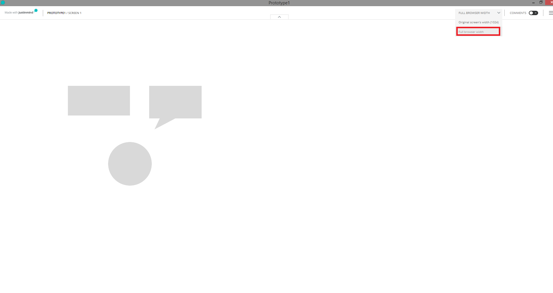

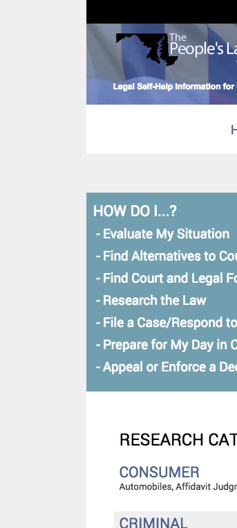

I'm designing a prototype at 1280 wide for a desktop browser and I need to change the background color in the simulator to white, rather than the very light grey that it currently is. How do I do that? If you see the screenshot, the light grey (#efefef) needs to be pure white to simulate a floating/liquid design. Thank you!
Dear Gagan,
You have an option available for web prototypes. You just need to Simulate and then click to "Full browser width".
