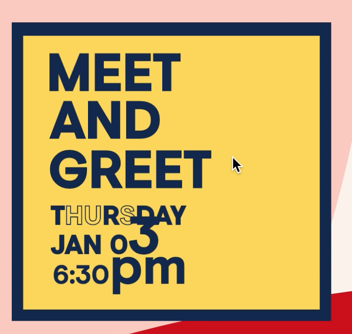

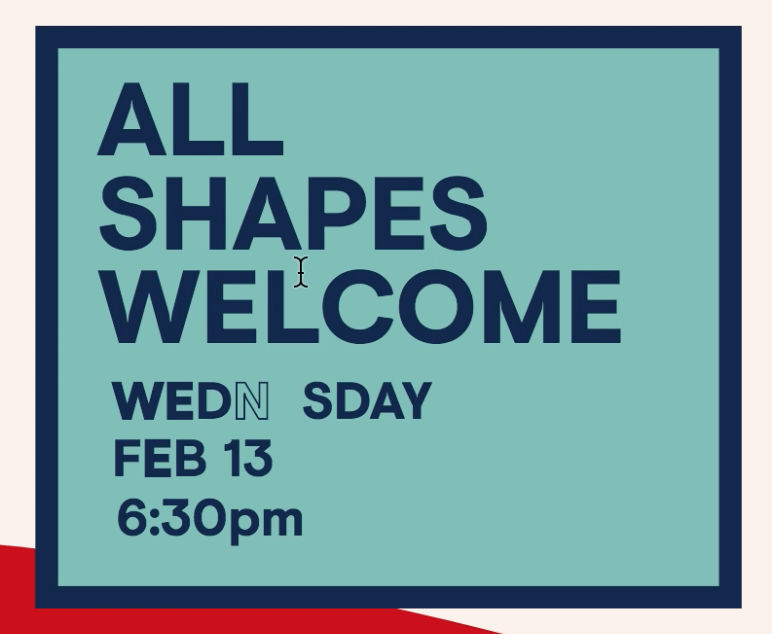

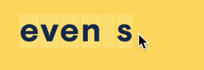

Hidden objects keep flashing and glitching when suppose to show during mouse over. Or letters from words disappear??

It looks like the issue is with the .SVGs. When opening them in a browser, they still don't appear correctly.
when I replaced it with PNGs the same thing happens
By the same thing, do you mean the letters from words disappearing as well?
No, but it continues to flash really fast every time I mouse over
Change the events from "On Mouse over" + "Show" to "On Mouse enter" + "Show". Then, on the image with color, create an "On Mouse leave" + "Hide" event.
