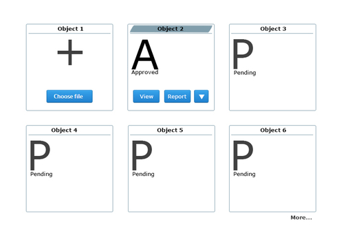

How would I simulate a rollover that shows action buttons on the object.
Let's say I have a set of 6 objects laid out in a 3 x 2 grid. Think of something like a photo with a caption on each one. When I rollover one of those objects, I'd like to see additional actions like Delete, View, Download as buttons, images, or links at the bottom of that object.
Like in the "mockup" (such that it is) below. The "approved" object has the hover state.
If I do a mouse enter on the container to show the buttons and mouse exit to hide, it hides whenever it is over another object. So, there isn't really a container-style relationship.

You can use dynamic panel. Here's a tutorial, http://justinmind.com/prototyper/lear...
On your dynamic panel, you will have two panels. On the first panel, you put 'Approved' label without the buttons. Add an 'on Mouse Enter' event to panel 1 then set panel 2 active. Now on panel 2, place buttons below the label and then add 'on Mouse Leave' event that set panel 1 active. d7d6dbe139d3b5578390dc5ead4d6507
