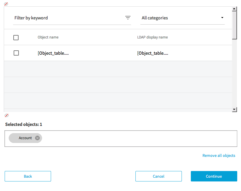

Hi Danielle, I'm so sorry to bother you again!! The condition you suggested worked perfectly. However, I have realised it would be better if I could try and achieve this outcome instead:
1. The table contains a number of rows. Each row contains a checkbox to select that row. On selection of the checkbox, a "chip" below the checkbox is displayed which contains the value of the object name selected.
2. The user can select the checkboxes in any order. Chips display below the table which correspond to the number of checkboxes the user has selected.
Action 1: user selects "Access template" OR Access rule OR Access rule policy OR Account OR ACS policy. Chip 1 displays below displaying the corresponding object name.
Action 2: user selects "Access template" OR Access rule OR Access rule policy OR Account OR ACS policy. Chip 2 displays below displaying the corresponding object name.

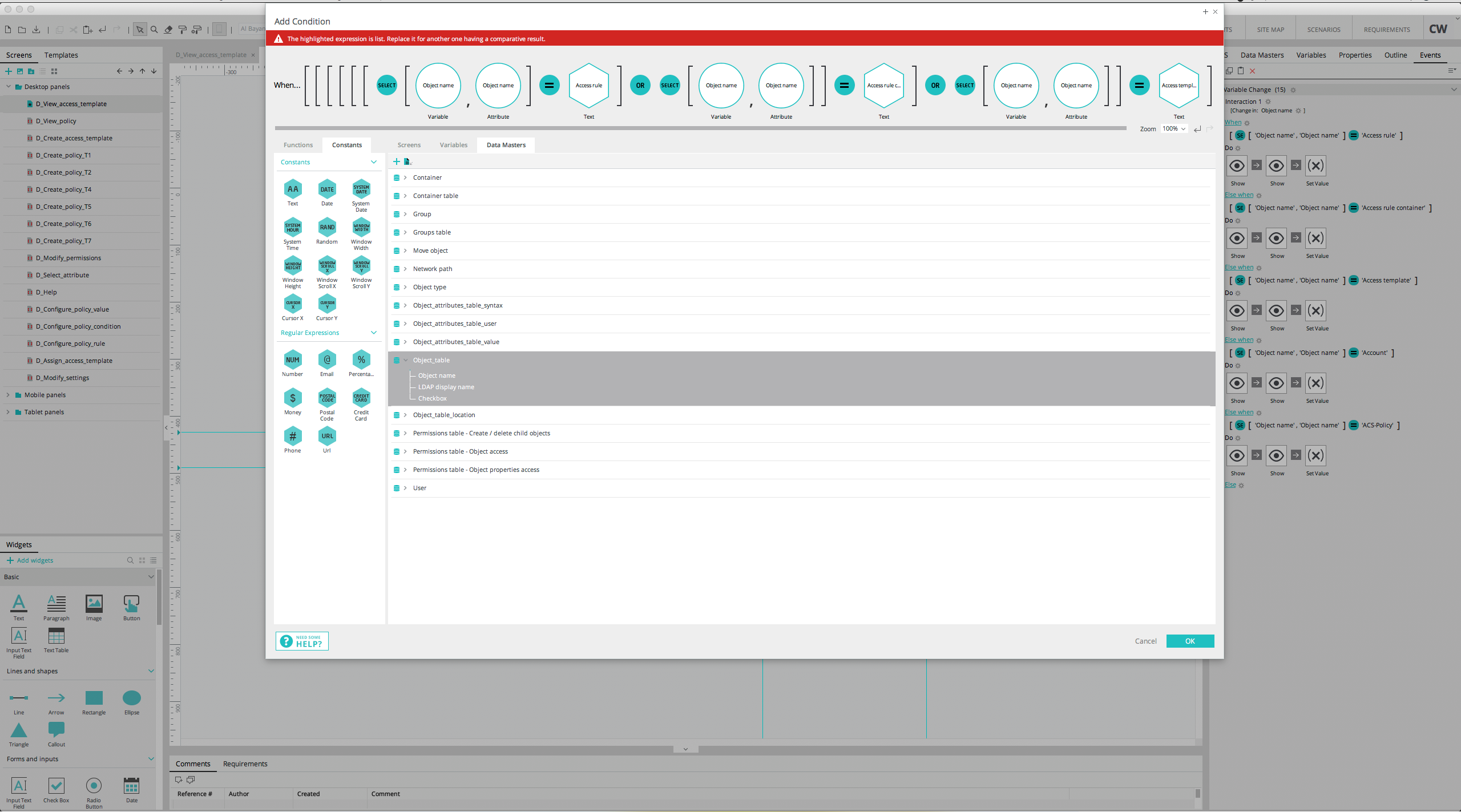

I tried to simulate this by adding OR into the condition but it didn't work. :-(

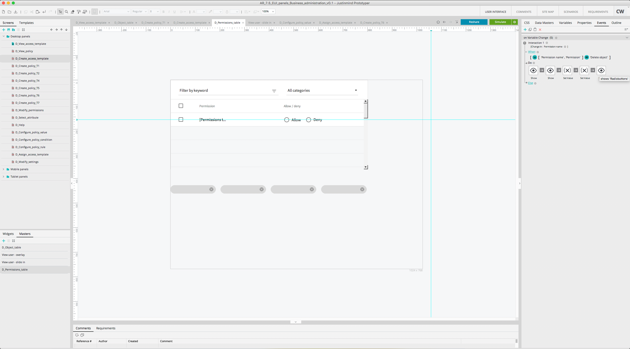

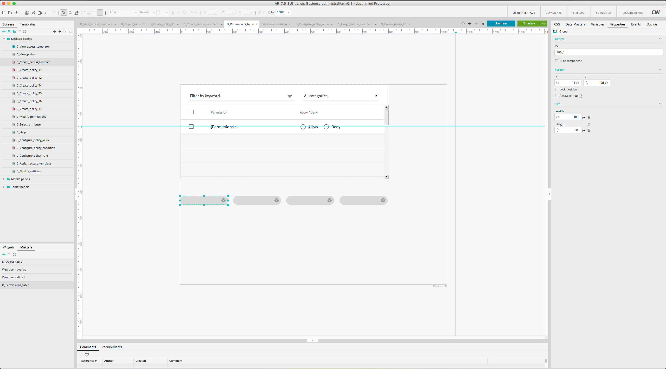

Also - I have a data master which I'm trying to do something slightly different with. In this scenario, same as before, I want the checkbox to display a chip below the table - but also to display two radio buttons in the Allow/Deny column. Allow is selected by default. So on selection of permission - permission is allowed or denied. The radio buttons should be interactive too. I added a show action to the On Variable change event as in the previous example to display the radio buttons but it displayed them for all rows.
Depending on how many rows you have in the Data Master, it might actually just be easier to create a regular table instead of a Data List. You'll need to create a pretty complex condition to address all of the possibilities. Instead, your condition could check to see if the checkboxes ticks are visible.
