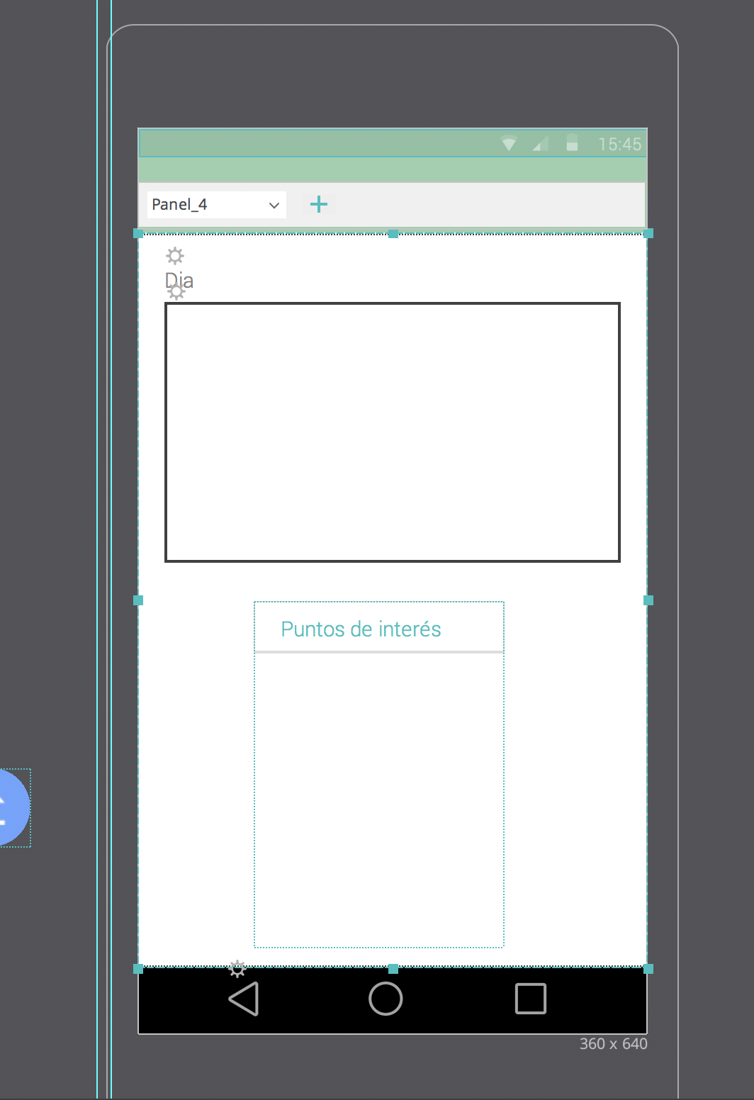

I am a little bit confuse about how to add many elements in a Screen.
I want to make a form or something similar, but I can put all the fields in one simple screen, I want to scroll it down and to continue adding fields or widgets. How can I do that?

In re-reading your question and looking at your attached screenshot, it is possible I might have misread your question.
In your screenshot, I see that you already have a dynamic panel that contains some elements. So, maybe you are simply asking how to add additional elements to your dynamic panel and have them visible in the Justinmind UI. The problem being: How do you accurately position elements within a dynamic panel that you want positioned below the bottom boundary of the panel if they disappear from view in the Justinmind UI as soon as you move them below the panel's bottom boundary?
I started to type out a long-winded solution involving positioning the additional elements mathematically (adding pixels), but stopped when I realized there is a much easier way. Just increase the height of your dynamic panel temporarily to be deep enough to include all of the fields you are going to add. That way, they will not disappear from view in the Justinmind UI when you are positioning them. Then, once everything is positioned properly, reset the height of the dynamic panel to the desired height.
If my first post doesn't address your question, hopefully this one does.

Thank you so much, I understand it now with the second one!
