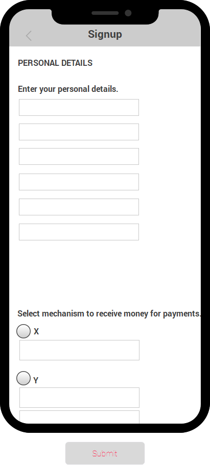

I would like to be able to scroll content, such that when it reaches the template at the top (the template is a simple rectangle widget), then content should go behind the template and not remain visible. At present, it scrolls just fine, but remains visible on top of the template.
Please note, I am not using Dynamic Panels, so this is just a screen scroll. I tried selecting 'Always on Top' for the template, but that did not help.

Select the Rectangle and look to the Properties palette. Then click the 'Display pin position' options box, and change the 'Y' parameter to 'Pin to top'.
Thank you, Danielle.
That is exactly what I already have. The Rectangle's Position Properties are as follows: X: Pin to center, Y: Pin to top. My text on the top 'Sign up' is also pinned to the top, and so is the back button.
So, something else is required. What else should I be doing, to get the scrolled content to scroll behind the rectangle.
Thank you for your assistance.
Thanks for clarifying. In that case, you could create an "On Scroll" + Hide" event, hiding the Rectangle. Then, create a Condition for this event that is When... Windows Scroll Y < 50 (or whatever number the scroll is when you would like to hide the Rectangle). Then, in the Events palette, click the 'Else' text and create an "On Scroll" + "Show" event, showing the Rectangle. There's no need to create a condition for this event. Does that accomplish what you're looking for?
