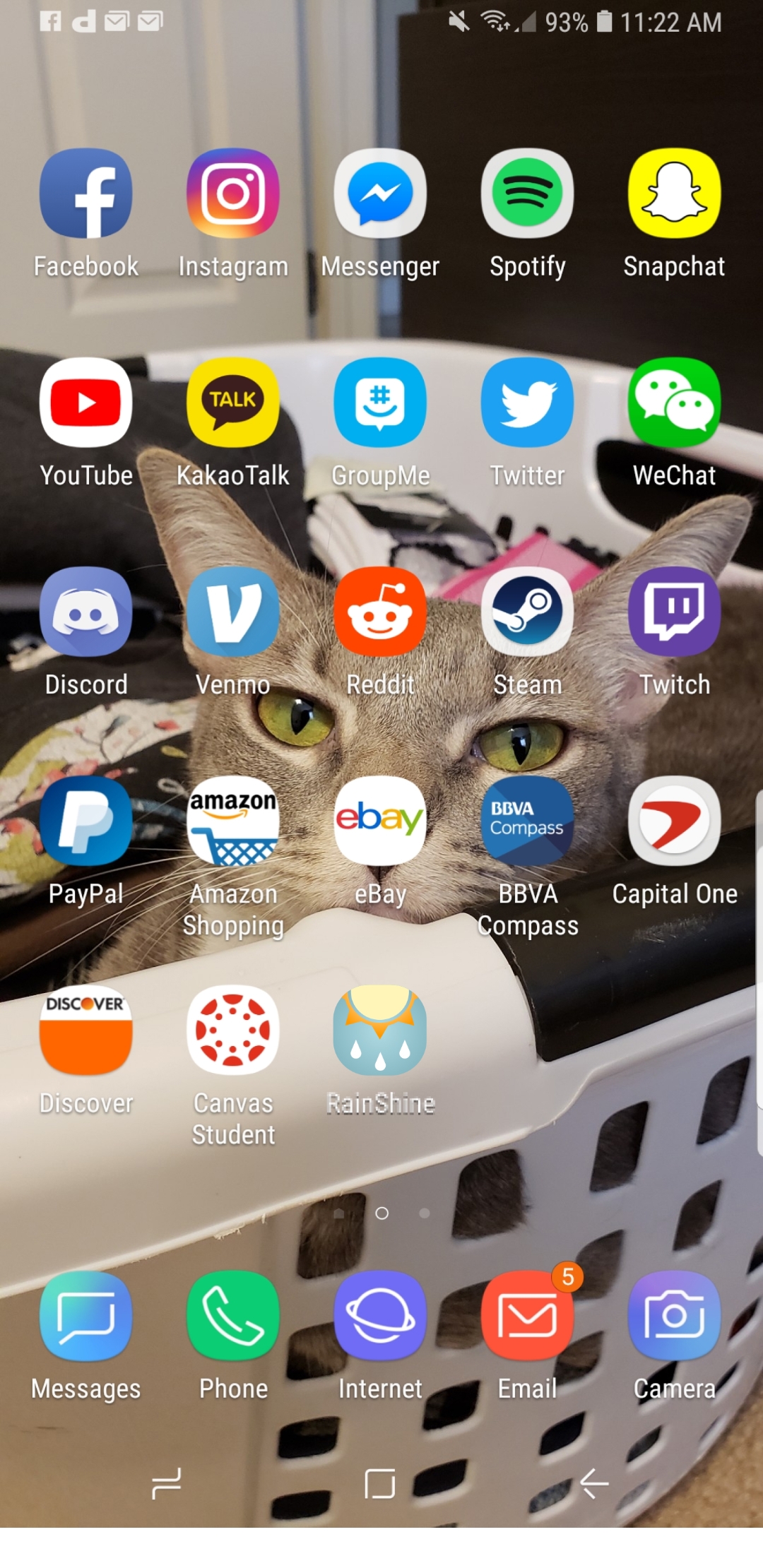

Fit to screen kind of resolved the issue, however, there is still a small white bar at the bottom of the mobile simulation. If you look at the attached screenshot of me putting in a phone screen shot into the prototype, you can see the white bar. Is there a way to fix this? I have the screen size set to 360x720px with the fit to screen settings turned on in simulation.
Never mind, my mistake, the screen should be 360 x 740 px, not 720. Fixed the issue! Thanks!
