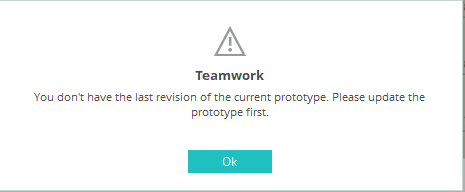

When I try to commit my prototype with the function "Teamwork - Commit all" I get the error message : "You don't have the last revision of the current prototype. Please update the prototype first".

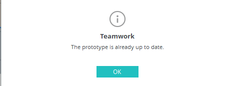

So I try to update the prototype by using the function "Teamwork - update all", and then I get the message "The prototype is already up to date".
So it looks like I am in a dead end: I cannot commit my prototype because it's not up to date but I cannot update my prototype because it's already up to date. On top of all of this, I cannot close the application because I have changes in my prototype which are not committed. So I'm force to kill the application with CTRL-ALT-DEL. This is really annoying.
