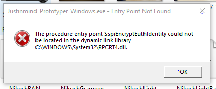

Hi everyone,
When I try to install the app in my windows following error message is showed. (please see attached screenshot).
Sezanur Rahman
It seems that this is a problem that occurs after downgrading from Windows 10 to Windows 7. See this thread: https://answers.microsoft.com/en-us/windows/forum/windows_7-start/rpcimpersonateclientcontainer-could-not-be-located/2ce5ab1f-4414-495c-9689-8cbf1bbb7cc5
No, I'm using licensed windows 10 and in the system32 folder, RPCRT4.dll file was not missing. I already read this link which you provided. By the way, after removing the firewall and disable virus protection I'm able to install this software. Thanks for your help.
