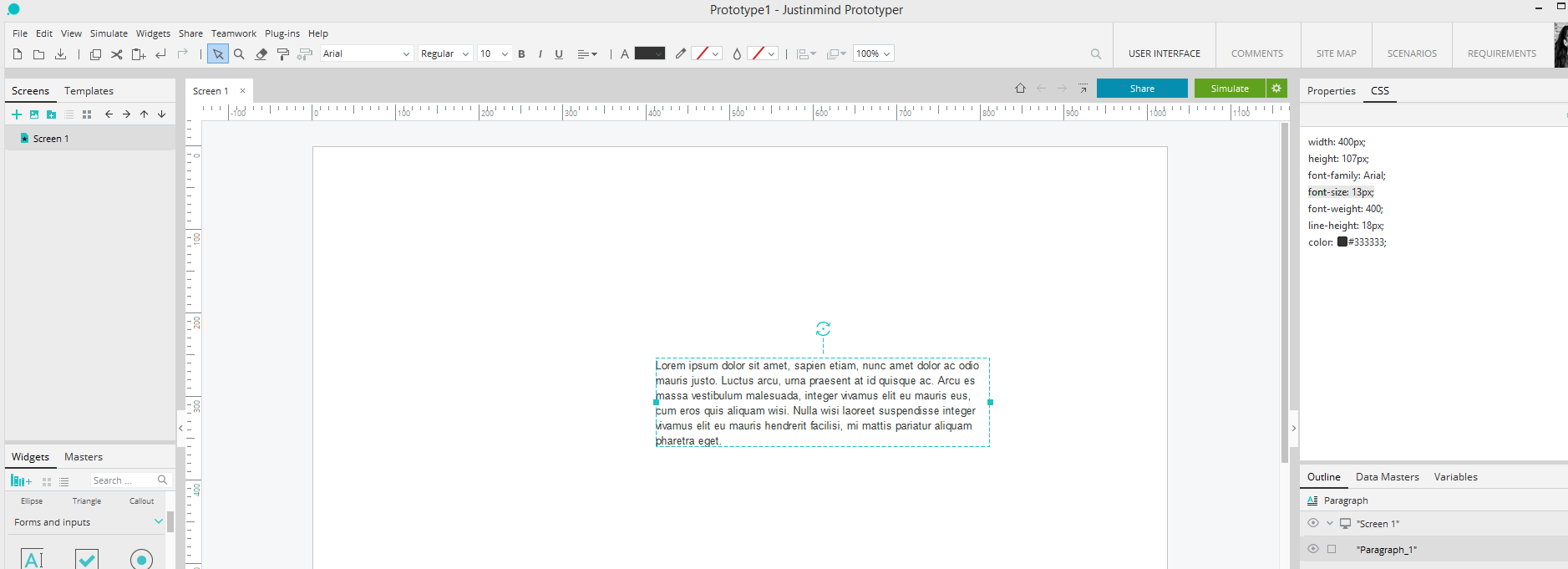

Dear Malgorzata,
This is something our development team is investigating and trying to solve since a long time ago. Working with pixels instead of points it's a quite complicated development because the fonts are used differently between devices and OS. Meanwhile, since our last update, you will be able to visualize the equivalence in pixels through the CSS palette. See the screenshot attached.
I hope this helps.
You can now change font size to px in the newest version of Justinmind.
