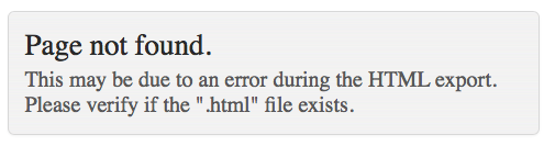

Page not found. This may be due to an error during the HTML export. Please verify if the ".html
Answered Victor Conesa 11 years ago
When I try to start my published prototype, I get a message: "Page not found. This may be due to an error during the HTML export. Please verify if the ".html" file exists." What's the problem? Please, help to solve my problem.
Check out this article for solutions.

Hi have the same problem and I don't use shadows
I can't simulate any of my files (including pass files) help

I have the latest (8.3.1) version and I'm still getting this Safari error - Page not found. For a Mac-based app not to be compatible with the Mac browser seems a bit of a fundamental issue to me!

Page not found in Safari using JIM version 8.5.0. With the update did they not carry over the fix for Safari? Was there a fix in Safari for this issue? Works fine in Chrome but not Safari.
This is an issue with Safari that we can't fix. However, we have two possible workarounds:
Workaround 1
-Go to Safari Preferences / Advanced / Check the option "Show Develop menu in menu bar"
-Then click on "Develop" menu (Safari) and activate the option "Disable Cross-Origin Restrictions".
Workaround 2
-You can upload and visualize your prototypes through your Justinmind online account: www.justinmind.com/usernote
Alternatively, you can change your simulation browser by going to preferences -> default browser -> choose another browser application.
I can't tell the user to do this workaround when viewing my prototypes. I shouldn't have to give directions if viewing in Safari or advise them to view my prototypes only in Chrome. I do have an account where I link to it but I can't always do that. Also will JIM allow me to have an account without having to paying the annual fee of $228 for the software? I want to link to my prototypes but do not want to continue with JIM subscription of $228/year.
We understand that this isn't ideal. Unfortunately it's a fundamental issue with Safari's permissions that we can't change. Regarding pricing and account questions, you can contact our licensing team here and they can help you with this.
I still experience this issue. None of my browsers work (I've checked Chrome, FireFox & Safari). I've tried to export both from the app and from the site :(

I see this when I try to open my exported html prototype. The published and simulated versions work correctly.
