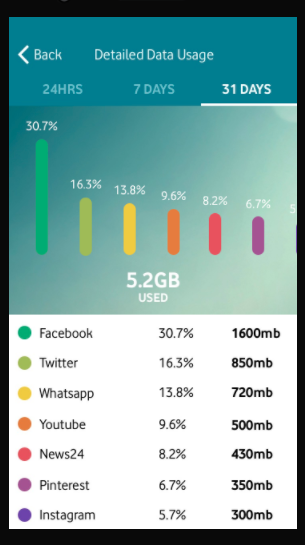

I am busy creating a prototype that uses horizontal and vertical dragging but whenever one of them is clicked, it moves on top of everything else.
The vertical drag is a panel that needs to move under the panel above it but it always moves to the top when dragged.
Is there a workaround for this?
Dear Sean,
Can you attach an example of what you're looking for and what this looks like so we can assist you more helpfully?
I have attached a screenshot of my current prototype.
The graph at the top scroll horizontally and I would like the list at the bottom to scroll vertically but it needs to go underneath the content above it instead of always jumping to the top.
