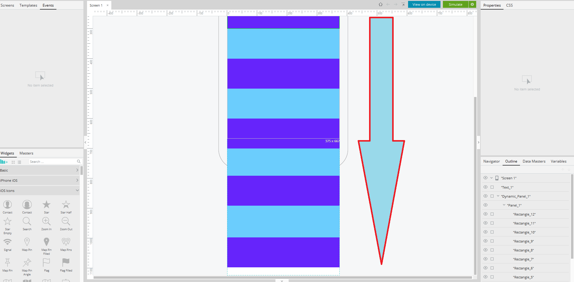

Dear Michael,
Make sure the dynamic panel has a longer surface and it will work.
See the screenshot and the example attached.
