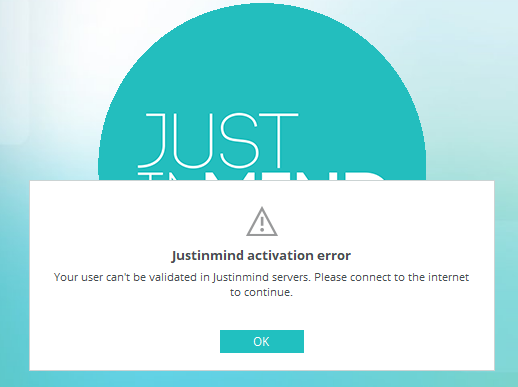

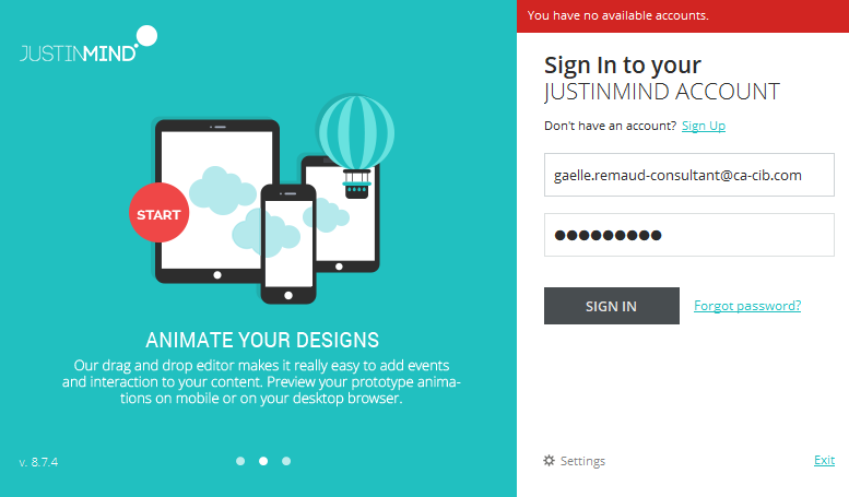

I just installed the free version and try to login but it keep saying no available account even I managed to update my password. Please help.
Can you attach a screenshot of the error message?
Also, where/how did you update your password?

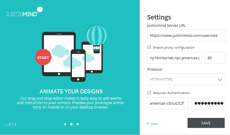

Can you take a screenshot of the Settings? Click the 'Settings' text in the login window.
Sure, here it is!

  1. Remove the proxy information from your settings and try to sign in again.
