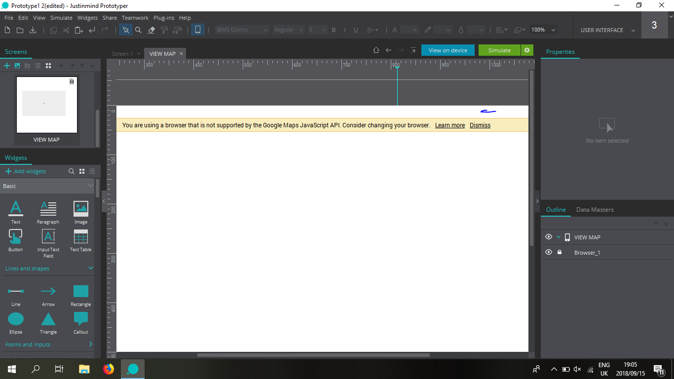

hi there this error message appears in the window where the map is supposed to be, it works perfectly in a simulation any idea how this problem can be fixed? thanks in advance
What browser are you using to simulate Justinmind?
My default browser is firefox so I assume it's that
The issue is that the Windows version always uses native browser (IE) to render web sites inside Justinmind app, but Google has made some changes to rendering maps with IE, which is why this message appears. As a workaround, you can write the following text before the iframe tag and it should work:
<meta http-equiv="X-UA-Compatible" content="IE=edge" />
