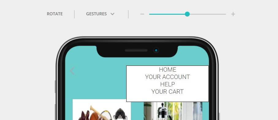

Hi. I have been linking different terms in the menu to their respective pages in my prototype. For example, 'home' should go to the home page. However, when I try to link both home and your cart to their respective pages, for some reason, both will go to (once clicked on in simulation mode) to whichever page I happened to link to last. For example, If I happened to link 'home' to the home page last out of linking menu terms to all of their respective pages, all other previously menu terms (that I've linked to their respective pages) will all go to the home page once clicked in simulation mode. The link to the home page has been overridden by every other link in the menu. Please see attachment if this helps at all. Thanks

The issue is that the menu is made of a List Box element, rather than individual elements like Rectangles. So when you click on any value in the List Box, it will link only to one screen. You could create conditions and different events to determine which value is selected in the List Box, but it's not necessary in this case. Instead, it would be easiest just to change the menu to individual rectangles, and then link each of those rectangles to different screens. You can group all the rectangles together (select them all, then Command/Control G) in order to show/hide them all at once when you click the burger menu icon.
