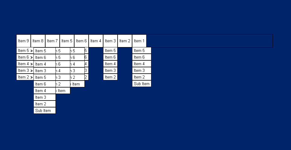

Hi, I'm working on a simple web page, with a menu with multiple vertical submenus.
On the design screen, this works wonderfully.
But, when I use Simulate, or export as html, this really works badly. The default "mouse Over" event does not correctly capture my pointer.
Some SubMenu, do not collapse when removing the pointer from above, accumulating with others.
In addition, some MenuItems within the submenu, are not accessible.

One more case to add to your fix.
When the menu is in a Dynamic panel to simulate a sticky menu, sub-menus are not displayed over the Dynamic panel. All along the Dynamic panel they are hidden under it! Only appear the remaining sub-menus below the Dynamic panel if there are more sub-menus than the height of the Dynamic panel.
In this example, the 1st menu above "Persons" is not displayed, it's under the Dynamic panel, even if you tick "Always on top"...
