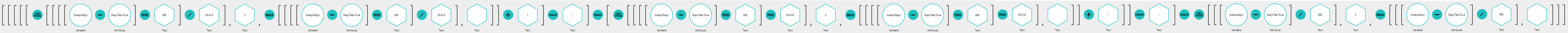

So I tried to use this technique to do math on dates and though I solved it, it was DAMN HARD!!! In order to use this technique you must use a Math.Floor and Math.Ceil functions. Since I didn't have those I used the substring routine to strip off numbers past the decimal point, which works fine so long as your calculations HAVE a decimal point. Essentially here's how I solved it:
For this example, tD = todaysDays (i.e. number of days to today) and sD = subtracted days because I was calculating days in the past from today
1.) Calculate number of days to today: todaysDays(tD) = (month-1*avg number of days in a month)+day+(year*days in a year)
tD should be Math.Floor((substr(systemDate,0,2)*30.416)+(substr(systemDate,3,5)+(substr(systemDate,6,11)*'365'))) but instead we round it:
tD = round((((substr(systemDate,0,2)-'1')*'30.416')+(substr(systemDate,3,5)+(substr(systemDate,6,11)*'365')),'0')
2. Structure the data: (MonthCalc) concat "/" concat (DateCalc) concat "/" concat (YearCalc)
3. Calculate MonthCalc: Math.Floor( ( ( todaysDate - subtractDate modulus daysInAYear ) / avgDaysPerMonth )) + 1 (all month math performed zero based and added 1 to make it read correctly)
MonthCalc = (substr((((tD-sD) mod '356') / '30.416'), 0, index((((tD-sD) mod '365') / '30.416' ), '.')) + 1)
4. Calculate DateCalc: DateCalc = Math.Floor ( ( ( ( todaysDate - subtractDate )modulus daysInAYear ) modulus avgDaysPerMonth)) + 1 (compensation for lack of Math.Ceil function to round us up)
DateCalc = (substr((((tD-sD)mod '365')mod '30.416'), 0, index((((tD-sD)mod '365')mod '30.416'),'.'))+1)
5. Calculate YearCalc: YearCalc = Math.Floor( ( todaysDate - subtractDate) / daysInAYear)
YearCalc = substr(((tD-sD)/365),0,index(((tD-sD)/365),'.')))
If you put it all together it looks like the attached screenshot (note my variable name for subtractDate is DaysPastDue) I tried to include it here but it's microscopic as you can see. That's all of the nodes needed to calculate 1 date subtraction. Can we maybe have a better way? PLEASE????

Hi Nate,
Not sure if you were posting your response for those who continue to search for a solution to this problem, as the OP is five years old, but there is a date arithmetic prototype posted in response to a question from about 3 months ago here:
https://www.justinmind.com/community/topic/setting-dates-relative-to-other-dates
Hope you find it useful. Cheers!
