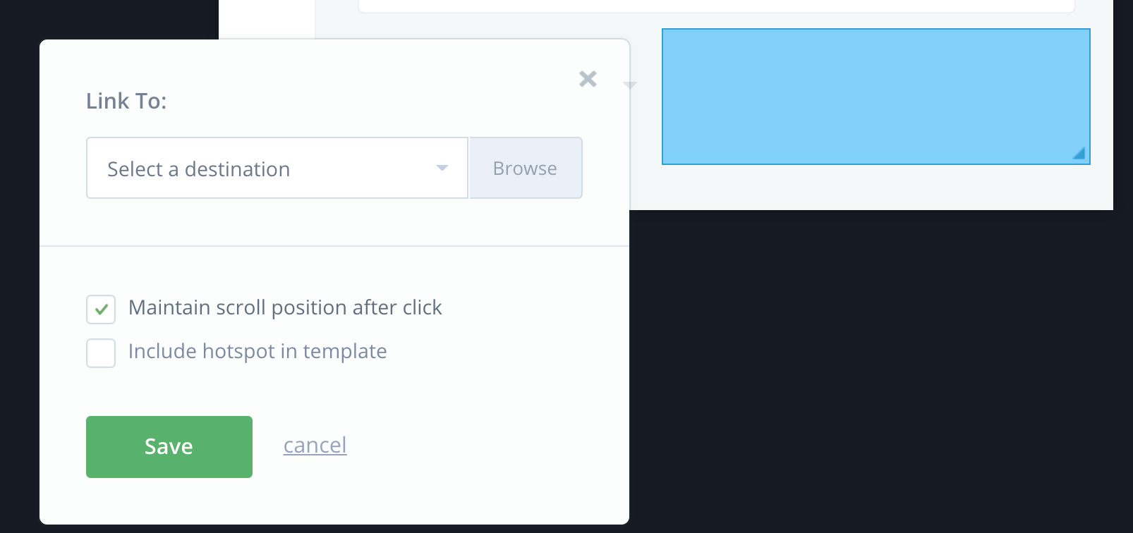

I want to know if there is a way to keep the scroll position when clicking through the screens?
For example, Invision app have this functionality where you can keep the scroll position so the screen doesn't move when clicked on next page. See attached image.

Sure - check out the attached prototype to see how.
Hi Danielle,
Thanks for your solution, however its not exactly what I'm after. Can you maintain the scroll position on the second screen even after scrolling down on the first screen?
